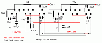

hii,
i want to build a amp with TDA7294, i have a pcb layout which i m attaching i would like to know if its ok. or do i need to do anything else,
if i keep the mute and standby pin open is it fine or do i have to attach a capacitor ,
if i have a transformer 20 0 20 @ 4.5 or 5 amps is it ok,
i would appriciate al the help i get regard the pcb,
thanks a lot guys

Hi, To be able to help you out we really need the circuit diagram with component values on and preferably the manufacturer for the CAPs.
Also the images you have attached are rather small which makes it difficult to tell what is going on.
Ideally please attach top layer, (bottom layer if present) and a seperate silk screen with reference designators. That way we can tell which components on the sch are where on your PCB circuit.
It looks like you don't have any local decoupling on the chip amp. If this is the case then this is definately a problem, this chip goes unstable into low impedances without close local decoupling of arround 22uF(You may get away with this as the bulk decoupling is close). I would also recomend 100nF very close to the chip to reduce the risk of HF oscillation.
Andrew

To operate mute and standby, you need at least a resistor.
Your transformer is fine.

thanks for the de coupling reminder, i was planning to directely solder the 100nf capacitor on the pin of the iC, my power filter capacitors are samsung-4700uf 50V, or Elna as i dont get panasonic or black gate, so i have to stick with what i get in market, i have made it with schematics from the datasheet for one IC, and the power supply has 4700 + 4700 on each rail with 100nf with each 4700uf /63v or 50 v. i was concerned with what to do with mute and standby pin if i leave it open is it ok.

Mimimum 3 parts to work standby and mute.
Mute is a normally off switch and member of the input circuit. Connect the pin to a 10k resistor.
Standby is a normally off switch and member of the power/output circuit.
Connect the pin to a 20k resistor.
Also connect the pin to a 10uF capacitor.
The opposite end of both resistors connect to V+ at the same place. This looks like "Y" connection.
The opposite (negative) end of the one 10uF cap connects to power ground at exactly the same place as the ground centerpoint that's typically in-between your onboard power caps.
Parts (about 25 cents). . .
Mute: a 10k resistor (from pin to V+ via 10k) to operate the switch.
Standby: a 20k resistor (from pin to V+ via 20k)to operate the switch and a 10uF cap (from standby pin to 0V power ground via 10uF) to interpose a minuscule delay for soft start feature and the cap is also necessary to reduce noise.
EDIT: From the official diagram provided by the manufacturer, you may omit the 10uF capacitor that was supposed to time-delay the mute feature. But, don't omit the 10uF capacitor from the standby feature. See PAGE ONE of the TDA7294 data sheet. 😉

. . .my power filter capacitors are samsung-4700uf 50V, or Elna as i dont get panasonic or black gate, so i have to stick with what i get in market, i have made it with schematics from the datasheet for one IC, and the power supply has 4700 + 4700 on each rail . . .
These large caps are great for your power supply board however. . .
For TDA7294, use 220uF//100nF at the chip pins.
You can add more capacitance after a cable run of at least 10cm or longer.

The TDA7294 will work with pins 9 and 10 floating or connected to ground. You do not need the resistors and capacitors. The drawback is that you may experience pop noises, when powering the amp up, when you don't use those components.

Something to add: Bootstrap cap = 47uF. The 22uF in the datasheet makes for lousy bass as the 22uF pictured is "perfect cap" and doesn't represent "average electrolytic" So, it would be 47uF for average electrolytic, unless your speakers are smaller than 6"

That must have had a different cause, because what you describe is exactly, what the datasheet shows. Close the switches and charge the capacitors to any voltage between 3,5 V and 40 V to unmute. Open the switches and let the capacitors discharge to below 1,5 V to mute.
Which means, my former post is wrong. You do need voltage on those pins to operate the amplifier. So, if you don't want to use the suggested components from the datasheet, because popping noises don't bother you, you need to connect the stand-by and mute pins to the positive rail. Leaving them floating or grounding them means the amplifier will be muted and in stand-by.

Now I wish to use tda7294 for woofer either mono or bridge. I am looking for best suitable circuit with minimum components.
Aditya, What do you think about attached picture ?
nice. i did find a onlie solution check out a chinese website called gorge and charle's. i found two tda7294 layouts and u can convert the page using altavista language convertor. - babel fish
the link is ---- ³ìªv¬dº¸´µ¹q¤l¹q¸ôºô check out and the pdf at the end of each article has a pcblayout which is ready for tonner transfer,
i m though making a tda7294 pcb layout for my self, you see i have put one of the designs as an attachment, on the first page of this post.
