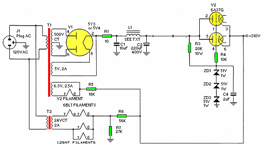

this is the circuit
I need some help in adjusting the Vout as I'm going to use the power supply schematic for another circuit.
transformer would be 250-0-250. rectifer would be 5V4g. And the desired voltage would be 150V.
I got a feeling it has something to do with the zener as 6 51V Zener is close to the +310V in the output. But can't figure out how the resistors come into place.
Thank you for the help.
analog_sa said:
The resistors play no role. Just get a combination of zeners with the approximate voltage you need.

Hi jarthel
You are on the right track.
Just remove three of the zener diodes to achieve the 150 volt output that you want. The resistors are so conservatively rated that no other changes are necessary.
Output should now be approx. 150 volts, not 310 as shown.

rpapps said:
Hi jarthel

Thanks for the help.
Is there an advantage to using 1x 150V zener VS 3x 51V zener?
Thanks very much
High voltage devices tend to produce higher levels of random noise. The addition of the noise from three lower voltage devices should give a lower total level but, in practical terms, probably not a lot of difference.
Having said that, what are you going to use it with?
