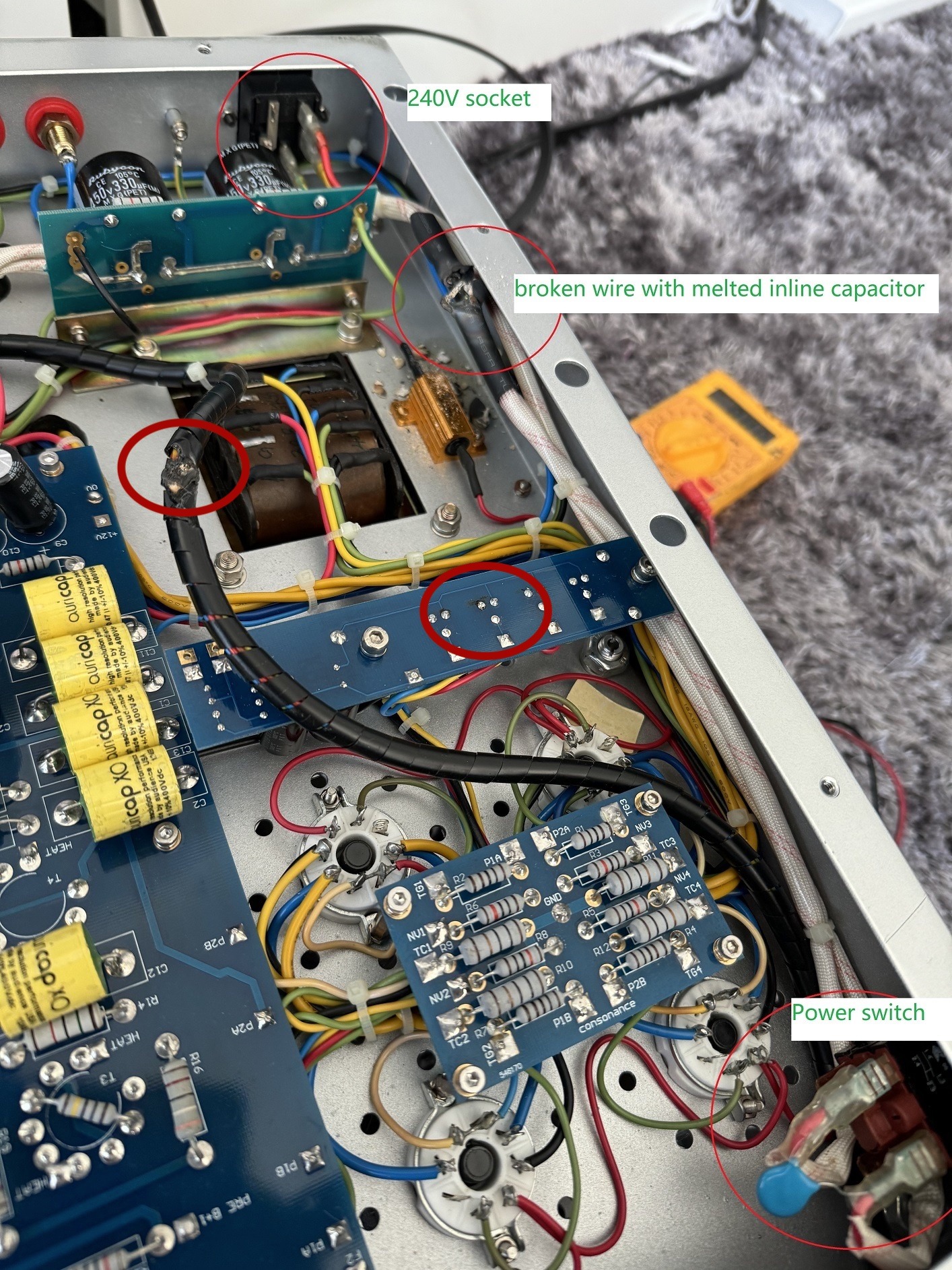

Thank you all in advance. My Consonance Cyber 880 integrated amplifier wouldn't switch on. This happened a day following 6 hours of uneventful use the evening prior. I switched it off normally. And the next day, it wouldn't power on at all. No noise, no flicker, no sign of life whatsoever.

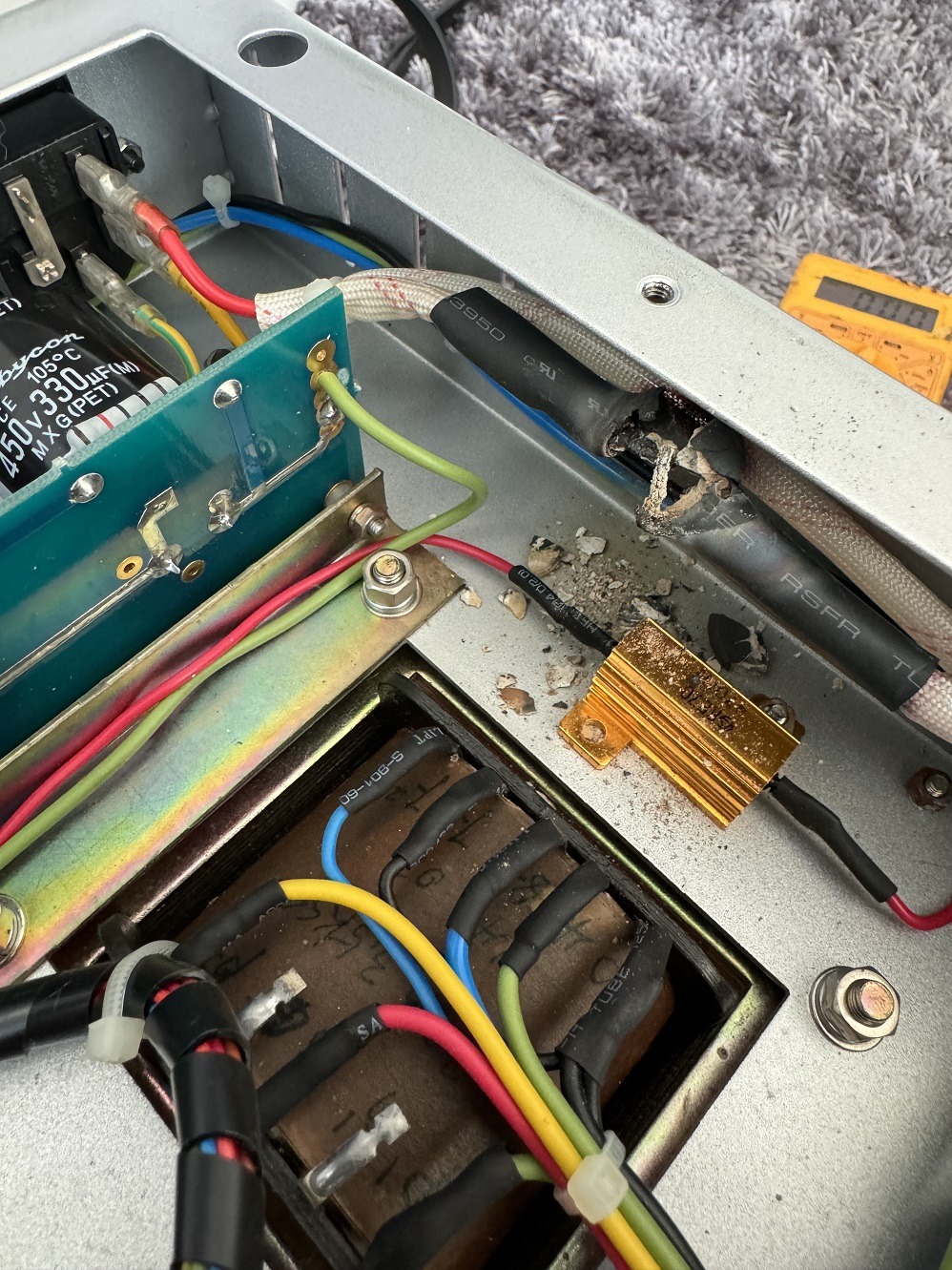

With some rudimentary diagnostic skills, I eventually uncovered the culprit: it looks like there is a capacitor mounted INLINE inside the AC wire going from the power socket to the power switch. And it has melted/disintegrated beyond recognition.
I only know it's a capacitor because it looks round, and has a sandwitch layout when viewed horizontally. Please see the photos.
My question is, without having access to the wiring diagram for the amp, what would be the likely type/capacitance/voltage value of this capacitor? And what would be its purpose? It's mounted inline after the power socket, before power even reaches the ON switch.

It looks more like an inrush limiter or NTC. They often explode if they see too high current so I'm guessing something else is broken in this amp as well. I'd look for shorted supply capacitors and failed output tubes before gently powering the amp up on a variac or dim bulb tester.
I'm not a fan of leaving components dangling off the mains like that. I can't imagine that'd pass any sort of safety standard. And what's with the chassis-mounted resistor that's mounted with one screw out of two required. That doesn't exactly scream high build quality.
Anyway. Contact Opera Audio and see what the appropriate part number is for that inrush limiter. Maybe get a schematic from them if you can.

Thermistor indeed. This thing needs a serious once or twice over and improving the reliability of certain components. I highlighted a couple of things I saw from the picture. The wire bundle is melted, the PCB is brown and means serious overheating.

Thank you all so much for the replies. I have learned something new. This is very exciting.
I have since been googling and reading up on these thermistors.
I have checked the two items you highlighted, Grataku. The charred wire bundle you pointed out was originally right next to the melted thermistor. I pulled it aside to take the photo. I've checked the wires, only charred sheath. No exposed wires. I will rewrap them with electrical tape for good measure. The blackened second thing on the PCB you circled correspond to one of the biasing pots. There are eight of them. They all measure roughly the same between the various pins - all 4k - 6k ohms, and not shorted. So hopefully those are ok.
I will now purchase a few new thermistors to try. The links that have been provided, and all the youtube videos on the subject refer to CL40/60/70/80/90 thermistors. I can get them posted to me for sure, but the local eletronics physical store here in Australia is Jaycar. They stock a range of "epoxy dip NTC thermistors".

The brown stuff on the PCB could also be flux. They're pretty clean elsewhere, though, so maybe not.

Note that the thermistor will get pretty hot (as in 169 ºC at the full rated current) so you need to put it in a place where it'll have some airflow. That's why it melted the wiring harness. I'd see about installing a short turret strip down by the power switch and putting the inrush limiter there. You could also add a little circuit board and use a heater winding to turn on a relay that shorted out the inrush limiter after it's done doing its thing. Then it'd run stone cold.

10DC20 arrived. They look just like the CL60. I soldered two of them in series and into the amplifier for an opening resistance of 20 ohms.
I turned on the amp and it came back to life! 5hrs of listening and no problem so far. Nothing melted or charred as far as I can see.
