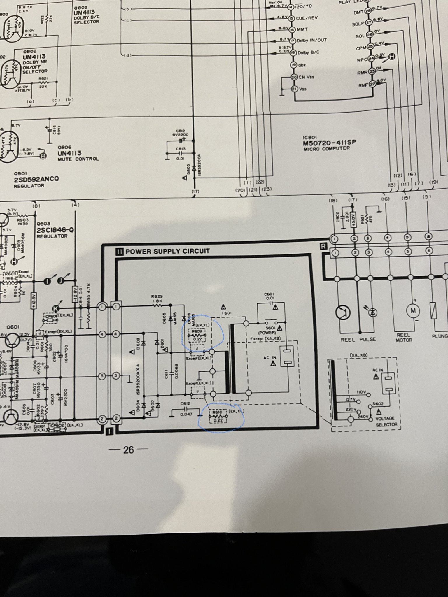

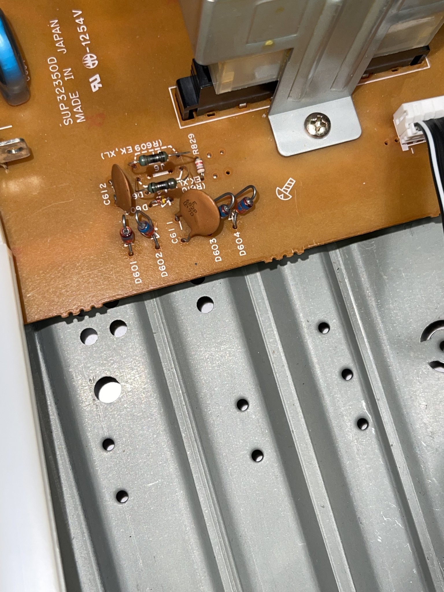

Hey guys, just for the archive. The component is indeed a fusible metal resistor with a code of ‘ERQ’ rated at 1amp 1w. The ERQ code will end in the resistance value ( in this case ‘22r’) whatever the resistance may be. So to this end I’ll stick an equivalent fuse in here.
