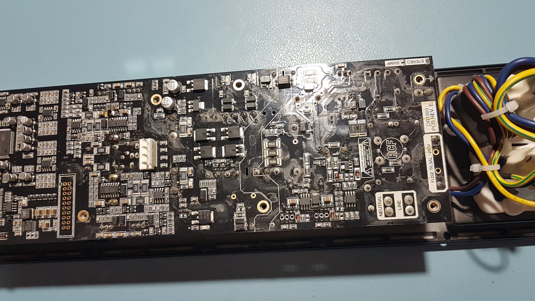

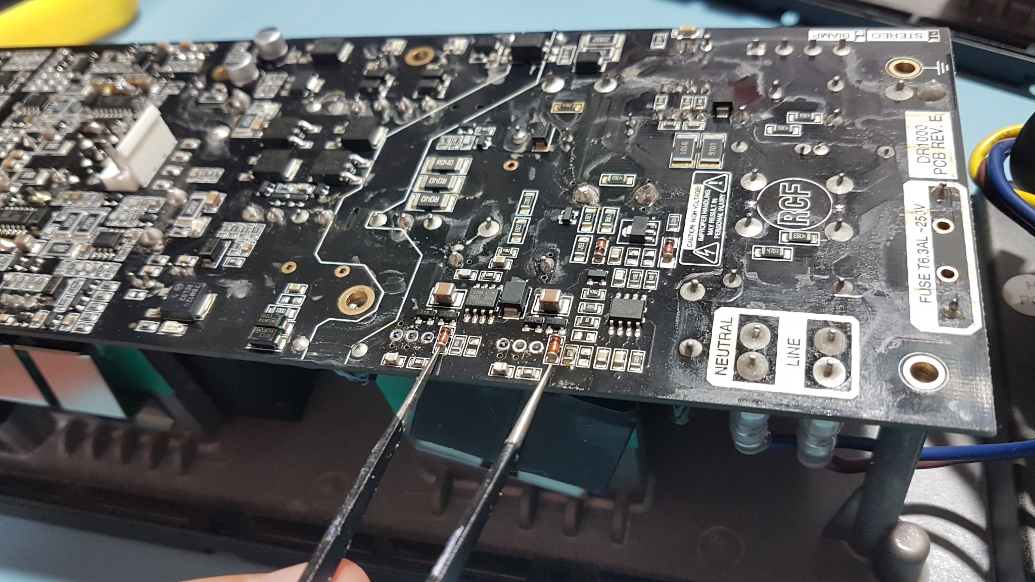

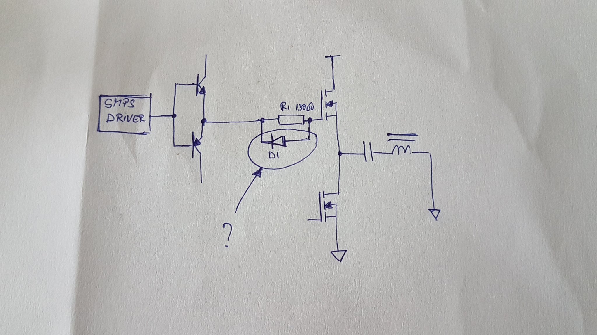

S Snowman1 Member Joined 2020 2023-07-31 2:31 pm #1 2023-07-31 2:31 pm #1 Hi guys! Please help me identify these diodes in the power supply of an RCF TT 08-A amplifier module. These diodes are part of the gate drive circuit of the power supply mosfets. Thanks in advance! Attachments 20230731_161044.jpg 415.8 KB · Views: 117 20230731_160644.jpg 486.2 KB · Views: 114 Netlist Moderator Joined 2003 Paid Member 2023-07-31 4:10 pm #2 2023-07-31 4:10 pm #2 It looks very much like a 1N4148 but without schematic it's impossible to tell. Hugo R RJM1 Member Joined 2010 2023-07-31 4:58 pm #3 2023-07-31 4:58 pm #3 gate drive circuit? could be 15V or 18V zener diodes from gate to source to protect the gate from over voltage. Reactions: Netlist S Snowman1 Member Joined 2020 2023-07-31 5:49 pm #4 2023-07-31 5:49 pm #4 I drew the affected part. I think the role of the diode is to drain the gate faster on a path with a lower impedance. Attachments 20230731_194409.jpg 327.4 KB · Views: 73 R RJM1 Member Joined 2010 2023-07-31 5:54 pm #5 2023-07-31 5:54 pm #5 !n4148 to decrease turnoff time. rayma Moderator Joined 2011 2023-07-31 6:04 pm #6 2023-07-31 6:04 pm #6 Yes, then it's a diode similar to the 1N4148 Low voltage, fast switching. S Snowman1 Member Joined 2020 2023-08-01 9:52 am #7 2023-08-01 9:52 am #7 Thank you very much everyone for your help! Kay Pirinha Member Joined 2011 2023-08-01 10:03 am #8 2023-08-01 10:03 am #8 ...but appears to be the MELF version... Best regards! You must log in or register to reply here. Share: Facebook X (Twitter) LinkedIn Reddit Pinterest Tumblr WhatsApp Email Link Home Amplifiers Power Supplies Help Identifying diodes
