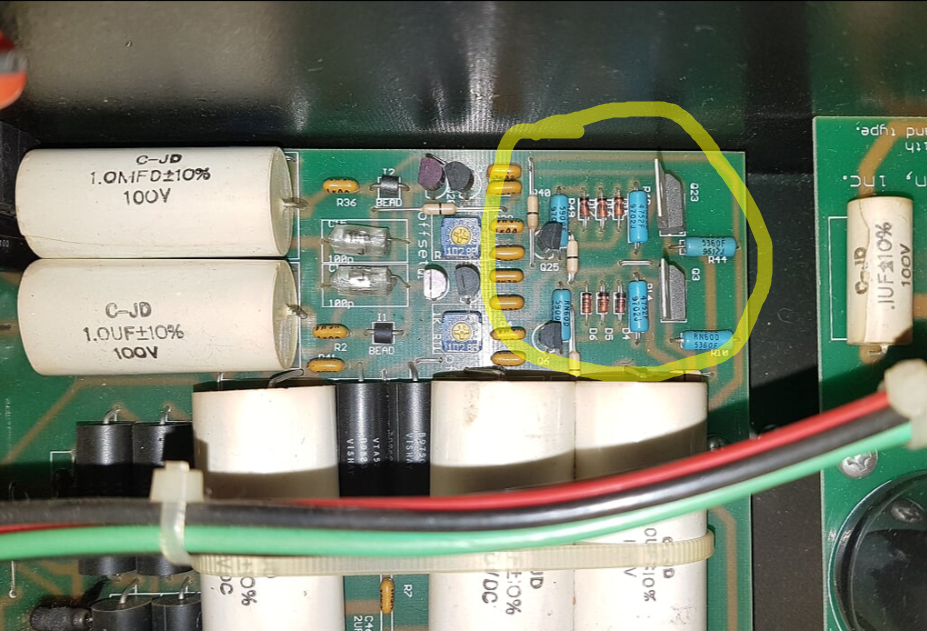

Hi

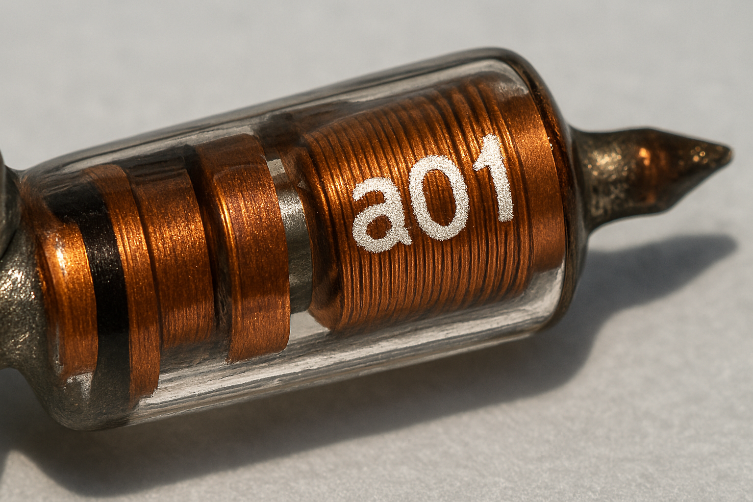

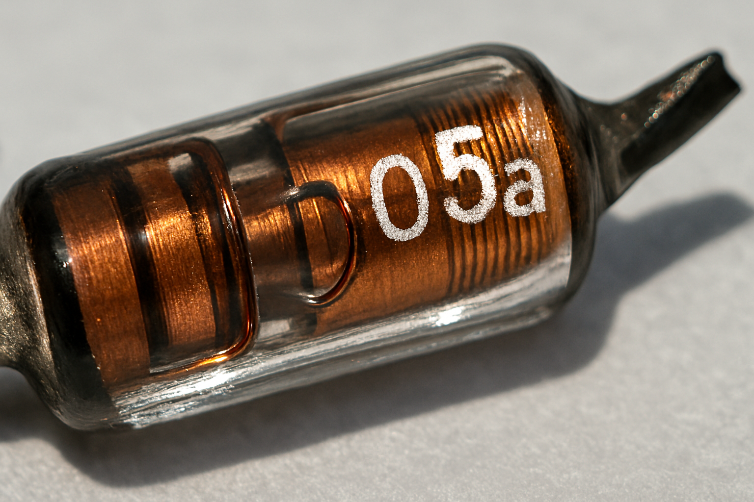

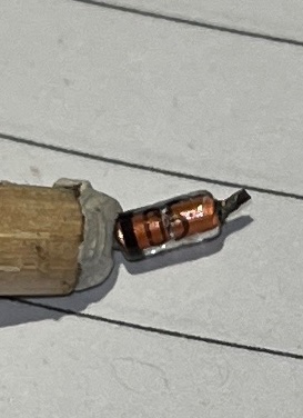

Can anyone on the forum help ID this component please ?
Please pardon the inexperience,
Markings show A01 05
Searching on the net does not give any results,
Do not have a schematic for this amp,

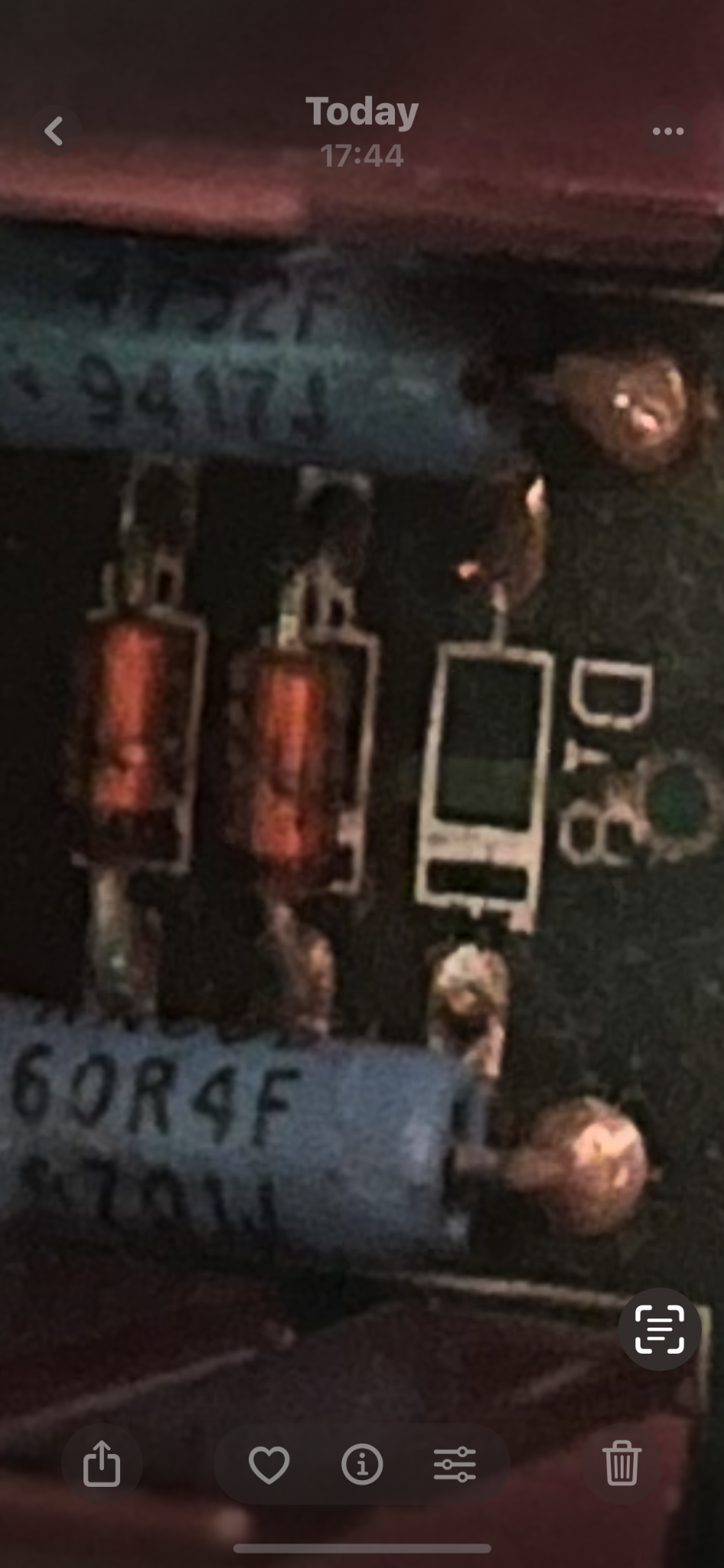

the position on the board does not specify anything except D18
I cannot test it as it is faulty
It appears to be a Zener diode,
Please see pics
Thank you very much in advance

Hmm, and you have no schematic, no name on that a amplifier?
They are in series, they are in close proximity to some power resistors, thinking of Leach amplifier, it used diodes in series to control bias.
Could also be some zener voltage drop.
Test them to see which type of diode it is. A schematic would eliminate all this guessing

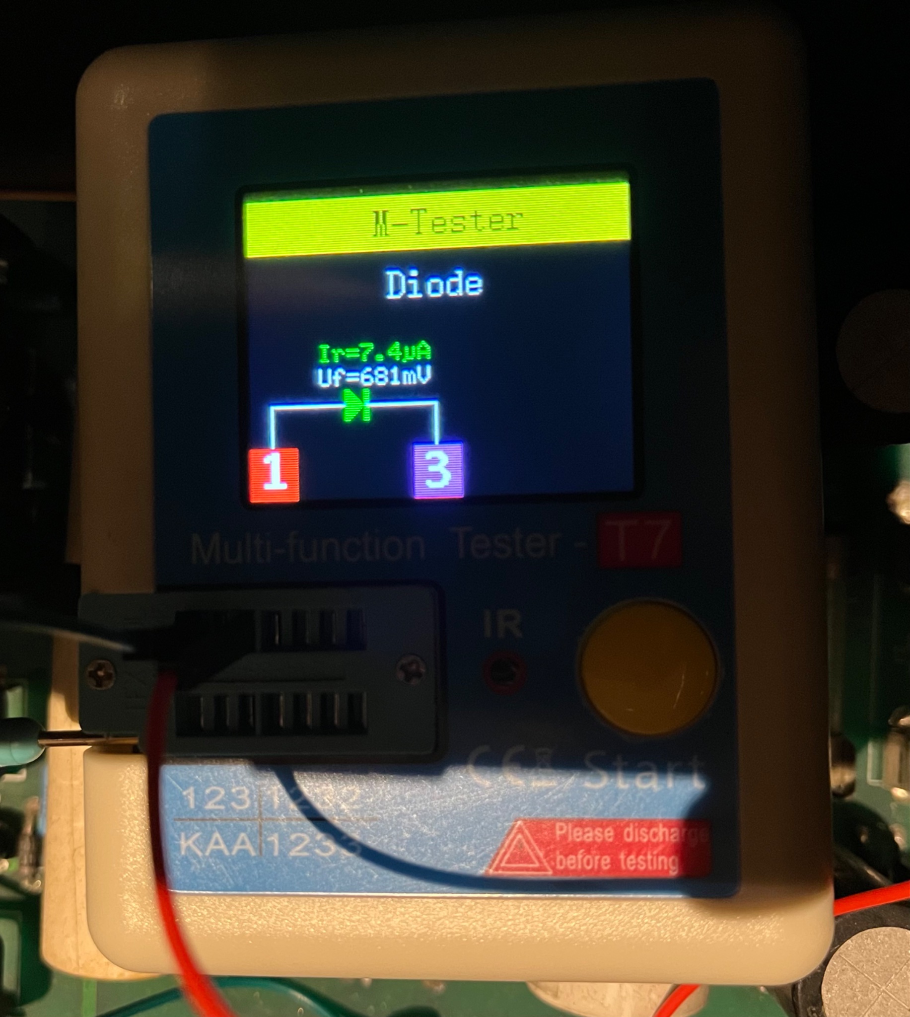

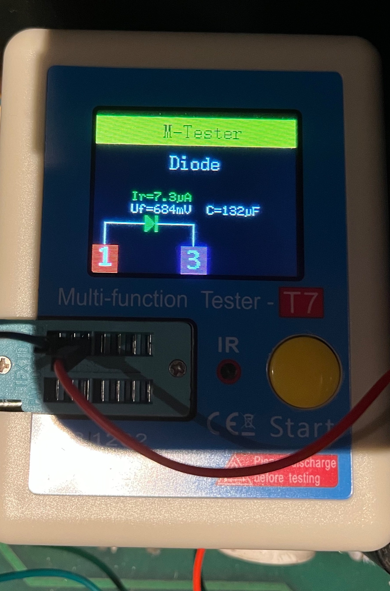

To identify which type they are, you can measure the forward voltage of a single diode using a multimeter in diode mode:
A component tester i you have, i use peak atlas, great little device
~0.2–0.3 V: Germanium
~0.6–0.7 V: Silicon
~0.4 V: Schottky
there are 3 identical ones in series.
If they really are in series then removing one isolates them... making it easy to test them.
Tag a 9 volt battery via say a 1k8 resistor across the other two as a series pair and see what the forward volt drop is.
Next reverse the polarity of the battery and tag it across just one diode and see if it behaves as a low voltage Zener or not.
