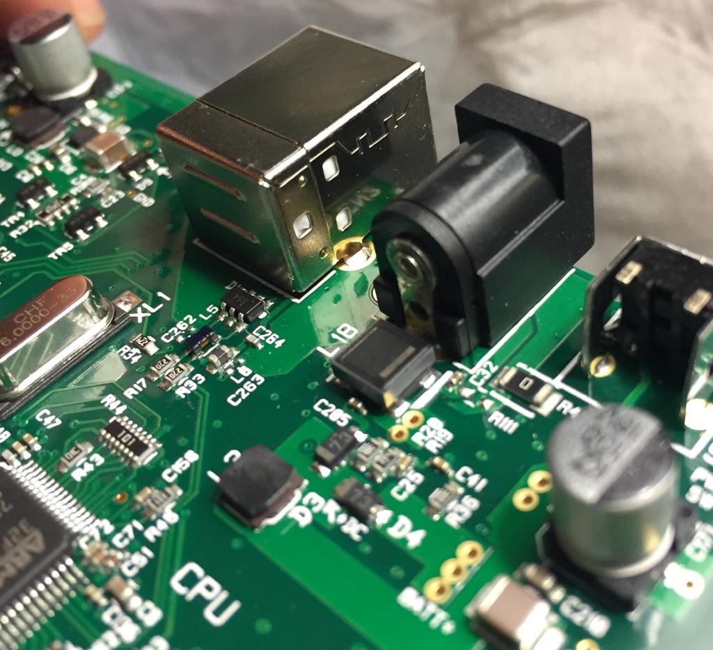

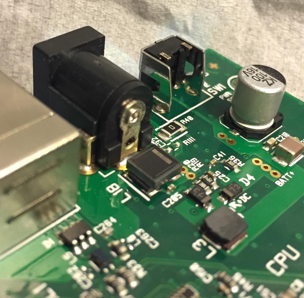

A friend of mine damaged his synthesizer by using the wrong power supply. Would anyone be able to help Identify what the black component is, where it labeled L20, next to the connector? I am hoping its a set of diodes used to protect the circuit. I dont have the circuit with me, and the photos are from the internet.

If it has four terminals (I think it does, but it is hard to see on the photo), probably a common-mode inductor, that is, two magnetically coupled inductors used for interference suppression.
L20 indicates an inductor indeed, as pointed out by #2 & #3.
If four terminals, MarcelvdG is very close.
The small cap C (?) 13 makes it a noise filter.
Measure all the terminals, one of the inductors can be broken (oddly the ground one most often!); a bridge can get things working agein.

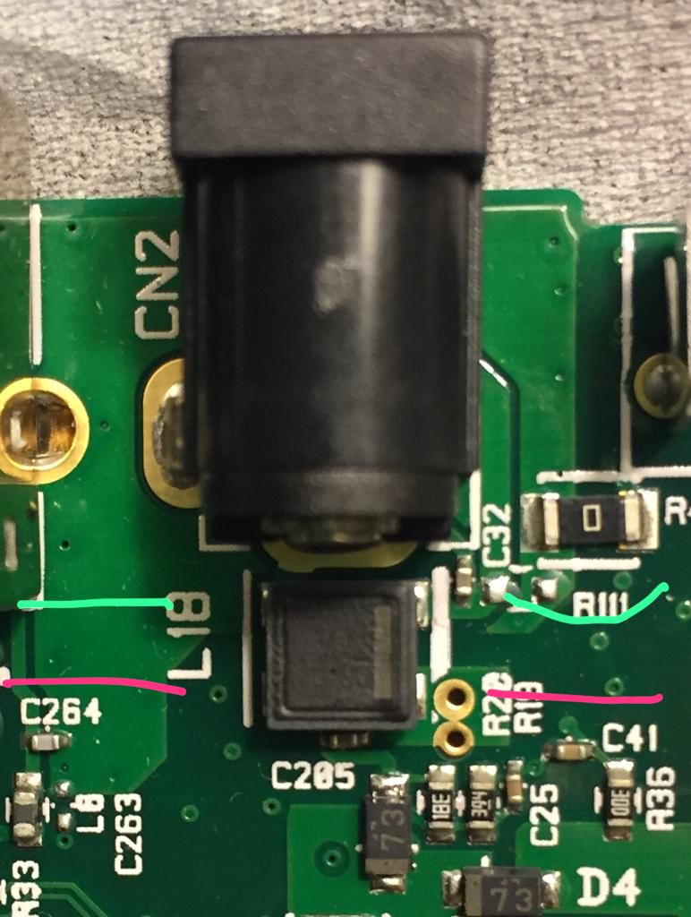

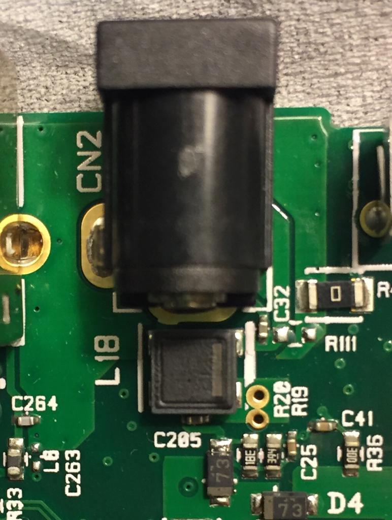

These are from his actual machine. with the meter set to 2K resistance, .280 for green to green and .025 for red to red. Green to red .268
It is an inductor, and only the right hand side pads are used from green top right to red bottom right. From there the supply is routed to elsewhere through the via's.
Hard to tell by your photo, but is this a crispy critter on the board?
Maybe just an inductor, but hard to tell on the photo.

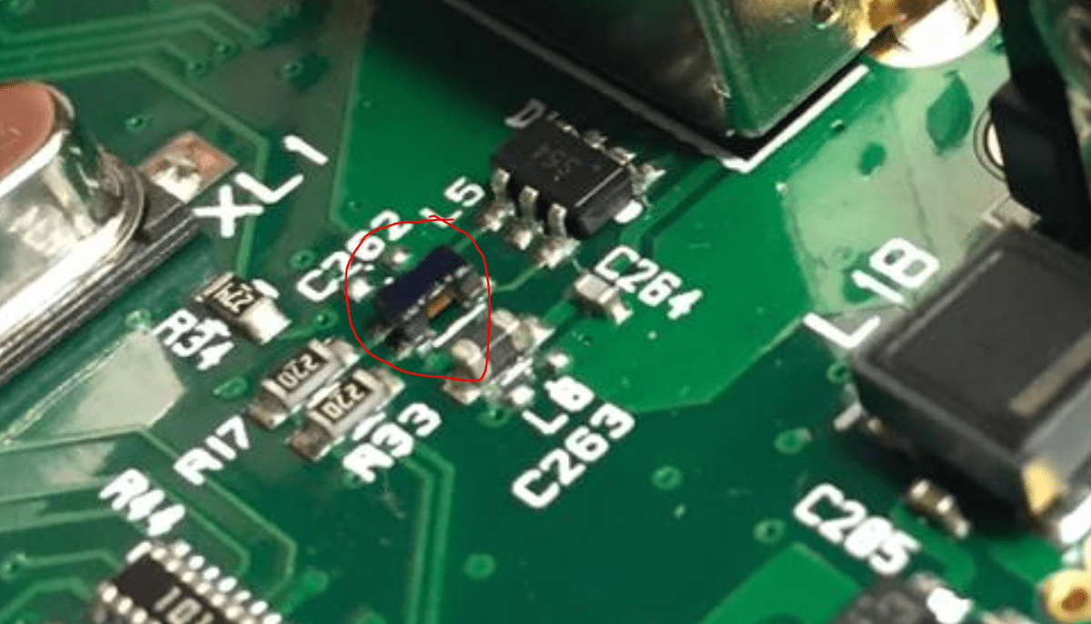

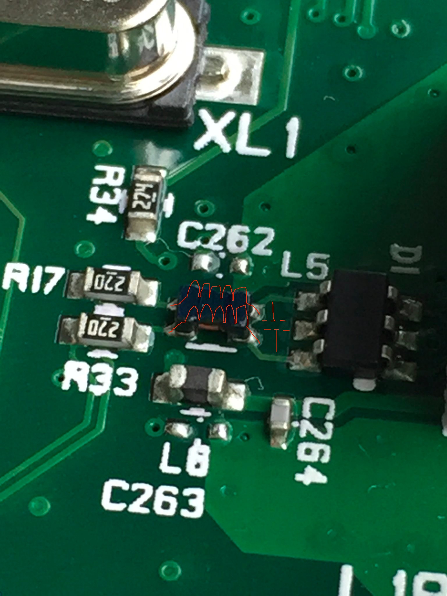

Avtech recently pointed this guy as the possible toasted one. Would you say he's roasted? (the component, I mean!). I've noticed that none of the elements in the board sport such a tan. It is tiny and very hard to accurately test with the multimeter (I need to get myself a magnifying glass!). That said, it shows continuity (the multimeter beeps when I place the probes in opposite metallic ends). What is it? a resistor? Do you think it can be replaced?

Looks to be an inductor with a black plastic coating, so it's fine.Avtech recently pointed this guy as the possible toasted one. Would you say he's roasted? (the component, I mean!). I've noticed that none of the elements in the board sport such a tan. It is tiny and very hard to accurately test with the multimeter (I need to get myself a magnifying glass!). That said, it shows continuity (the multimeter beeps when I place the probes in opposite metallic ends). What is it? a resistor? Do you think it can be replaced?

In recent years, I've repaired several pieces of equipment which had these noise supressing inductors in the supply entrance. Most often, if not all, the ground inductor broke (curious, as the currnet flowing in and out is the same!). A wire bypass brought the 1K+ ($/€) device back to life again. Unreliable and way to cheap engineerd to avoid solid but expensive emc testings.
