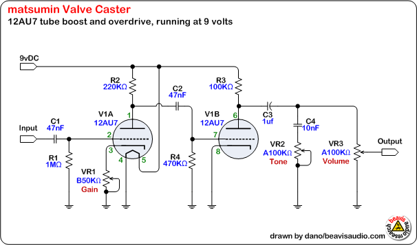

Thank you all for the replies! If the bend is the one displayed in IMG_3111 yes, it is there. Does it mean the tube is near the end of its life :) ? Concerning the audio-test, I am currently playing with a "Valvecaster" project which runs tubes in starved plate mode with 12V anodic voltage. I have indeed already tried it in my circuit (just crossing fingers and hoping not to blow out the whole house)...it works, flashes at the beginning and amplifies the signal. It has the lowest gain I have ever had in this circuit - sounds essentially clean even at "maximum gain". Sound is smooth and velvety and...well...I just love it! The only problem is I don't know the heater voltage: currently I apply 12V between pins 4 and 5, gotta see if this is OK or there's risk to burn it down. Possibly the circuit would need to be adapted a bit if this is not a twin triode but...just sounds great for clean tones!
I attach the schematics for the "Valvecaster" if anyone is interested.
Thanks again!

@revintage: the AC10 is a wonderful little beast! At the moment I'm experimenting with small booster/stompbox/whatever projects in the "starved plate" configuration. Started with the "traditional" valvecaster but I'm playing around with a friend of mine designing a crunch/boost around the ECF82 :)
