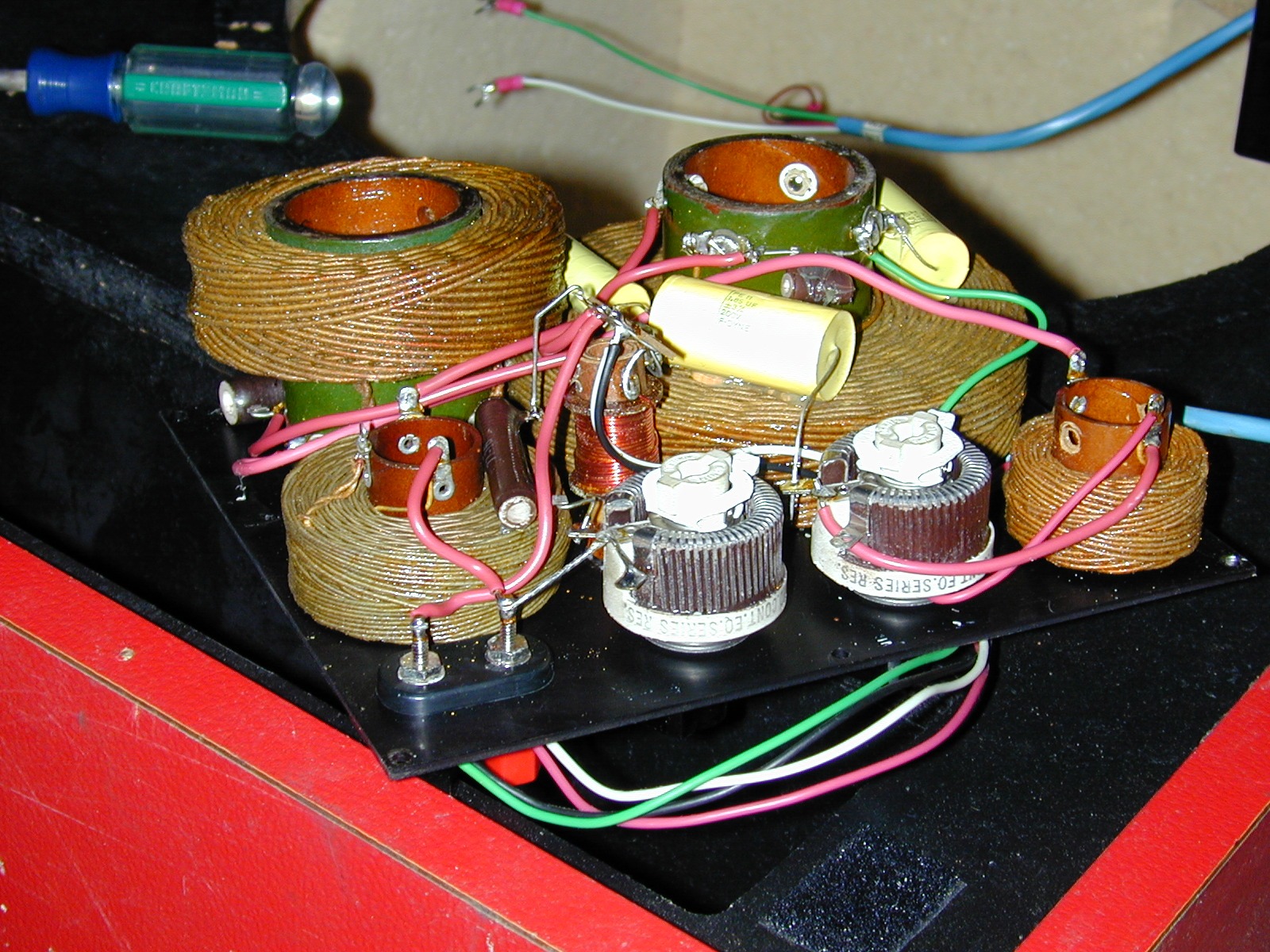

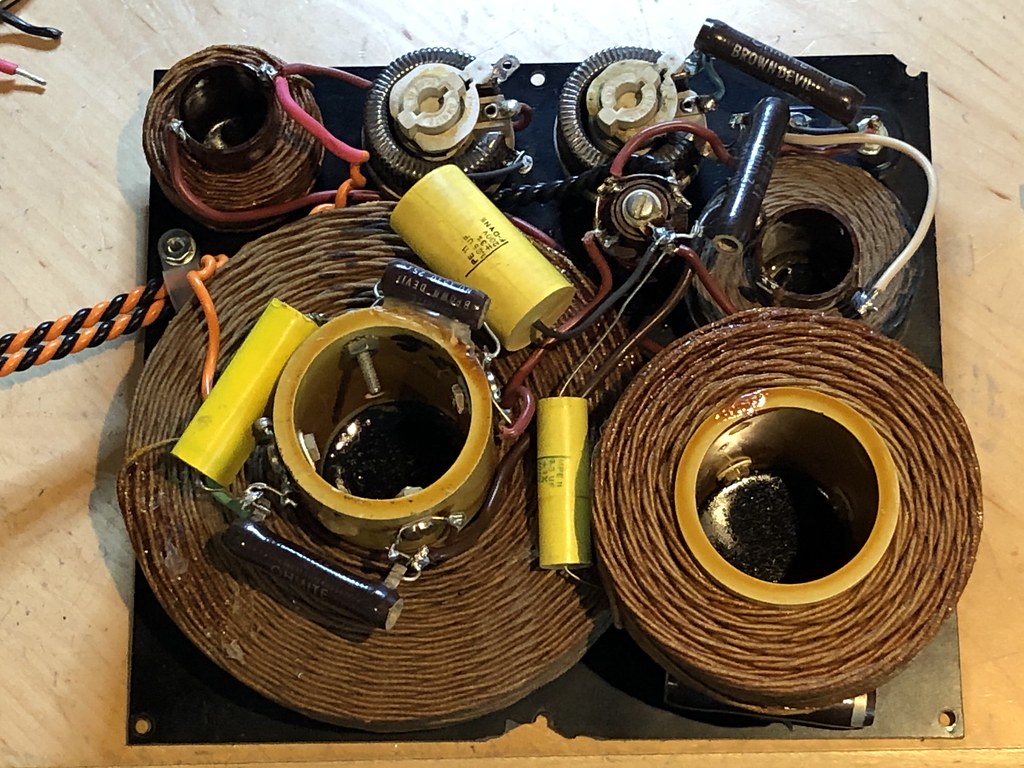

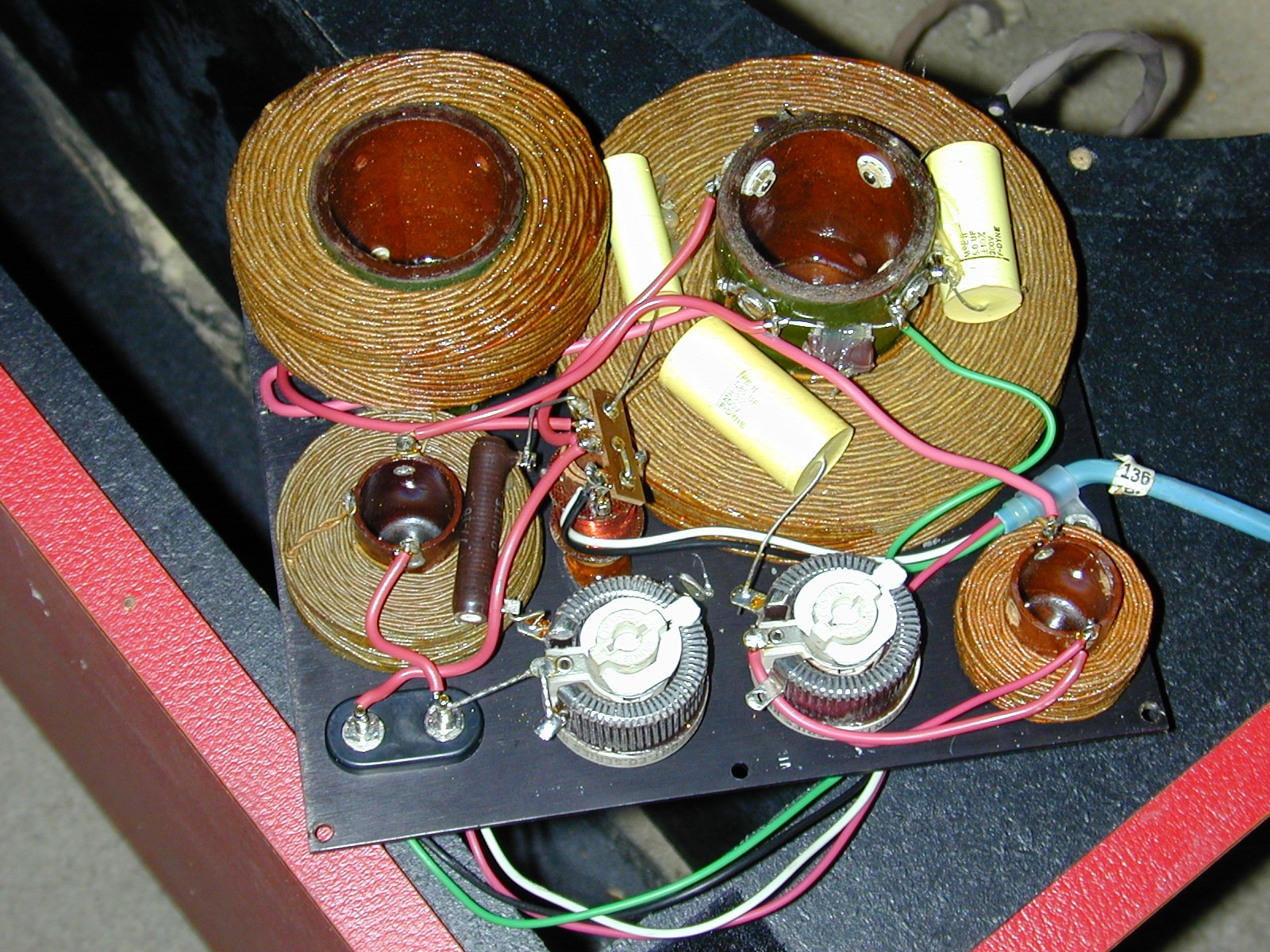

The drivers have been separated from these. This is a new build. Do you think I should put the 3.3R in before the pot that it was built without? I've seen pictures with it and without it. I assume they left it out for a reason. Mine are like the first picture.

I see. 3 of the pots are actually 10R and one is 8R. It is actually written on them and measures as well. I suppose they used the 10R pot and eliminated the 3.3R, but actually didn't have or need a 10R for the one? Probably a change in manufacturing to save a buck?
Here are a few pics of mine taken a few years ago, I will be taking them apart again this winter to upgrade caps and overall checkout. What driver/drivers are you planning to use? Keep in mind these crossovers (schematic as shown) were made for 16 ohm drivers (from what I have researched in the past few years). Mine are original strapped to the back of my Big Reds with Altec 604-16LN drivers.
