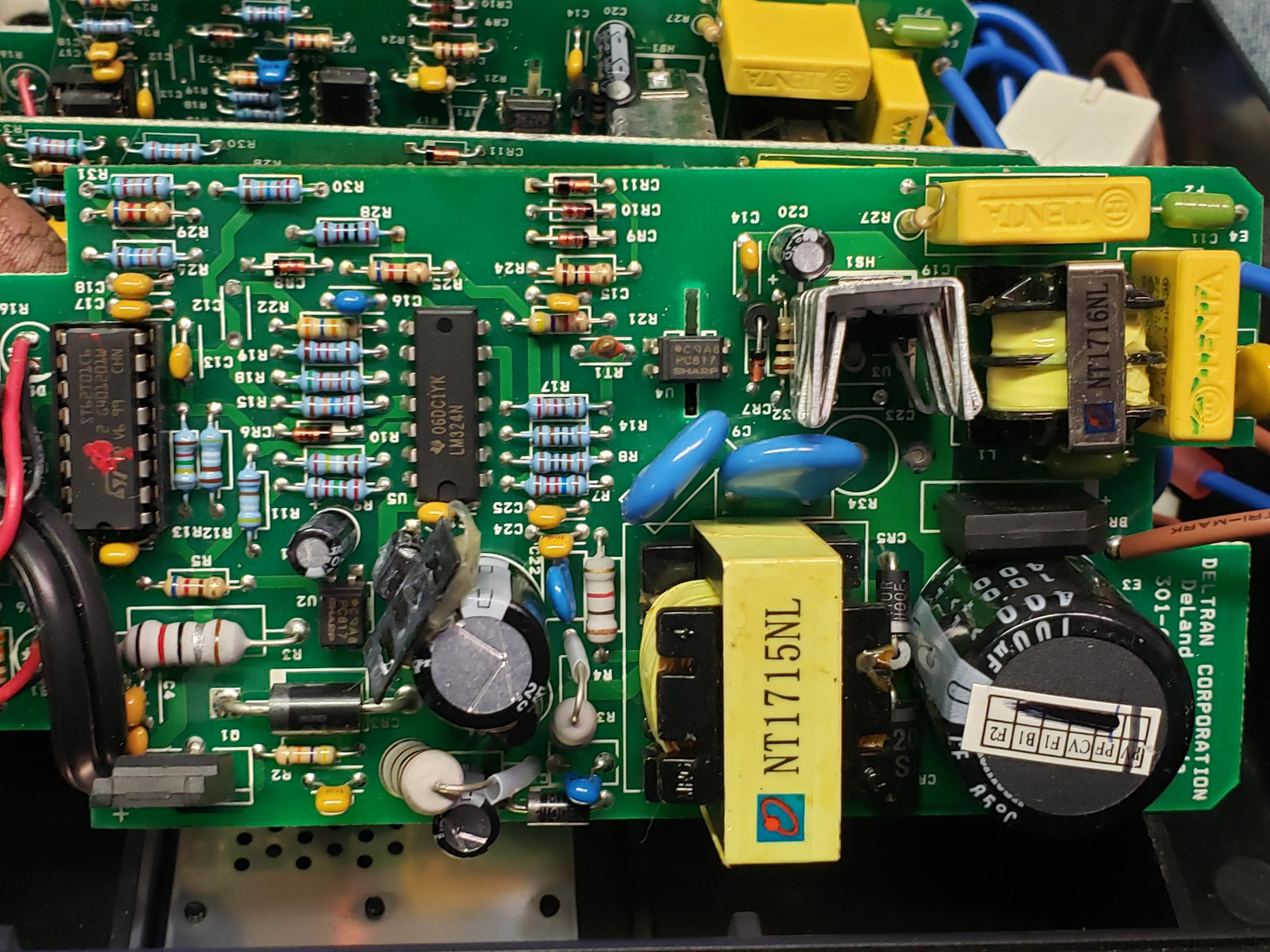

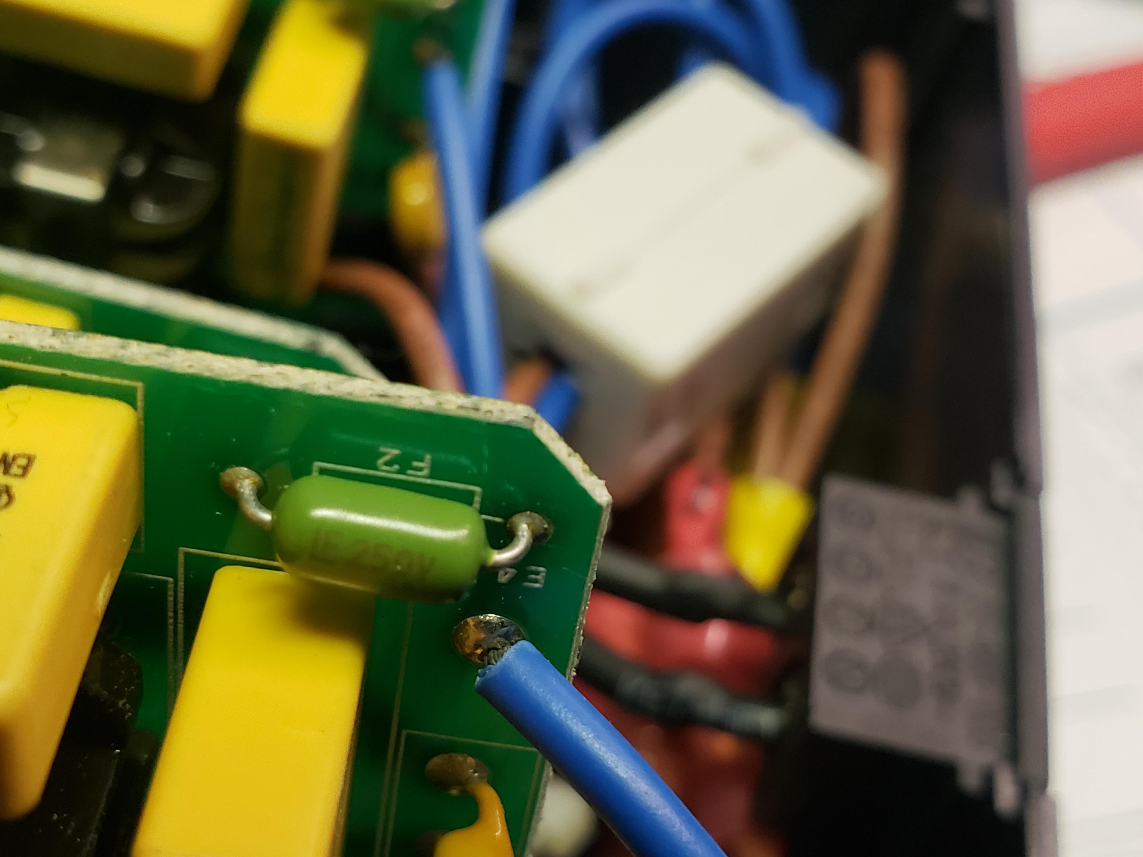

I have a battery charger/maintainer that one bank stopped working. I was testing and this component dose not have 120vac passing through it like the other banks. Dose anyone know what the component is? Thanks for the help.

I hope someone else will come in, but if it is a non-resettable thermal fuse, it will have failed due to a fault elsewhere in the circuit, and this fault would have to be identified first.
Are there any more components like this one in the battery charger which may aid you in your troubleshooting?
