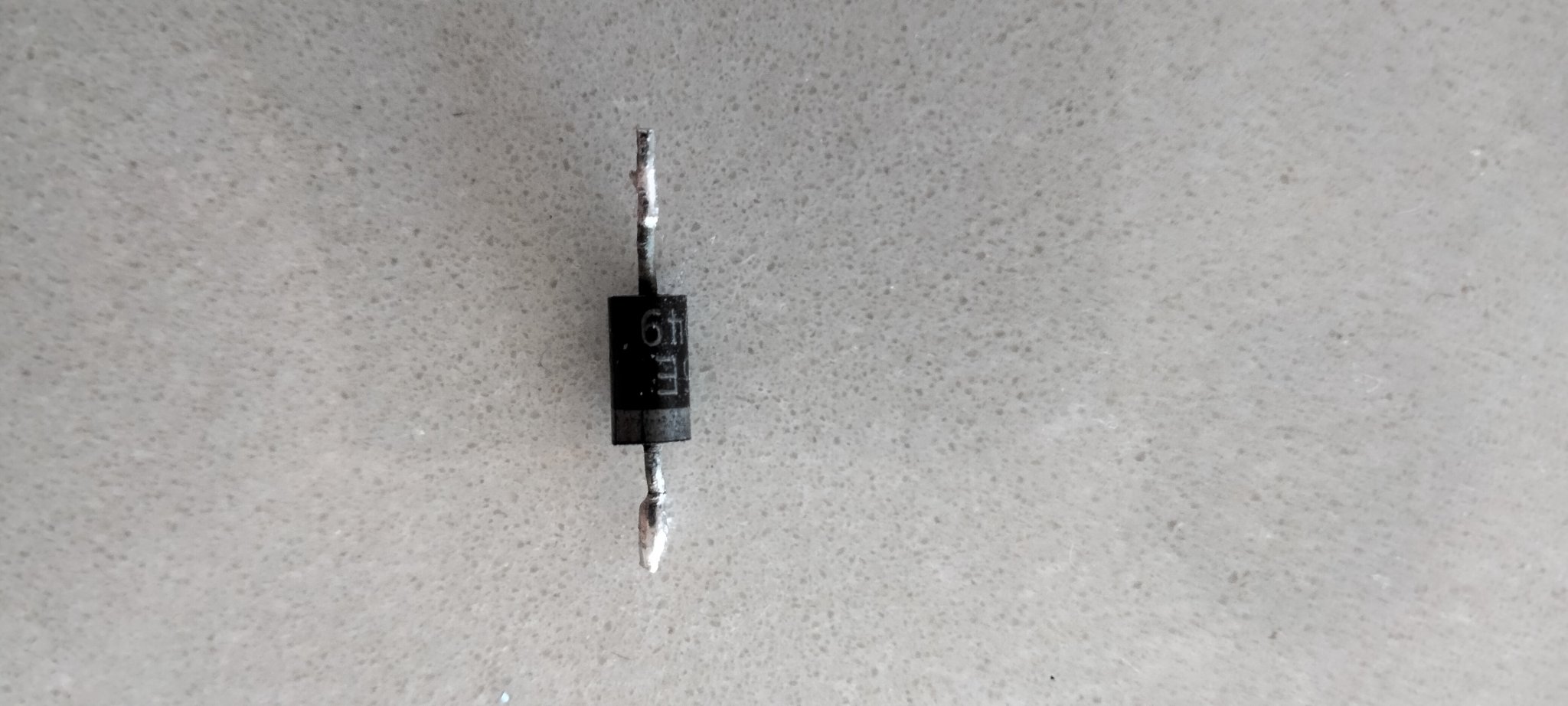

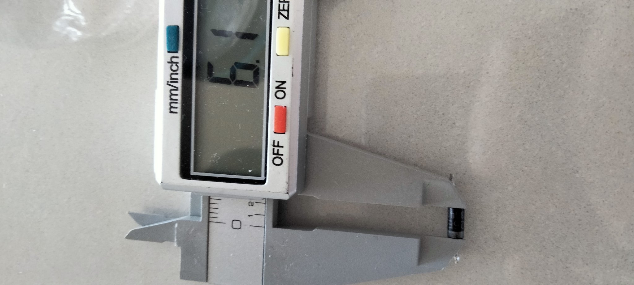

Have a blown diode from a Eaton 5PX 2000 rack mount ups that needs identifying.
Similar packaging size to your traditional 1N4xxx rectifiers.
Markings on this diode is
PJ26E
p e c 3049
From what I gather pec is now owned by Panjit but I cannot find any info on this
PJ26E
p e c 3049

'3049' might possibly refer to a 1N3049 which is a 1 watt 160 volt Zener. Not guaranteed but just a possibility.
Just check if those 2 large, white, ceramic resistors are connected in series with that diode. If they are - it's a Zener... most likely.
I'd use lower voltages Zeners (that'll sum up to 160V), each at 5W dissipation. It'll be bulky, but it would work better.
