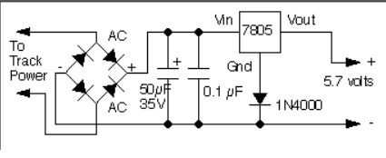

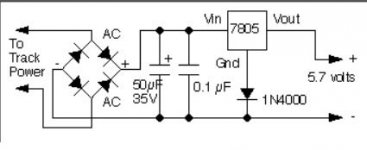

Its a standard technique to lift the output a three terminal reg. This shows a 7805, the 7905 would have the diode fitted the other way around (remember the pin outs are different for 79 regs). Use a 1N4148 type diode (small signal type as only a tiny current flows in it). The reg output is raised by the forward voltage of the diode. It works well... and you can use zeners (6v8 or 7v1 Zener) to make for example a 12 volt reg using a 7805, or you can use a resistor/s and make it variable, or you can add a transistor to the ground lead and make a super adjustable regulator with terrific regulation.
Here is the simple way. This adds around 0.65 volts to the reg output.
I'm limited to a MAX of -5v per the stock, factory-original 7905. See OP of this thread. Yes, the PDF schematic has a 7906, not 7905. But my Philips CD60 uses a 7905.
Also, in the other thread, I noted that I did replace the 1541's -5v rail 5-ohm "safety R" to 0.5-ohm. That brought the voltage up -4.5v (up from -4.3). Noise issue remains.
