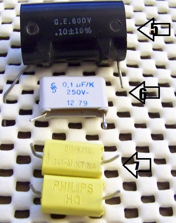

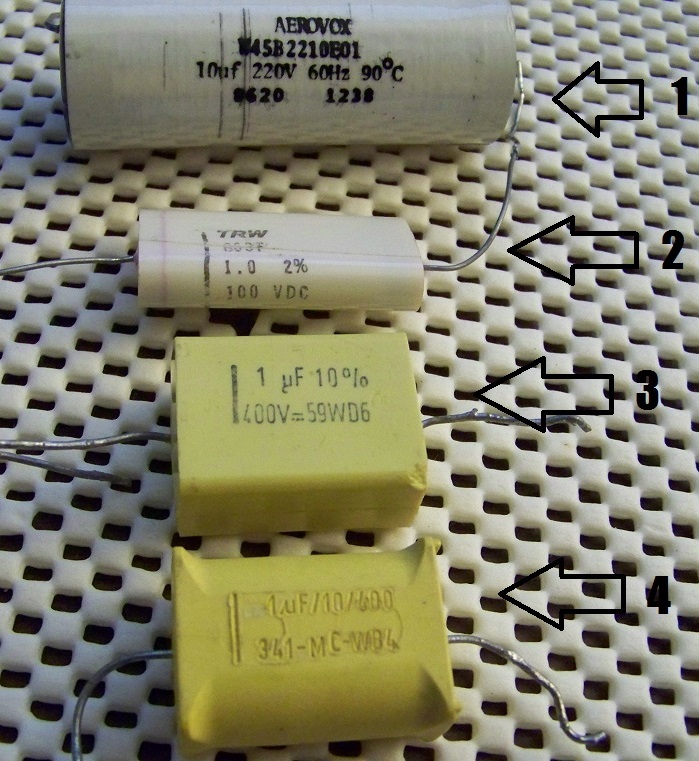

#1: 10µF 220VAC (Motor running cap perhaps).
#2, #3 and #4: 1µF @100 and 400VDC respectively.
#5 0.1µF 600VDC
#6 0.1µF 250VDC
#7 0.1µF 100V in appearance.

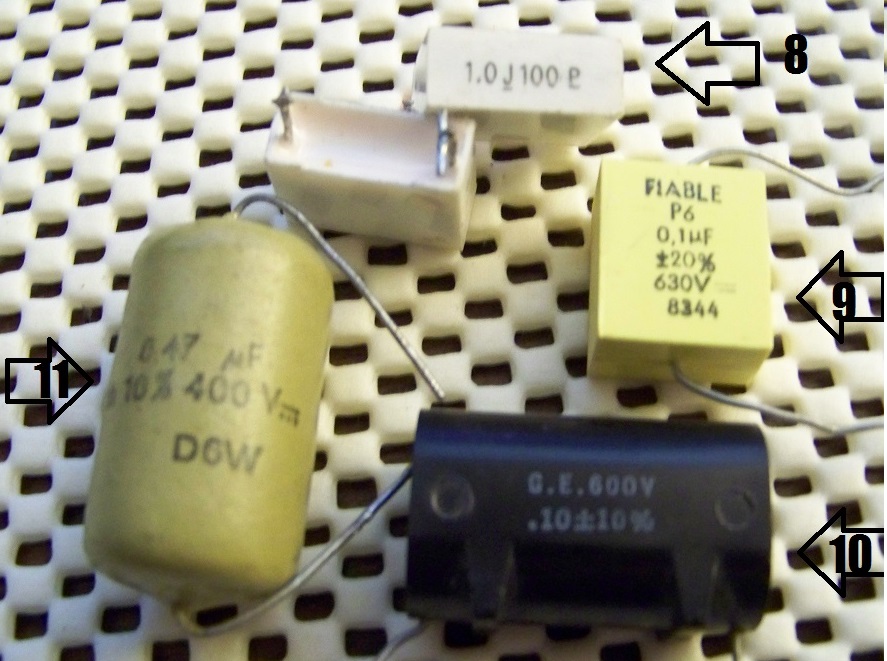

#8 0.1µF 100VDC
#9 0.1µF 630VDC
#10 the same as #5
#11 0.47µF 400V Philips.

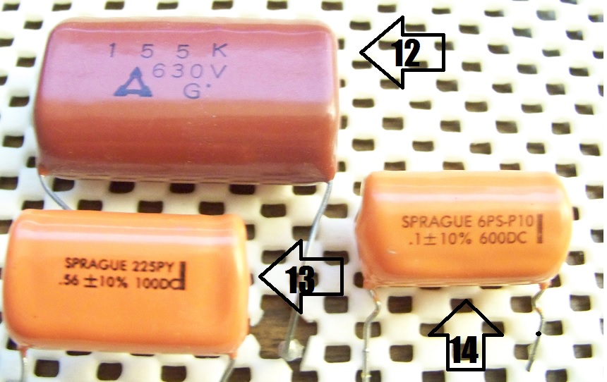

#12: 1.5µF 250V
#13: 0.56µF @ 100V
#14:0.1µF @600V
#15: directly to the trash can: an electrolytic with more than 30 years of manufacturing, (Year 1988 week 37). A dynamite cartridge.

Hi, a coin on each picture could help for the size...
1/2/7/8 MKT ?
3/4 MKC (polycarbonat) ?
9 : mica or ceramic BX type ?
12/14 KT (non metalized polyester single wound)?
13 : MKP ?

Yes, I was thinking #4 was polycarbonate, because of the "-MC-" imprint.
I had tried looking up these caps in the catalogues of the manufactures I
could identify. However, these caps vintage predates anything in their infos. 🙁

I'm pretty sure the two Sprague orange drops are MKT
But don"t know if the 13 is a 1,5 uF mkp or mkt...would say MKT maybe due to the voltage and size...?
The first Sprague is polyester, and the second is polypropylene.
https://www.cde.com/resources/catalogs/225p.pdf
https://www.cde.com/resources/catalogs/PSP.pdf
The second links explain fromm 200 V to 1000 the film is polyester ? Typo ?
No typo, the lower voltages are polyester.
