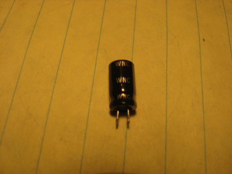

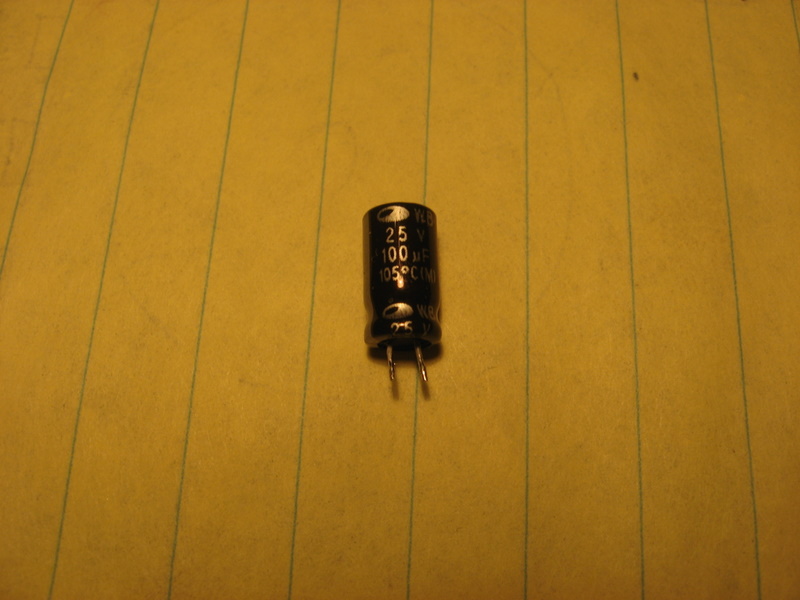

Does anybody know the manufacturer and series of the cap pictured below? It's a 100uF 25V electrolytic and I can see WB which is probably the series and WNC which is probably the manufacturer but I'm not sure. A link to the manufacturer's web site or a datasheet of this cap would be most appreciated. I'd also like to know if this cap is any good for use in the signal path.

Trying to make the symbol out,
Samwha Electric - Your Future is with Us

So it's a Samwha! Thank you so much! 🙂
Yeah, actually I already replaced it with a Rubycon ZL. I was just curious about it. Are Samwha caps known to be good quality? I'm wondering because I found it in a high-end ADC unit. Not a likely place to be for a mediocre cap, but maybe the manufacturer was trying to cut cost and the cap is good enough that not many people will notice a difference.
Samwha are a big player, and I wouldn't like to say yea or nay as to how good they are.
They wouldn't be my first choice... but I'm basing that on having worked in the repair trade and seeing a lot of Samwha caps as standard fitment. Often in those cases it's improper circuit design that causes failure so I won't commit on that.

Thanks! That's enough of a reason for me to replace them. 🙂
I quite like Panasonics and Rubycons... there what I always order.
I was choosing between Panasonic FM and Rubycon ZL for this position (audio signal coupling). Which one would you have preferred?
I'm sure if you do a blind listening test you wouldn't tell them apart 😉
For small signal stuff I like Panasonics, the ECA series, partly because I can get them locally,

Oh these are "for audio" caps. Nice! I wonder, how do they compare with Elna Silmic or Nichicon Muse? I've heard big praises for Elna Silmic but the only problem is its size, too big to fit most of the time when replacing existing caps. If these Panasonic ECA are as good sounding as the Silmic then they are a great find!
