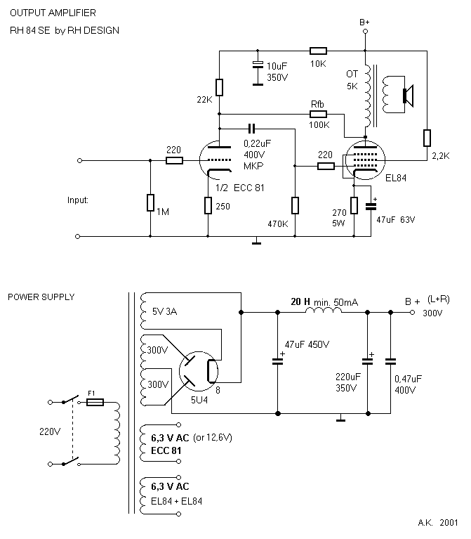

I think Tom Bavis has provided an important clue. Those O/P trafos appear asymmetrical.
FWIW, my inclination is to rebuild the bugger into a nice little SE amp, as that power trafo energized both the amp and a tuner, which makes it way oversized for a preamp. Consider a variation on the RH84 (schematic uploaded) theme. Install a pair of $37.01 Edcor GXPP15-6-8K O/P trafos. The heft associated with a 15 W. rating should give you extension into the 1st audio octave, at the 5 W. a pentode mode EL84 yields. An additional tweak is to regulate each EL84's g2 B+ with an individual LR8 IC.
It's likely the OEM rectifier was a 5Y3. You can increase the B+ rail voltage, without overstressing the 5 VAC winding, by installing a 5V4.

Zenith was both clever and CHEAP. 🙁 The 2 sections operated out of phase. They functioned to produce a mono center bass channel and 2X stereo HF channels. Unless you want to construct a speaker system for that sort of setup, replace the O/P "iron".

A look at Hammond's connection diagram suggests using the green and black wires, as the speaker connection.
There's enough hookup combos on the Hammonds that they will just about work with anything. It's more the Zenith's I'm wondering about. A glance at a few SE EL84 designs show pri impedances of 2.5-5k, so I should be able to make that work on the Double Darling.
Unfortinately the power xfmr was fried, so I yanked the 270FX out of my DC Darling along with it's 125ESE's and I'm in the middle of rebuilding this thing into a SE EL84 amp to listen to. Clearing out all the tone controls and recapping here and there.
