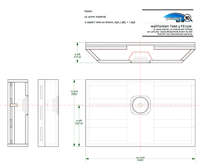

Hello,
I'm looking for a full range project (4" driver?) that I can hang on the wall. I'll be adding a sub so I'm not so concerned about lower end. I'll be driving it w/an old B&O ss 55 watt receiver with my mac as the source (I'll be adding a dac because my sound card has taken a crap on me).
It's my office, so the front walls are about 8' away, sides are 5' and back wall is 6'. I want to hang them about 4.5' up. Measurements are from my sitting position.
I've built several sets of speakers and subs, but only 2 full range projects http://www.diyaudio.com/forums/full-range/105689-first-set-full-rangers-done.html and a tang band 3" near field set of computer speakers. I really liked the way the fostex design sounded, but they needed to be away from the walls. The tang band speakers sounded good for what they were, but I want something that sounds better. I have absolutely no experience starting a project from scratch.
I'd like to keep the component cost to $300 (or less) not counting the enclosures. I'd love to try the fostex sigma, but...? Or if anyone has old drivers they'd like to get rid of I might be able to give them a good home.
The main goal is to get these things on the wall (and sound great), not in the wall or on stands in front of the wall. Any suggestions or projects would be appreciated.
The Cornu and it's variants get discussed here from time to time.
And Scott has a design for the Fostex FE series resembling his fonkens but in the cornu style: wide and flat.
The one I'm thinking of can hang on the wall, but with any of the Cornu variations, they'll be heavy need to be secured well. And find a nice place for the wire too.
Scott and Dave monitor all the threads here so the picture should turn up if you ask.
Cornu is a proprietary design but there are plans for it in an old issue of Speakerbuilder IIRC.
Hmm, ideally you want a low 60s XO point if the sub is sitting on the floor under it, ergo mains with a maximally flat response to the same point, a lot to ask of a 4" in 2pi space without a huge cab.
And Dave has a design for the Fostex FE series resembling his fonkens but in the cornu style: wide and flat.
dave
