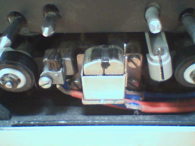

Help, I need a combined head for ReVox B215!
Does somebody know where I could get used but in good condition or a new playback/record head for deck ReVox B215? It has a very pretty mechanism - I hate to see it staying in my closet because the head is completely worn out.

combined head for cassette deck ReVox B215
Thank you for the replies. I have heard for instance that the combined head of cassette decks Sony TC-K71 and Sony TC-K81 is identical to that of ReVox B215. So bought old Sony TC-K71 from ebay and will be replacing the worn-out headset with its own. Have somebody done something similar ? Are there any tricky moments? For instance I saw that the ReVox headset is inside a casing which is different that the Sony headset casing. So for now the only tricky moment which I see is to get the old headset from its casing and put the new one there.
Dimitar
