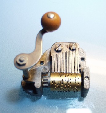

And by the way folks: here is a nice and simple instrument (I don`t know what to call this in English) to quickly get an idea how "dead" (or not) Your enclosures really are. Get it working in free air, on a wall, a table and at different locations on Your enclosures - You will be surprised how nice Your enclosures will ring ..............

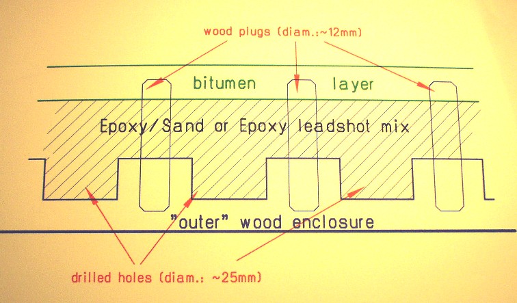

Eventually, my conception of a "dead enclosure approuch" :
- A heavily braced (perhaps matrix style) rigid "outer" enclosure from multiple layered birch plywood ~30mm.
- A poured Epoxy/Sand or Epoxy/Leadshot mix about 25mm thick (kinda second inside enclosure)
-Upon that a ~15mm poured bitumen layer
In order to "teeth" the materials to each other, I thought to drill holes in the outer enclosure (see picture) repectively to drill and glue wood plugs in it. This also might prevent the bitumen coating from flowing down to the bottom of the enclosure during the time in case when lower viscosity bitumen type is used .
