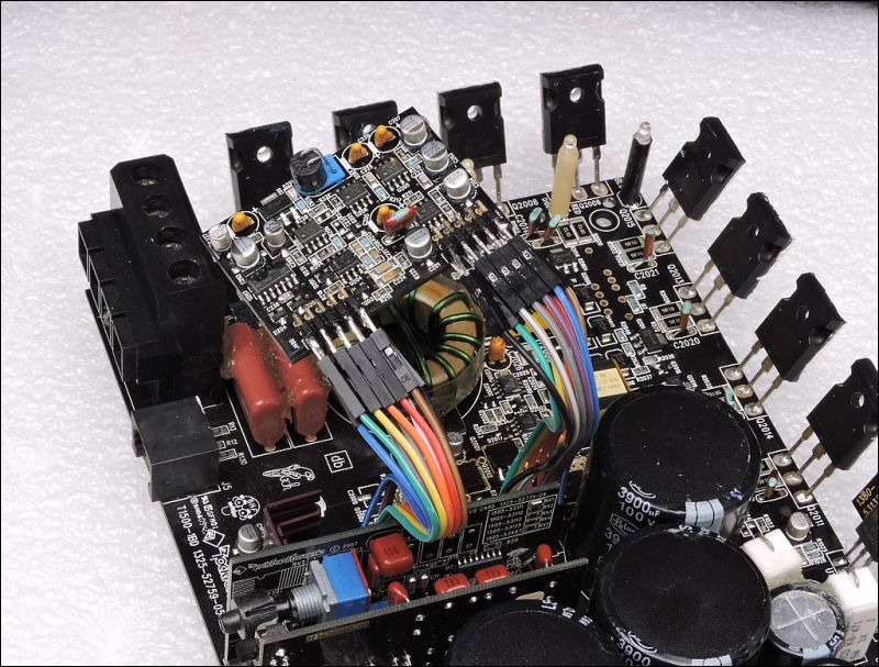

It's normal for both of those transistors to run very hot. In time, they can damage the board. You will generally see signs of heat stress when you pull them. I install a heat spreader to help keep them a bit cooler.

The output FETs are not ICs. An IC has multiple discrete components on one device. The outputs are discrete FETs.

The driver board has a feedback line connected to the output of the amp. That could be why you have the voltage.
Post the DC voltage on all header terminals of the driver board. Copy and paste the following list and fill in the blanks.
