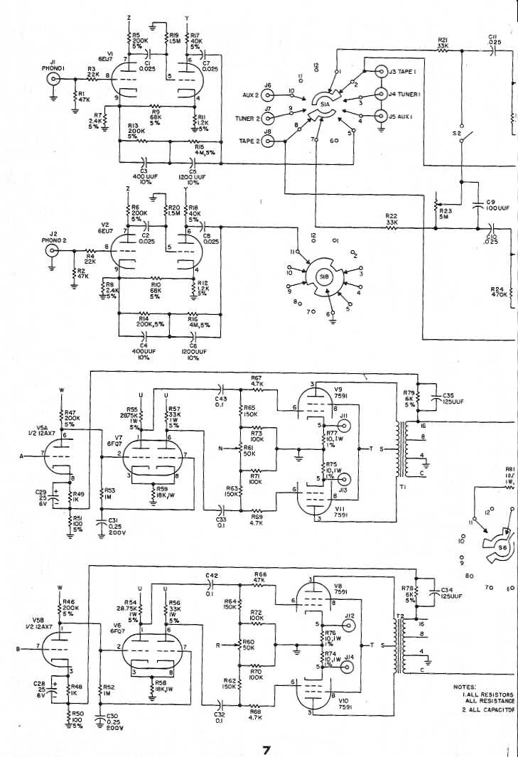

First let me include the schematic of the integrated amp so that there will be some reference to the components for the sake of discusssion. There were some tweaks in component values, but overall circuit remains the same.
Sadly to say, this happens to both channels. I removed the input tube one channels at a time. Effectively I was running single channel, same symptom to both. Whatever I did wrong, I did it twice 🙂 When the input is open (nothing plugged into it), it is totally quiet. Once I put in a shorting male RCA plug or a turntable to the input, the hum appears.
FWIW, the circuit star ground that I mentioned is where all the local star grounds merged. Local star grounds are power supply ground, output tube ground, LTP ground, AF ground, line stage ground, and the phono stage ground. It is point to point wiring.
The phono input doesn't have an input cap, but the line stage does.
The shield cable is a coaxial cable, but I only use the coax's ground for shielding. I tied the RCA's ground tabs together and run a wire from this "combined" ground to the star ground. One side of the shield cable is also connected to this combined ground spot. I will upload a picture of input wiring later once my daughter brings back the camera. Sorry for my lousy description, it is so true that one picture is better than thousands words. I will try to get one asap.

Maybe it's my eyes but I see the cathode resistor going from ground to the input, then a black wire going from the input to the cathode - but no connection to the RCA ground..
Not knowing the pinout etc I could be wrong though, but either way I see no ground for the socket, and the grid should be grounded from the same bit as the cathode resistor ground.
This is assuming a grounded grid as implied by the low R resistor from input to ground - or is that just a load?

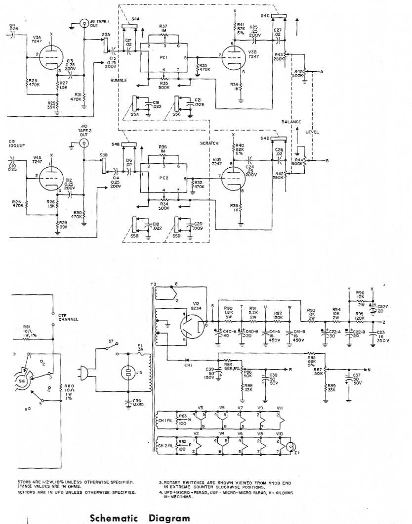

Loren, the schematic is in post #22 in zip. Here are the schematics
in JPG form.

The schematic shows the jacks grounded, but does not differentiate the type of ground or the mechanism used.
Shielded wire is not designated on the schematic, so again, it is hard to determine how this is really wired.
I guess, for clarity's sake it would be ideal if that was noted on the schematic.

Yeah, this is pretty much true for most of the 50's and 60's tube schematic - no indication of the grounding scheme to use. The 2080 was a revision of the amp that I am rebuilding - an Eico ST-70. I do have the construction manual of the ST-70.
In the original amp, it used 2 wire power cable and the chassis was the common ground, i.e. the signal and power supply grounds were either soldered to a tag board which had the tap bolted to the chassis or directly to the chassis. I replaced the power cable with the 3 wire IEC cable and had the earth tightly soldered a tap that is bolted to the chassis. I also redid the star grounding as I described earlier.
The original amp used shielded cable for all inputs. I think it made sense to this amp as the input jacks and the selector are very far away. So, I used shielded cable, too. The major differences are I used multiple shielded cables where the original was like a snake cable which have many wires inside.

Tom
A minor change:
After reading the article at http://www.diyaudio.com/forums/diya...udio-component-grounding-interconnection.html , I now think you should connect each of the shields of the two-internal-conductor shielded input cables directly to the main star ground point (instead of to the chassis), with a separate wire from the upstream end of each shield to the star point.
Tom
Kudos to everyone who helped tackle my problem. I am pleased to report that Tom's suggestion did the trick.
Since I wanted to know exactly which was the major mistake that I made, I took the time to make incremental changes and used a signal tracer to test the result. I concluded that my mistake was the act that I tied the input's ground together. This scheme doesn't affect the high level inputs (no hum at full volume) but not so to the phono inputs. After I cut the input "common ground" and ran 2 separate ground wires to the star ground, the hum was reduced greatly. Anyhow, Tom's scheme was the final touch.
Again, a big thank you!!!
