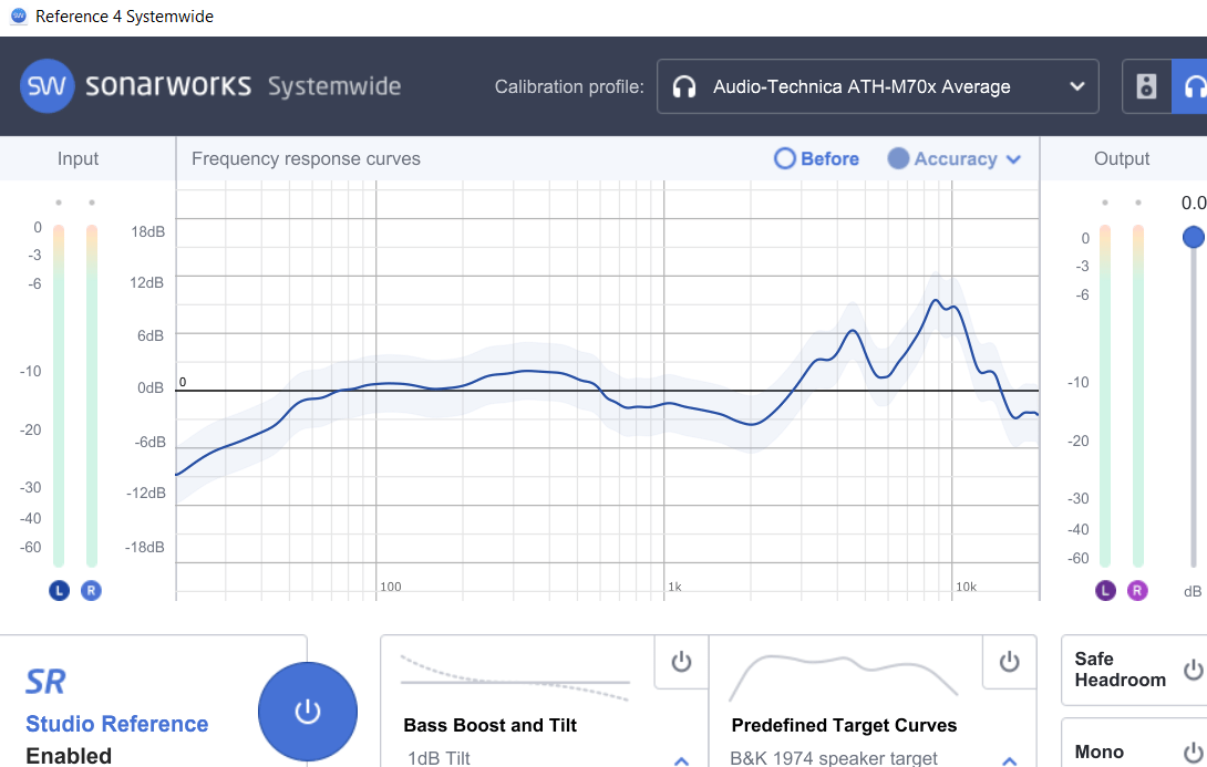

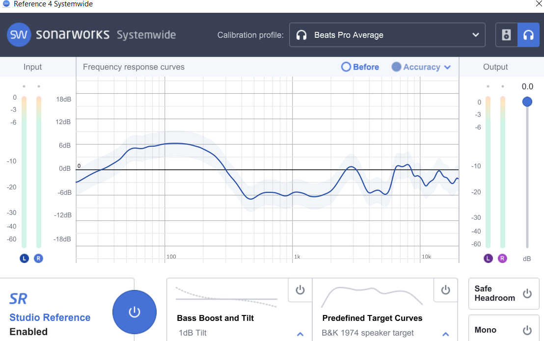

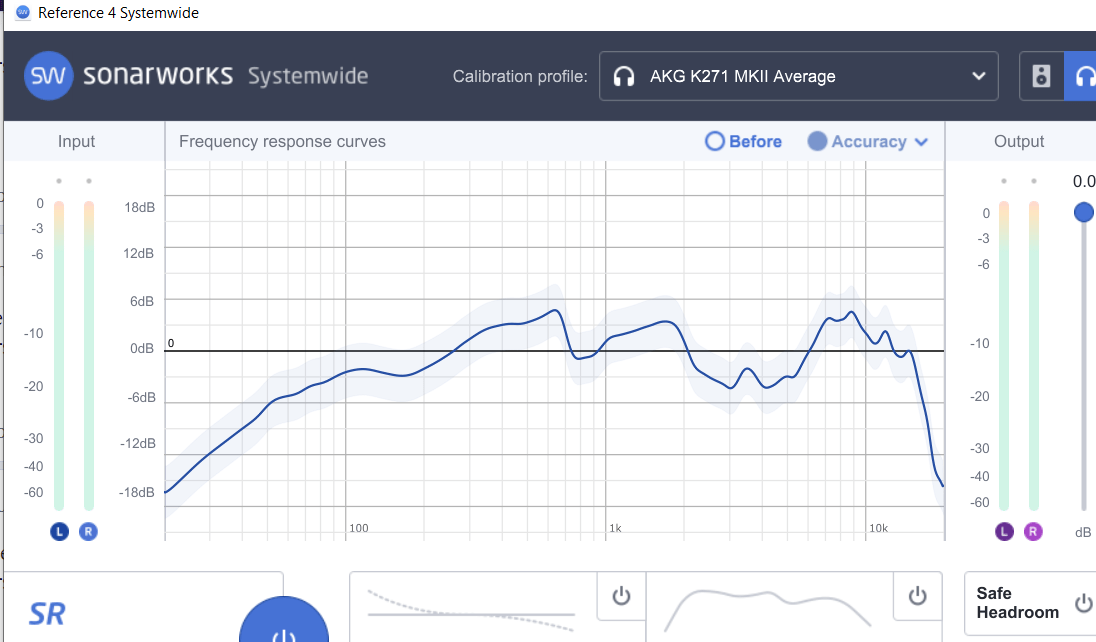

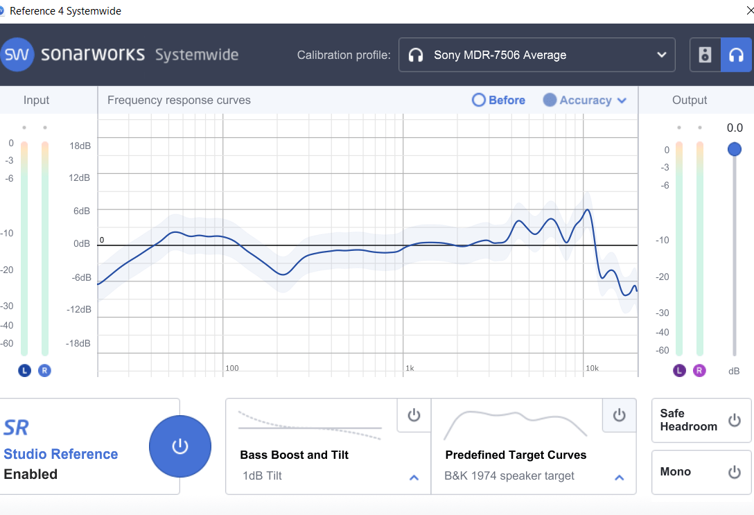

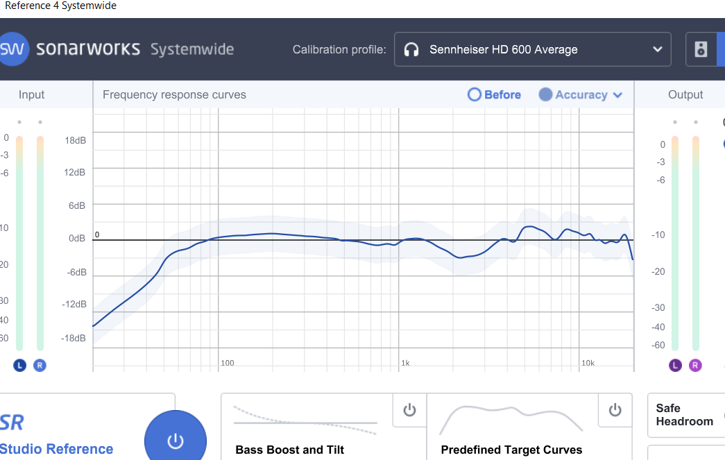

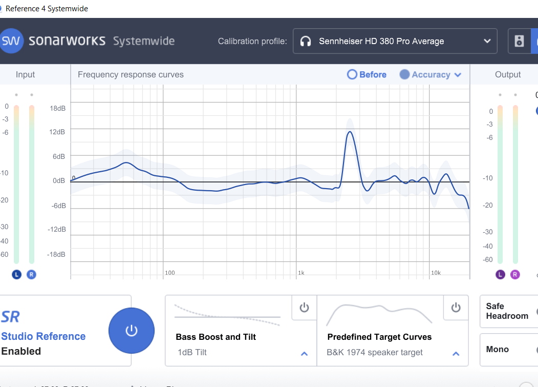

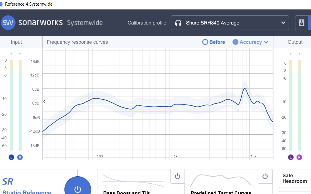

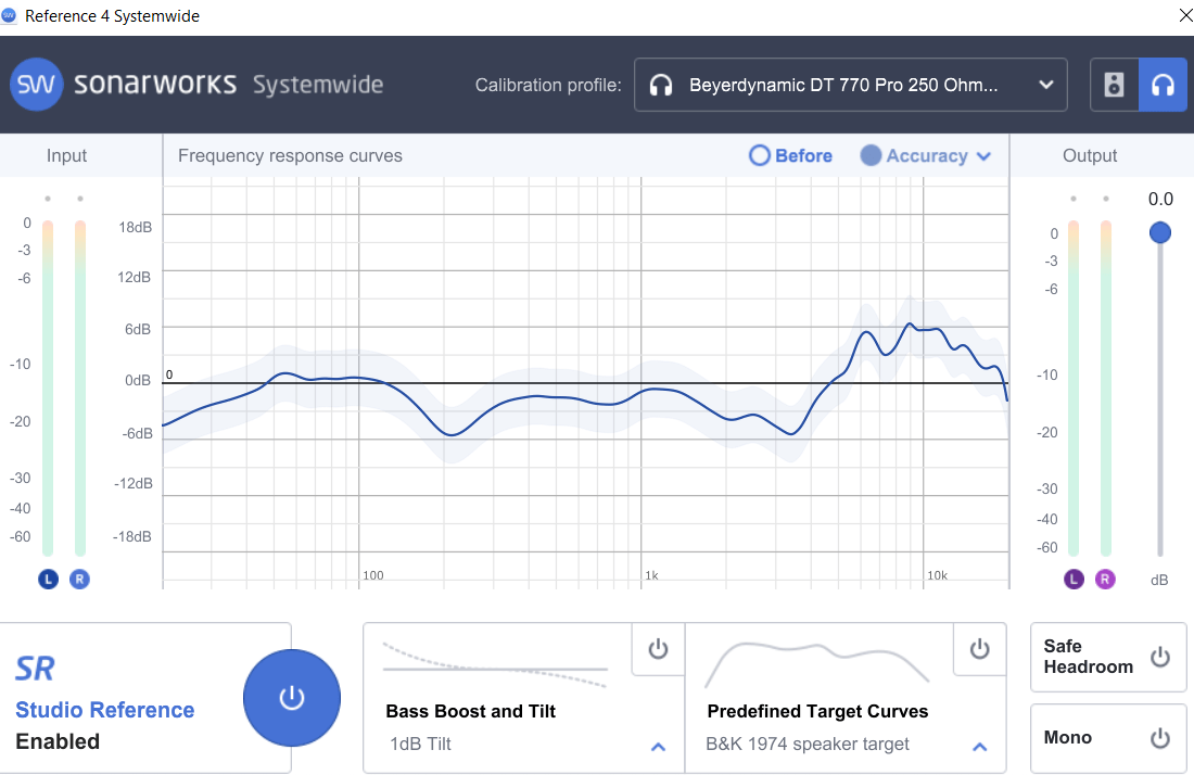

I've got Sonarworks on computer and using the generic average corrections included give better sound with most the headphones I have, even the hd650 benefits I think. Here some screenshots for amusement. See for example the sennheiser hd380 pro, quite nice sub 100€ headphone otherwise except that +10db peak around 2kHz 😀 Or the Beats Pro with 12db bass boost, and whats wrong with the AKG? wild

Thank you once again for the thoughts and info. Those are some quite illuminating graphs tmuikku, very interesting. Thanks also twocents for the harman curve link, that is a very good article; I will need to study it in order to comprehend many of the details properly, but it is clearly going to be very useful to my understanding. As you say; so much to learn, and indeed it isn't a quick process.

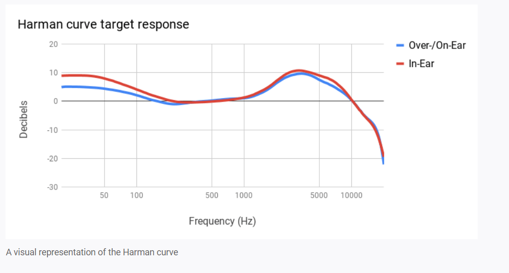

Hi all, it turns out headphones have their own Harman curve which looks like something like this:
Google up "harman headphone target curve" to find more info on it.
10db peak ~3kHz, what the .. apparently ear canal resonance masks this area when using headphones so boosting makes the perceived response flat, or something like that. Need to try this, the Sonarworks version I have don't seem to have this.
To be fair the image is stolen from here https://jazztimes.com/reviews/products-and-gear/audio-files-the-harman-curve/
