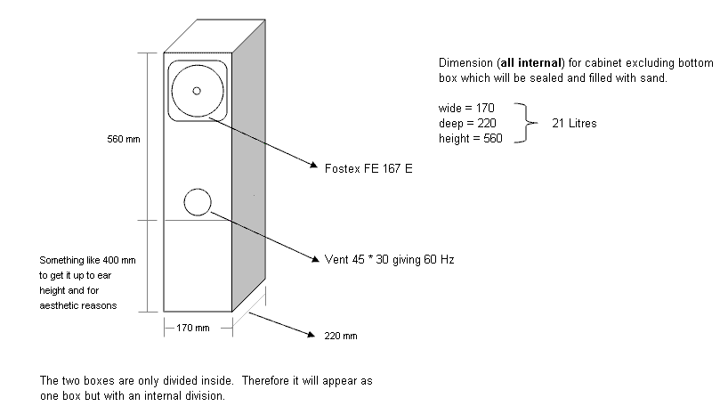

I've bought some Fostex FE167E drivers and im now trying to design a cabinet to put them in. Let me add that im a beginner!
I was originaly intending to use the fostex recomended enclosure but ive been told that it maybe too small. Plus ive noticed bob brines uses a larger enclosure (his smallest is 24L i think) and ive been told from anouther site of someone using a 21L enclosure with success.
So ive decided to use a 21 L enclosure, make it tall and thin (for aesthetics).
I entend to use baffle step correction compensation too.
Ive attached a pic of my plans so far and im looking for criticism, help, ideas, etc....
Any help will be much appreciated.
Thanks.

the tuning and all looks alright.
I think you got messed up with internal/external measures of the speaker? 560*170*220 should be internal right?
Have a look here for some inspiration. (should be ~20l+ as well)
I built the 15l-recommended and well the tuning is alright but yes for most recordings a bit on the thin side when it comes to bass.

Hmm, tall and thin, eh? Since even most old vinyl has strong content to 40 Hz, this seems the 'no-brainer' Fb choice to me, so using your 374 cm^2 (~57.97"^2) CSA (cross sectional area):
L = 50.375"
zdriver = 17.375"
zport = bottom exit
rp = 1.5"
Lp = 2"
Space it up off a massive plinth as required to get it to ear level. With 2-3 ohms series resistance/BSC it should be solid to 40 Hz at modest SPLs if not placed too far out into a large room.

yer the only dimensions I have worked out so far are internal so all dimensions should are internal.

I guess from your picture GM thought you like the enclosure to be tall and thin.
The values given mean:
L: inner lenght of the enclosure
zdriver: position of the driver measured from the top
zport: position of the port measured from the top(here:50.375")
rp: radius of the port
lp: lenght port
Cross-sectional-area🙁wide*depth)
(S0/SL in the drawing below)
have a look here for a better understanding:
(and the whole webpage if you wish:http://www.quarter-wave.com/)
http://www.quarter-wave.com/Models/Box_App_Notes.pdf
greets

No need to apologize! I see Jens explained what it all means. Your first post 'sounded' like you had at least some knowledge of speaker design and since you had done some research I assumed you had at least been exposed to MJK's MathCad WS and many of the various pipe designs already documented on the various forums/personal websites.
Studying everything on MJK's and Bob Brine's site is a great start!
No, it doesn't, but you both stated a desire for and depicted a tall/thin design, but in reality it's a typical ~small box speaker with a massive 'stand' attached. My suggestion OTOH is a true tall/thin pipe design that will perform somewhat better down low one optimized with either some series resistance and/or BSC and typically 'sounds' subjectively 'tighter'.
Hmm, this indicates to me that you're really not interested in learning about speaker design or building a true tall/thin (pipe) speaker, but just looking for some validation of your design, which Jens has already done, so build and enjoy.

Build GM's design. It would be hard to beat for that driver.
You can build the downfiring enclosure like this:
Or you can put it on stilts, like this:
Since the port diameter is 3", I believe as long as you give at least 3" clearance below, it ought not change the tuning of the enclosure much if at all.
I am a proponent of "wide and shallow" enclosures, as it lowers the baffle cutoff frequency. I have also listened to a pair of the Jordan JX92S in the VTL enclosures, and found the stereo imaging excellent.
