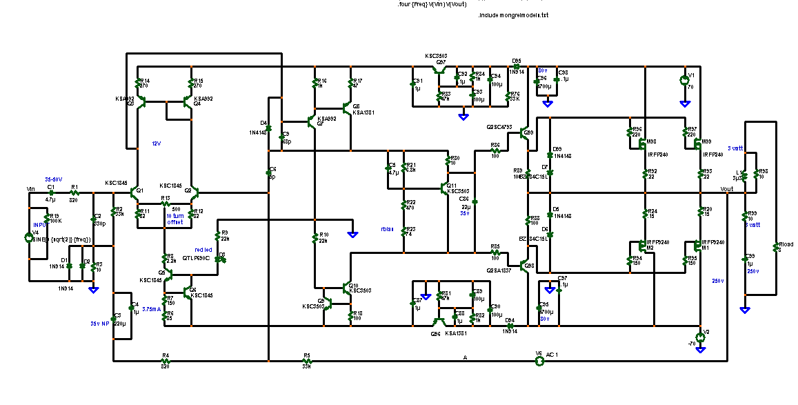

here is one for you..(below)
150w/8r
doug self "blameless based"
300w 4R
runs from 45-65V rails
The voltage stage is done but the artwork for the MOSFET power stage is under development.
OS

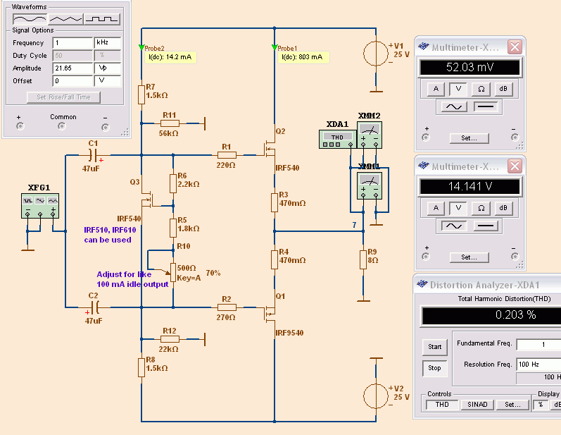

thanks sir for the help, but what i want is just to fix or improve my schematic (below)
here's the link http://i15.photobucket.com/albums/a369/panops/pleasehelp.jpg

You use 20 Volt supply, which
equals +/- 10 Volt only.
For HEXFET (mosfet) output follower
we get a 4-5 Volt drop. This is a direct loss.
Which leaves 5-6 Volt peak output across speakers.
So, in best case you can get 2.25 Watt RMS into 8 Ohm
I suggest you double supply voltage for output HEXFET.
40 Volt (+/-20V) or 50 Volt (+/-25V) is not too much.
It still is a power amplifier in the lower wattage range.
At +/-25 Volt the output will be 20-25 Watt into 8 Ohm.
I show down here an example how to do.
I use your idea, with small changes.
One thing.
Your two 1N4002 diodes makes the amp run in Class B.
That is, there is no idle current in MOSFET.
Put an Ampere-meter in that stage
, and you can see how much current at no signal.
For normal Class AB we can use 100 mA at idle.
For this you need more than the 2 Volt those 1N4002 gives.
You need like 8-9 Volt maybe. Depending on what HEXFETs.
Each MOSFET need 4-4.5 Volt for turning on and give 100 mA.
For +/- 25 Volt then IRF540/IRF9540 may do well. They are TO-220
If you can find the 'N' variants so those are to prefer: IRF540N/IRF9540N
For higher Supply voltage I would go for IRFP240/IRFP9240 in TO-247
which for example Nelson Pass uses often.
Diagram.
I show how you can use one extra MOSFET + Trimpotentiometer to set idle current.
I have used ~100 mA idle operation.
The output shown is at 14.142 Vrms which is 25 Watt in 8 Ohm.
THD:
1 Watt = 0.455%
25 Watt = 0.203%
The bandwidth is: 2.5 Hz - 3,500,000 Hz (3.5 MHz)
This is not too bad for no feedback.
If this stage was put inside a global feedback loop, it would do just fine.
