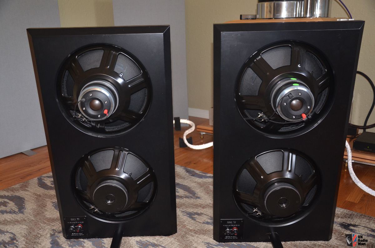

They are Spatial Audio M1 Turbo Se.
I was searching to upgrade them but so for could not find anything better than those even the expensive ones and thought maybe by changing HF could survive few years more!
Bass works as I want but I want detail like beryllium.
