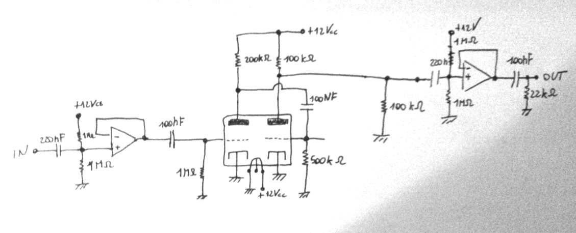

Hi, today i played with ecc83: i want a distorsion !!!
ive make this circuit, but sound terrible distorted and dirty, drammaticali compressed ( like a fart, or dc component ).
I think the problem is impedance.... i want insert this circuit in line in / out in my rack equipments. Line out from preamp -> circuit -> line in compressor.
Please help me!
p.s. op amp is a burrbrown opa2277p, -v is connected to ground, +v to 12 vdc. there is a 7812.

Well , Running at 12ax7 at 12v isn"t going to give you a Very nice distortion , Ive tried several 12v Tube curcuits and couldn"t get anything nice sounding , the lowest voltage I was able to run the plates and still get a nice clean distortion was 45v .....
You are right about the impedance though and putting a high impedance buffer at the output is a good idea so you get the best signal transfer but instead of building the buffer and maybe finding out that is doesn"t help , just plug the output of the tube cuircuit into a effects Pedal and use that as a buffer .....
Also you should put a 500k or 1m pot between the 2 tube stages so can controll the overdrive/distortion effect .......

ive try to connect only tube, without buffers, in a high z in of premplifier. Sound better, gain is low, and level distortion is low ( old rock style ). If i use a low volume in guitar sound is very warm. I dont understand why with buffer sound low and dirty: seem not a distortion of a tube. Ok tube at 12 v is not good, but this circuit dont work. This evening i record the distortion...

Run the Plates at a High Voltage , put a voltage divider on the output of the tube stage to knock down the output voltage to 1/10 , then put the Buffer at the ouput .... Marshal does this in some of their ValveState amps .....
Minion, are you saying that he won't get nice distortion because he is using a 12AX7? Or because he is running it at 12 volts?
You get great distortion out of a 12ax7 but is sounds pretty farty at 12v , there isn"t enough headroom at 12v for the amount of gain in at 12ax7 , I second the suggestion to try a 12au7 at 12v as it has less gain and would need less headroom .....
