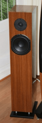

I am looking something like this pic.

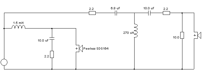

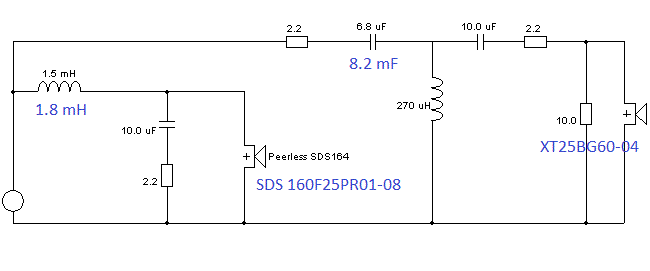

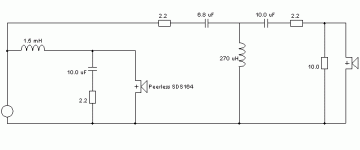

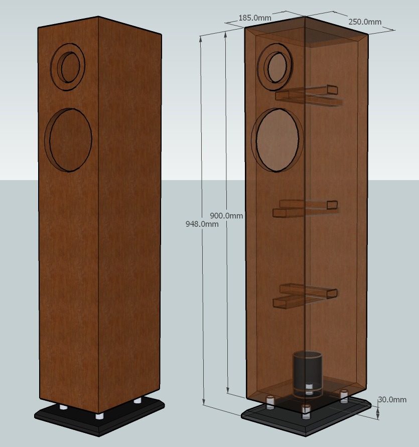

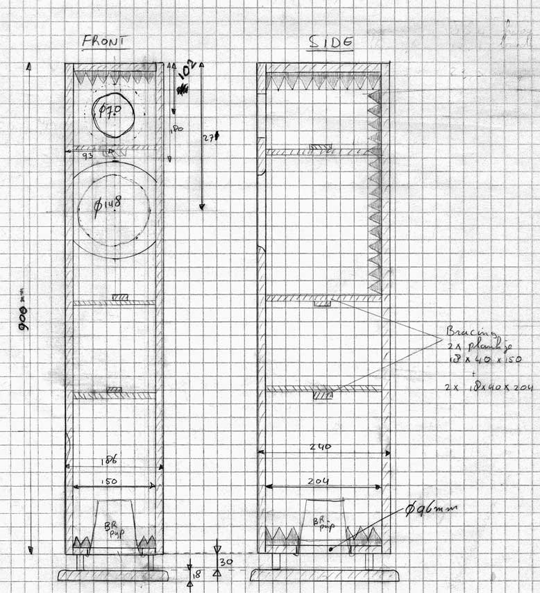

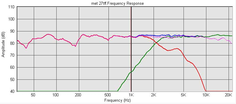

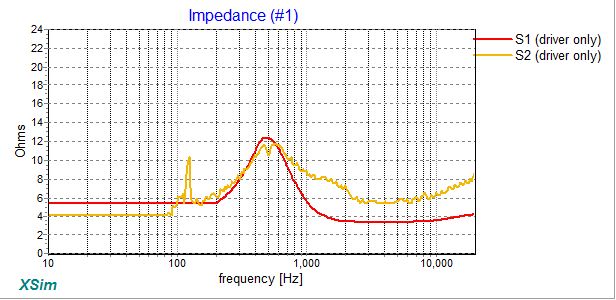

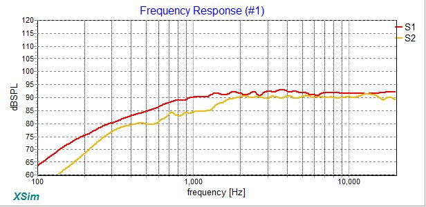

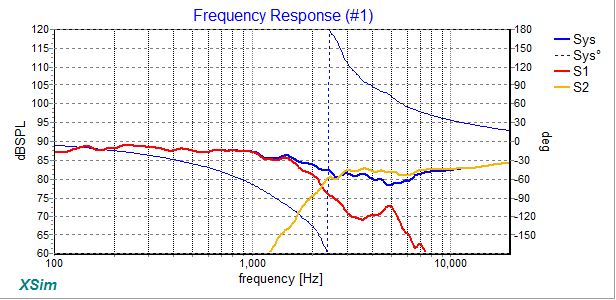

My Xsim model using traced factory graphs and using the Vifa instead of the SEAS seems to change the XO point from about 2200 to just over 2000 Hz. That's still OK for the tweeter, I think.
I attach Xsim graphs comparing the Vifa and SEAS tweeters. The red line is the Vifa and is based on a trace from the published specs, so it may not be accurate. The SEAS is taken from FRD and ZMA files from Madisound but I don't know the basis for their data.
The XO for the LVS does not seem to deal with the cone break up of the Peerless, which you can see on the third graph (again, only a sim based on my traced graphs) at around 4,000 Hz. Whether you can hear that is of course another matter.
I used a small (0.33 microfarad) cap and 10 ohm resistor across the woofer inductor in my test build to deal with that issue. My build used the Vifa BC25TG15-04, obviously a 4 ohm unit but much cheaper and with different specs to your tweeter.
But this discussion is only based on my sims and the factory supplied data, plus my very limited expertise, so please seek other opinions. Hopefully others with more knowledge and expertise will respond to your questions
Good luck
Geoff
Good luck
Geoff

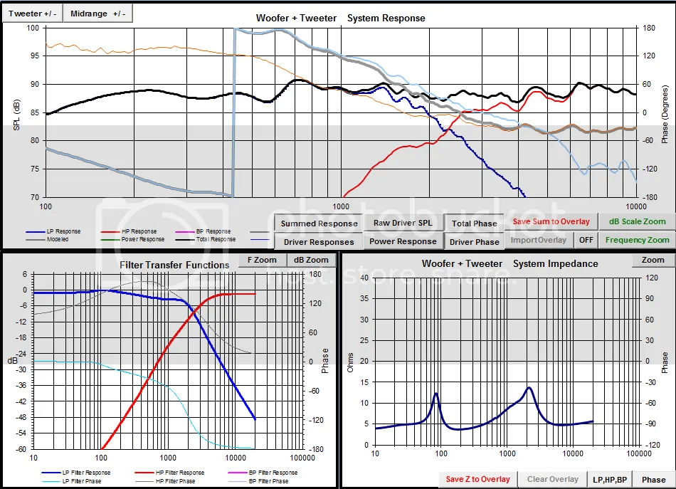

Hello Geoff, thank you for taking your time on this, I have the BC25 too, but I read it needs to be cross at 3k+ and the XT25 at 2k and because Peerless consider the SDS a subwoofer I though it will be better at 2k and I guess thats what your graph show, but I'am open to use either.
If I XO at 2k what do I need to change in the LBVS XO?
(sorry for my bad english, I try my best)
Gustavo.

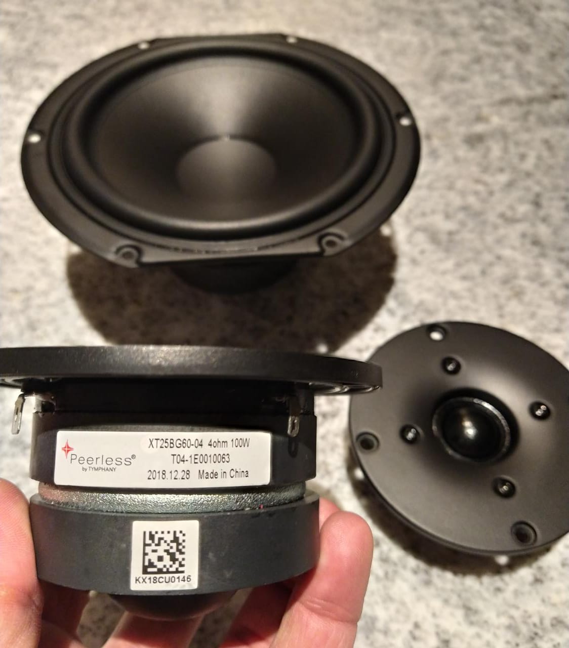

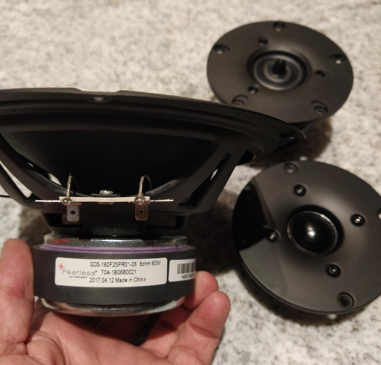

I've used the BC25 in three projects, all other peoples' designs: with the 830656; SB16PFC-8; and the Dayton DC160-8.
The DC160 was in the "Classix II", which was I think crossed at about 2200 Hz, the other projects, a bit higher I think. Paul Carmody used a 'fourth order' crossover to protect the tweeter, explained on his website. I've had my Classix for years and love the sound.
My test build with the BC25 and the SDS160 was OK but there was something not quite right about the sound; could have been the crossover point, more likely my lack of design skills and measuring equipment.
At least on paper, the XT can easily cope with 2,000Hz because it has a low 'resonant frequency' compared to the BC. If you have both drivers, I'd be inclined to use the XT as from all accounts the Peerless woofer seems happier to be crossed at 2,000 than much higher and I think the XT is a higher quality, more robust tweeter anyway. I've seen projects which crossed the SDS160 at 2500 and reportedly sounded fine; however, they're designed by people who know their stuff.
In Xsim, changing the woofer inductor to 1.8mH from 1.5, and the tweeter capacitor to 8.2 from 6.8 microfarads results in a 2,000 Hz crossover point on paper, but I've no idea what it would do to the sound.
Maybe Peerless considers the driver a sub woofer because of its Xmax, but I think it works fine as a mid-woofer.
As noted, you really need someone with more expertise and experience than I to advise you about this but I'm happy to help if I can
Geoff

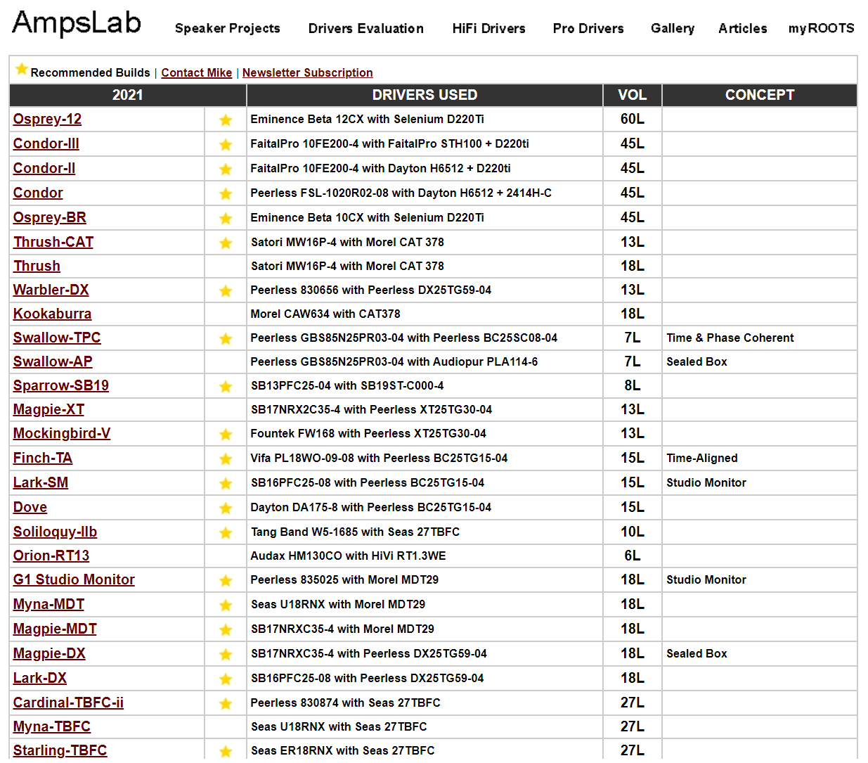

My original plan was buying a kit from GR Research but I saw the Peerless good price and decided to give them a chance.
Maybe my next proyect will be a kit with SBA drivers or Classix 2.5, I see several speakers with Peerless drivers from Ampslab.
thanks for your comments and help, I really apreciated.
Gustavo,
