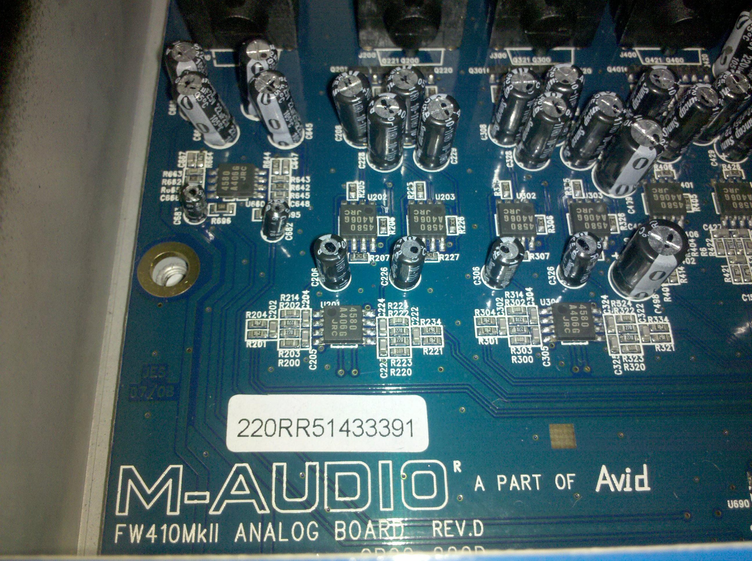

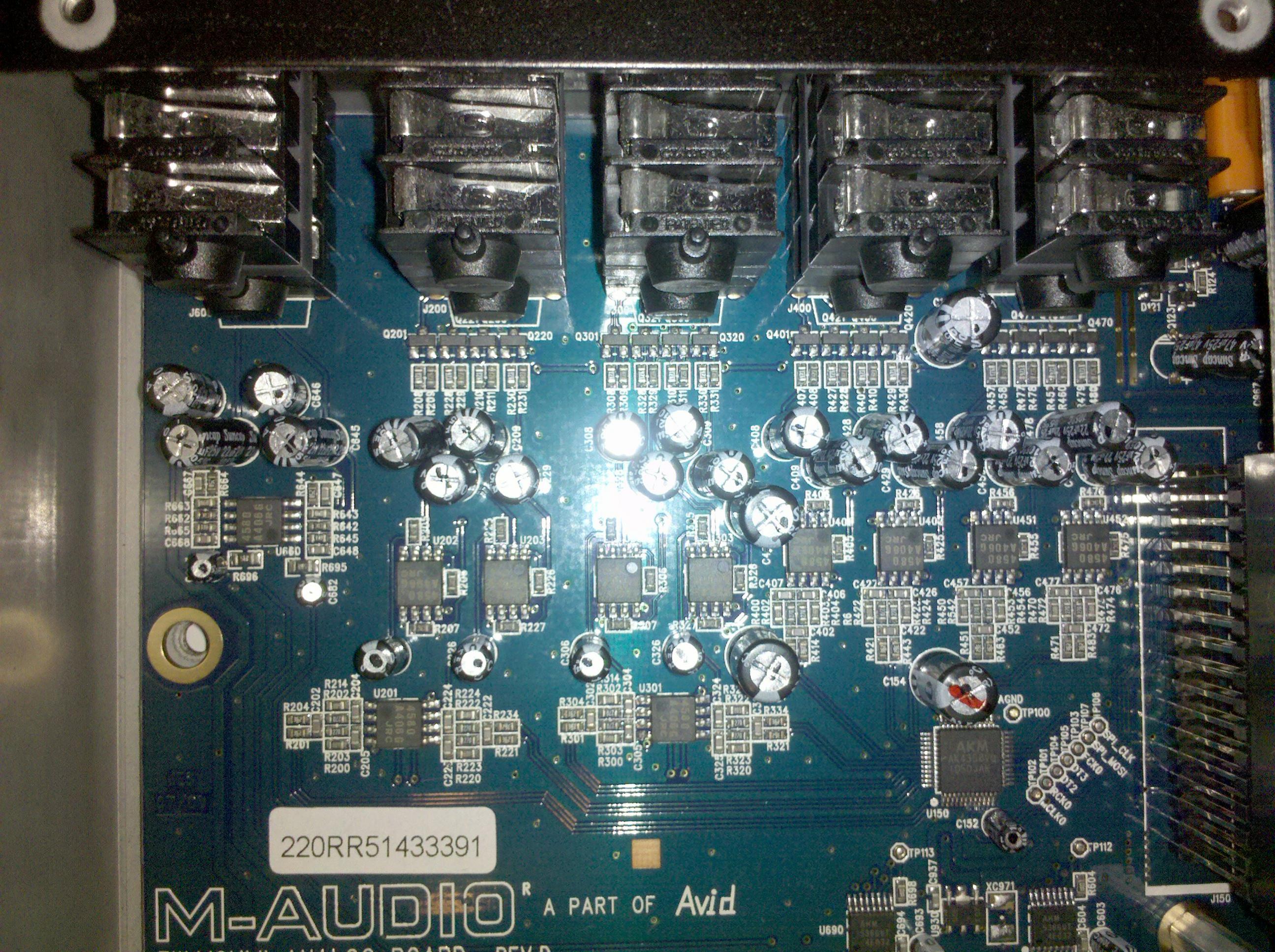

Hello to the whole diyAudio community,my name is Antonio or Toni and i'm looking for some help/advice on how to swap out i think they are op amps in my M Audio Profire 610. I would like to know how i can get them out without damaging anything,what op amps are good to replace the one i have for better sound without burning anything up lol. Any help will be appreciated to the up most !!! I posted some pictures so you can see what kind they are.
The 4580 is a "cooking grade" dual opamp.
Unless you have access to a scope and can check stability of any swaps,
http://www.diyaudio.com/forums/anal...u-have-checked-see-its-stable-havent-you.html
then you have to play safe and go for device that are the least likely to cause problems.
I would say something like the OPA2134 FET type could be worth trying. It's excellent sonically and is pretty docile in use.
Seconded. I've done some pretty ugly things to the 134 series and never had stability issues yet.

Before you go to the effort, do you have a schematic? It is helpful to know how the op-amp is used in the circuit. If it is simply being used as a unity gain buffer then swapping it out will not change the sound enough to matter.
What section of the 610 are you modifying? I would NOT touch the mic preamps. They are quite good already, Good enough for use in profesional level recording.
If these op-amps are driving the monitor outputs then "maybe" it is worth it depending again on how they are used.

I'd add to the above that you'd be nuts to do this without a schematic. Otherwise you don't even know if the op-amp is in the signal path or if it is which signal path. This box has a high impedance guitar input. If you changeout an op amp there it will not make a bit of difference to the stereo playback. Don't know it a guitar player would hear the difference, most have pretty high noise floors

It cost me about 20$ for ICs and other stuff.
I changed all opamps to ne5532, except rear inputs: rear input is opa2132; biased all opamps' to class A via precision resistors, shunted all electrolite caps with small polypropylenes, increased caps in power rails, and boosted headphones amps changing feedback resistors.
