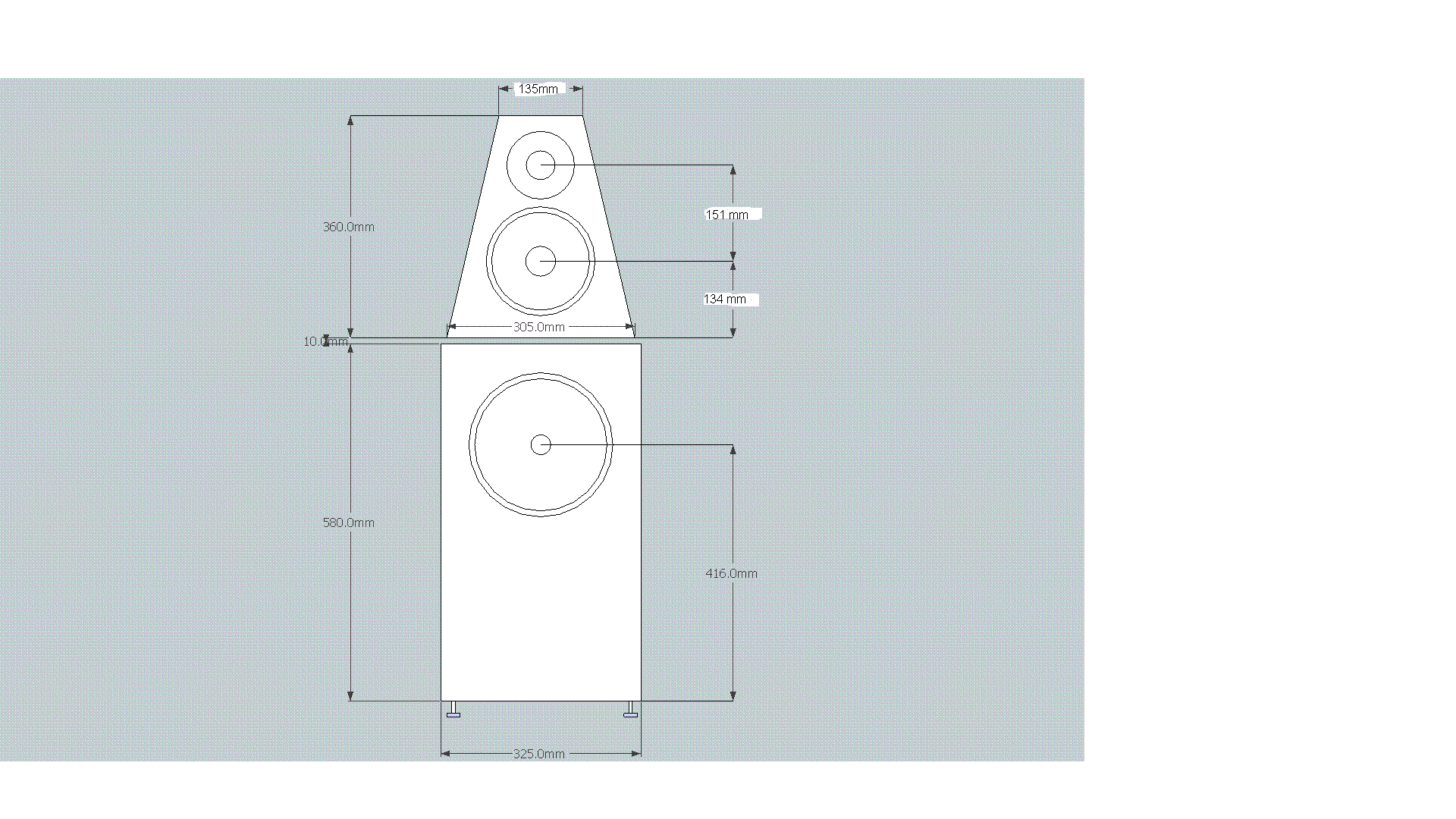

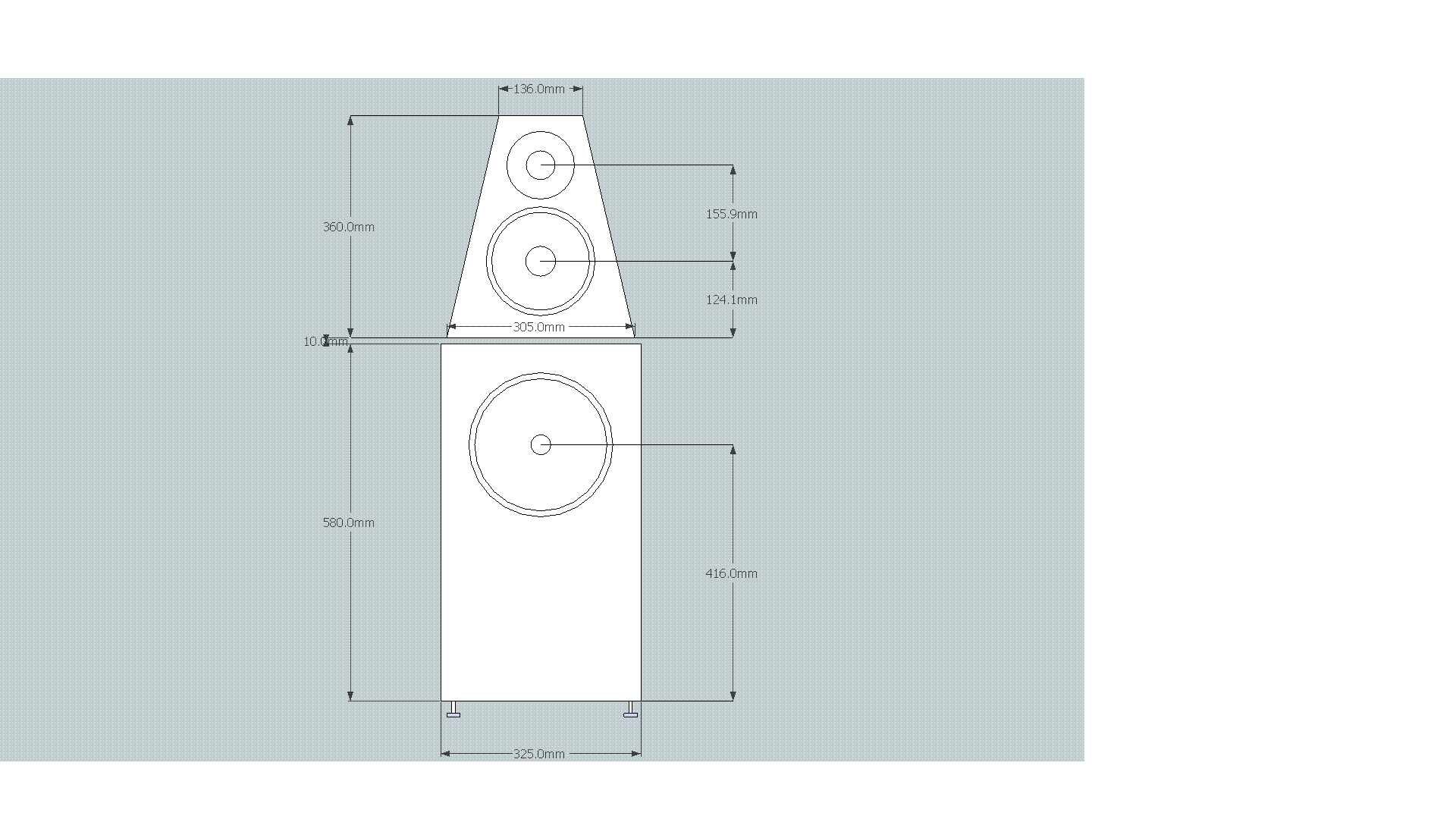

Box 2 ways dimensions:
Height 36cm
Width 30.5cm & 13.6cm
Depth 38cm
Woofer box dimensions suggestion MDF thickness 2.2cm:
Height 58cm
Width 32.5cm
Depth 58cm
Volume 80.7 liters

I can left only 40cm from rear wall...... distance between speakers & listening position is 3 meters

Actual distance of separation between speakers 2,4 meters
I can left only 40cm from rear wall If I do so the new distance between speakers & listening position is 3 meters
Are these room measures OK?
Ok, that's much better.
If the speaker is 58cm deep and you have 40cm space to the back wall, then the front of the speaker is pretty much 1m away from the wall. Seating distance is now 3m which is great. Sounds like you had planned to have the speakers *way* out into the room before. So this is good. It leaves you with some room to play with when you get around to setting them up.

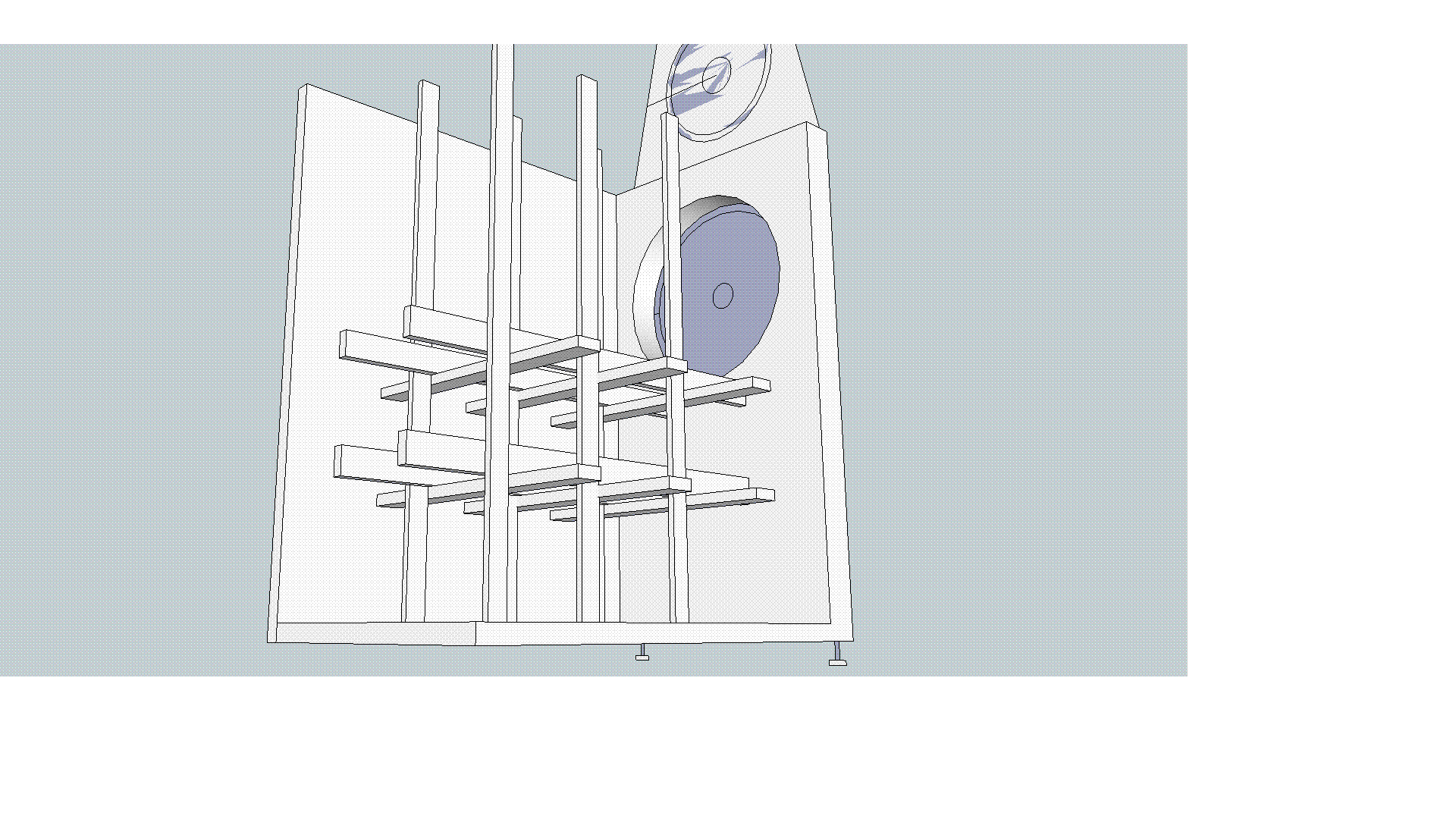

Thanks guys, there is a way much simple than Matrix to bracing the woofer cab?
Something like the this link Cabinet design?
Frequently the best way of doing things is also the hardest. Matrix bracing definitely requires more work and material but produces a very non-resonant cabinet.
The cross bracing in your link is a lot easier but results in very large panel areas that are unbraced and therefore free to resonate. This is still a good method though if you use a lot more pieces of wood in all 3 dimensions and glue them together where each set of 3 crosses. Essentially, it becomes a different type of matrix system, like below. That's just a partial representation to give you an idea. Still a lot of work. And there are still actually large panel areas unbraced. Personally, I think matrix plus a few strategic cross braces would be best. Lots of other opinions out there though.

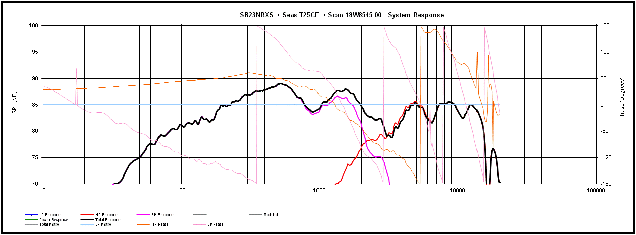

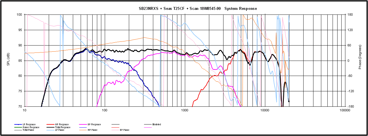

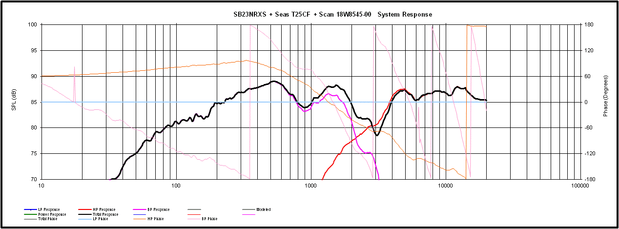

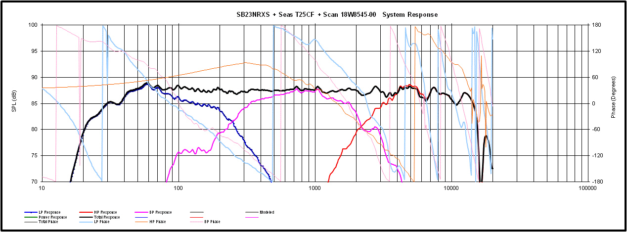

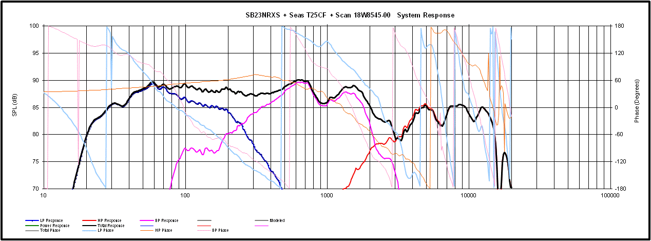

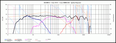

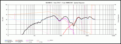

Ok Felipe, here are some graphs for you.
Simulations are based on a 3m listening distance with the tweeter at about ear height. Dimensions and driver positioning are based on the last diagram you posted. For the woofer, I have only used about 3dB of baffle step compensation. In your room, it may need more or less. The mid is modeled in a sealed cab of 10L. The woofer in 75L tuned to 26Hz.
I used a reliable 3rd party (Zaph) for measurements of the tweeter and woofer, but had to rely on ScanSpeak's data for the mid. That's a good company though and my experience is that their's are better than others so I'm hoping it's accurate.
The xo to the woofer is at about 250Hz since distortion is best below 300Hz.
Graph 1 is your current speaker as is.
Graph 2 is with your current xo plus new xo's for the woofer. Not very pretty.
Graph 3 is my best attempt re-working all xo points. That's looking better but the top end still isn't very smooth due to the baffle diffraction of your top cabinet.
Graph 4 then is the top cabinet with chamfered edges like I mentioned before and then the xo optimized for that. Clearly that is the smoothest response. Minimum impedance gets down to about 3ohm just at 1 point around 5000Hz. If your amp can drive 4ohm speakers then that will be fine.
So time to make some choices. Let me know which version you want to go with - top cabinet as is or with chamfered edges. You could leave it as is and place felt on the front of the baffle to control the diffraction (like Wilson Audio does), but I have no way of modelling that result so no way of knowing what to do with the xo for that situation.
Cheers

Perhaps as a test to know if my sims are matching reality, you might try your current xo with the 2.2ohm or the 3.3ohm resistor removed. This will bring the tweeter level up to about the same level as the mid. If you think it sounds better then we're good. If you think it sounds too bright, then we probably have a problem somewhere. Graph shows my sims with your current xo with the 3.3ohm removed.
