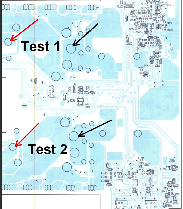

okay so ive plugged in the amp without any of the rectifiers and i got 0.84v on the RCA sheilds. i have not tried with the negative rectifiers back in. should i do so? also my fan has stopped working for some reason :S could it be because of no rectifiers? thanks
just reinstalled the negative rail rectifiers and i was getting 1.5v on the RCA shields. Fan now works lol. thanks

right with the rectifiers out and the digital meter set to 20m, Test 1 showed me "1" same as if the probes were open and Test 2 showed 13.05m ohms.
well when i originally tested them the digital meter was on the 200k setting not the 20m setting so it was 12k ohms. i had to use the 20m setting this time because the reading was too high to be read in the 200k setting.
Do any of the tabs of any of the outputs read anything near 0 ohms to the RCA shield ground, to the chassis ground or to any of the aluminum riser plates?
just to make sure, you want me to put the red probe onto a speaker output and the black probe onto the rca shields, chassic ground or the riser plates to see if the meter reads near 0ohms? sorry i didnt understand how you want me to test this? 🙂
Black probe on RCA shield ground, red probe on the tab of EVERY semiconductor with a metal tab. Does any read near 0 ohms? If so which one.
Black probe on chassis ground, red probe on the tab of EVERY semiconductor with a metal tab. Does any read near 0 ohms? If so which one.
Black probe on the aluminum riser plates (each one individually if they're not screwed tightly to the heatsink), red probe on the tab of EVERY semiconductor with a metal tab. Does any read near 0 ohms? If so which one.
sorry for the delay. ive just carried out the 3 tests and i found that the output transistors D501,502,503,504,505,506,507,508 all showed 0ohms
