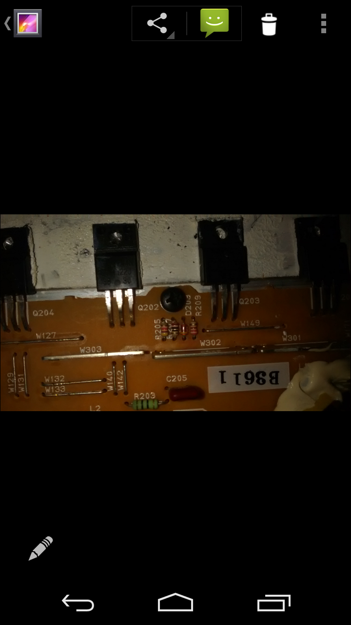

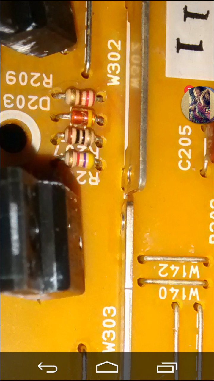

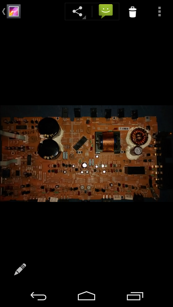

I have a Kac-7295 amp I need to fix. I had a small speaker on it to test it and it played. Once I ran my subs on it the resistor fried. I'm not sure what needs to be replaced please help. I own a multimeter also to test anything with some help. Would really appreciate it as I can't afford a new amp right now. I fix my car and test stuff in there and did my own fuel pump ect but this has me stumped. I will add pics
Questions ask please direct me with this. Again it powered up fine and worked on a 4 inch speaker but my 10 in made the resistor fry but it has been sitting for a long time before this. Thanks

Thanks for the reply. I am trying to upload pics now that I can see my thread but it asks for URL ? Is there a mobile version to add pics easily ? I will add many pics to show you , I also contacted Kenwood for a Schematic of the amp but no reply. I think it's a 10 ohm resistor that fried. There are 4 in a area together then 2 transistors then another 4 resistors and that's where they fried or one did I think but took out others around it. The row of them next to it are the same resistors I think as if there are 2 sets of 4 next to the row of transistors. Could be 4 transistors then 2 diods bit they look the same but have a dioide marking on them. I will keep trying to add pics as itss hard to explain. Really appreciate the help tho man, if I get it solved I can send you a few bucks on your PayPal for your time and help. I also believe I switched it to mono when I used the big woofer after it was on stereo while testing the small speaker idk if that caused an issue but I can't see how.

The burnt section appears to mirror the other section you took a pick of. You have matching resistors, then the diode, then 2 more resistors, and all the resistors appear to be same colors as their mirrored counterpart though some are harder to discern what color they are from pic.
I'd lift the leg of the good resistor and check it's value. Then try and get 2 replacements in the same range.
What you can also do is probe to get the value, write the colors down, use an online color chart, than see if you deciphered the colors correctly by comparing their supposed value to your meter. It should, if done correctly be within 5-15% depending on quality of resistor they used. Being that small, it's probably a 1/4w or similar. as long as it's not intended to be some safety feature i.e. burns out to save other components (I don't know enough about this to be honest) from destruction, I imagine you can increase it's wattage rating, especially if this was a design oversight they fixed in a later revision. (when it costs $0.05 between "it'll work and next better part, X 150k units, that 0.05 adds up quickly)
I'd replace both to be safe, and see if amplifier works or not before dumping more money into it.

This is likely a 729S, not a 7295.
The resistor is in the pulldown circuit for the power supply FETs. The FETs (at least one) have almost certainly failed. R208 is a 10 ohm resistor. The diode is a standard switching diode (not a zener).
You need to pull the two PS FETs that are being driven by this part of the drive circuit and check them.
