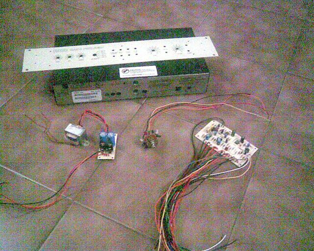

Photo.
Sorry for the low quality, I´m waiting to get my camera back were I have better quality images, and to get a photo of the finished pre-amp.
The power supply is on the left, then the Mid select, and the main PCB. I used a case from a junked satelite receiver, the faceplate is aluminum, painted and silk-screened. In fact, at least 95% of everything including parts, case, etc. is recicled from junked TV's, radios, etc. I only bought the Jfet's, two knobs and the transformer. 🙂

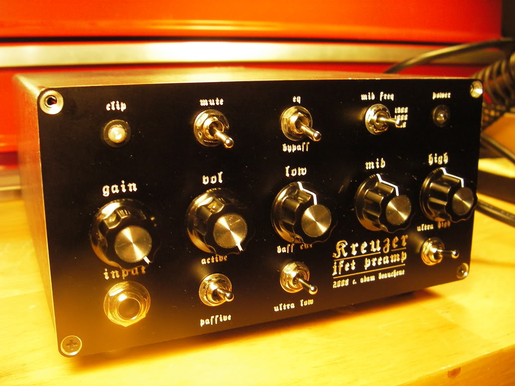

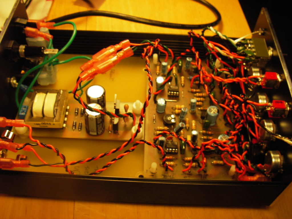

Hey folks,
I'm finishing up this preamp, and I'm running into the same problem. I determined the drain voltage using the 'quick and dirty' method on the site. I assume you go voltage/amperage=resistance, but what amperage do you use? The max the power supply puts out, or measure it off the 'quick n dirty' circuit, or? Or is there a different way to do it?
This is my first attempt at building any audio equipment from scratch, so please bear with me. (I built a bass a few months ago, it worked out well, now I'm doing an amp to match.) Preview:
Sorry for reviving an old thread.
I'm confused with the Pre and Post pads. they have their own ground. is it safe to assume that it means that you can select between EQ on or off with it? An EQ bypass(judging from the picture above)? If so how do I wire the SPST? I'm assuming connect both ground to center pole and PRE and POST to the remaining 2 poles...
Nice build BTW barnaclebeau..
