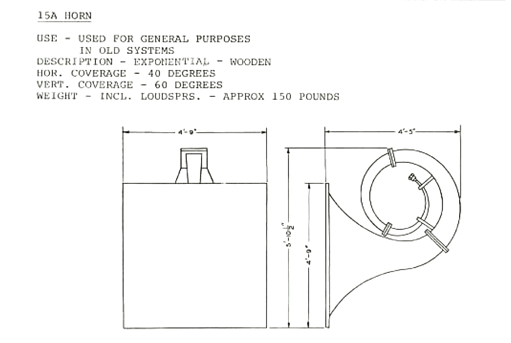

I see my mistake now. Thanks for posting you numbers as that clears things up.
The plan I was going by says the mouth size is 51.6" Since no other decimal inches are used, I took this to mean 5'|6". I should have known better, as I didn't remember the mouth being that large. So I'm recalculating. Other drawings show close to this, like 4'9" or 57" Could the blueprint mean 56"? Quick, who has an original to measure? 😀
So far a 14 foot expo looks a little narrow compared to the 15A, especially at 69" which is the beginning of the wooden section.
However I did recently find that if a length of 14 feet is used, with a mouth 5.5x5.5 ft wide, then a Le Cleac'h profile T=0.5 with a 1" throat comes very close. 55Hz to get the length. At least Hornresp exports a profile that comes close to the drawings. I found that exponential flared too fast in the throat.

Thanks. Yes I did use 0.7" diameter start for the throat. It's the area at the entrance to the wood section that I can't reconcile. It doesn't seem to fit into an expansion that I can generate, but I'll keep working on it.
What about mouth size? Is it 51.6" or 56"?

Ah, never mind. If the mouth is indeed 51.6 inches each side, then your blueprint numbers line up with a 14 foot exponential horn almost perfectly. It is indeed an Expo horn. Sorry for the confusion.
It's nice to have info straight from the source. I appreciate it! :checked:
Excellent! A very good match indeed, probably within the errors from slide rules, log tables and fractional inch dimensions!
Yes close enough for a practical build. It was fun to run the numbers and I thank you for them. For me at least, the numbers show that it is definitively a pure exponential horn.
Thanks also to HornResp for making this fairly easy.

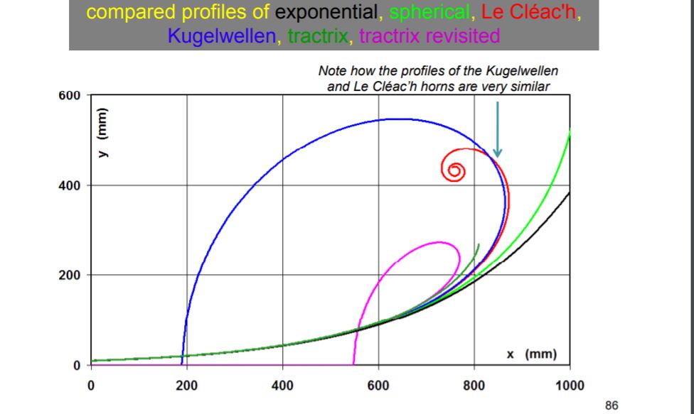

You are asking the expansion eqution of the WE horn. The first quarter wavelength is forcibly exponential. The quarter wavelength is where the section area is multiplied by 23 or the diameter is about 5 times the throat. The curves bellow from Le Céac'h book shows overlaid of different curves of more than quarter wavelengths.
attachment.php
You can see that at 450mm where the radius is about 5 times the throat all the curves coincide with that of the exponential. What happens further which curve to follow depends upon your driver. At low frequencies the diaphragm doesnlt break up and starts moving in piston. The impedance changes and the expansion needs to adept accordingly or else the sound will be brighter if opening too fast or darker if too slow.
