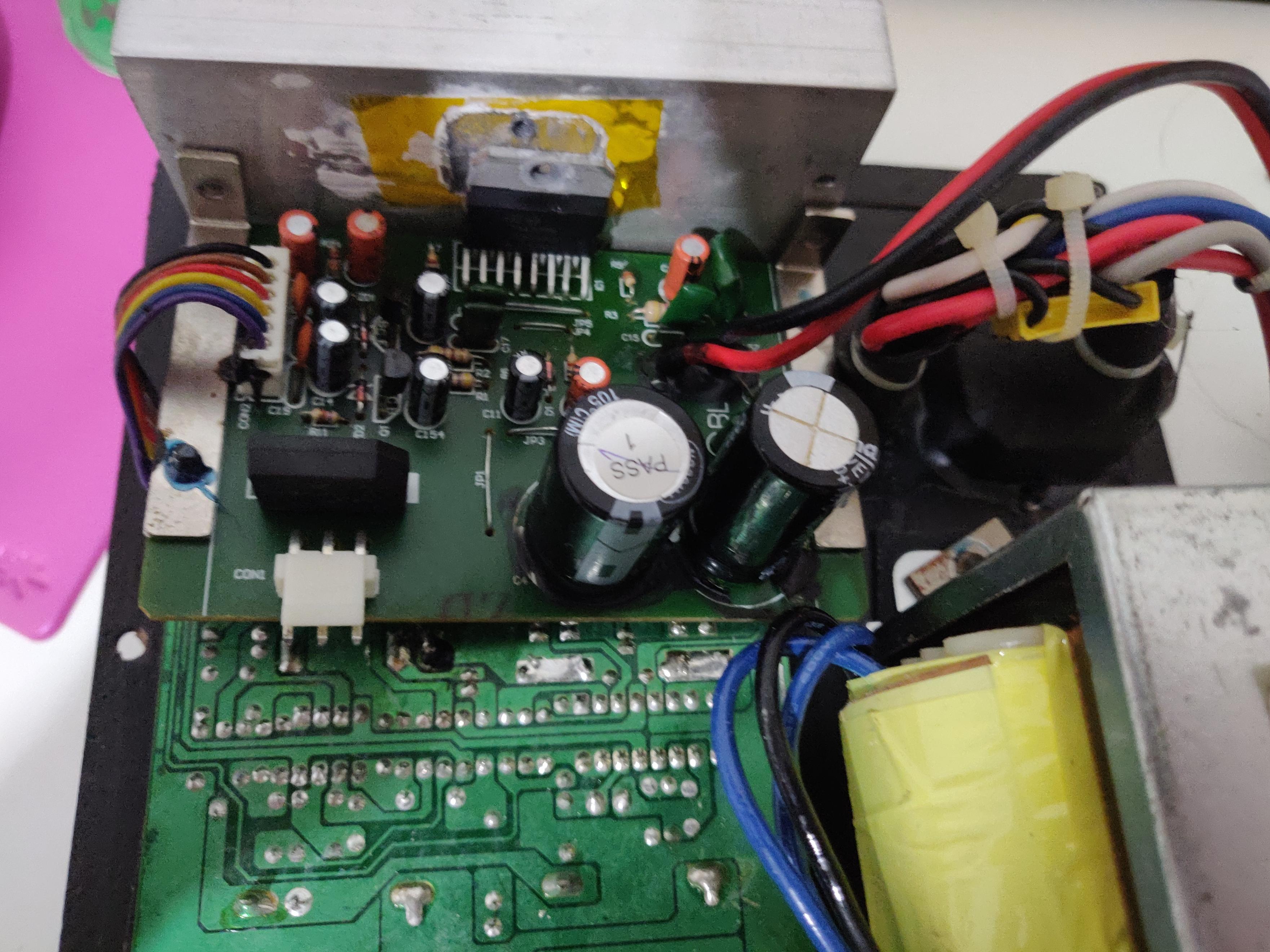

Hi all,
I am currently trying to fix a sub that i got and i think that i ruined the amplifier board.
I tried to look for replacment and i did not find any.
Tried to contact the manufacturer but he refuse to provide one.
The board is based on Tda7294 chip,
The attached image is the board that i want to replace.
Can anyone please advise?
Thanks in advance

That amplifier board doesn't look too "ruined" to me (no holes burned into it or anything), what's wrong with it apart from possibly a bad TDA? I only spot some suspicious black mounting glue, that stuff will have to go ASAP and parts covered by it inspected for corrosion / replaced if necessary.
The issue is in the other side,
The connections of the tda gone bad, some of them lost the connection and only plastic was left, i manage to do sove override , but still not working, it is no more blowing fuses but it is just stuck in stand-by mode

The board was poorly assembled, and it overheated. It was probably not adequately designed in the first place.

Also, unlike other popular chips, some of the TDA chips will burn up when the leads start separating from the circuit board. It depends on which leads come up first. That's because some TDA chips have separate leads for the power supply to the output stage. If you power up the driver stages first, it will smoke one of the output devices. The purpose is so you can apply s higher supply voltage to the driver stages, allowing the MOSFETS to be driven closer to saturation.
And TDA chips aren't that good for hi-fi anyway, because they have rising distortion with frequency. They're a logical choice for a cheap subwoofer though. They can be easily paralleled without a problem, unlike popular BJT chips. Some of them are designed to be paralleled. So with a bridge/parallel circuit, you could get a lot of power for real cheap.
Its probably the TDA as not much else to go wrong.
Unless power supply died ?
Cut off TDA pins as high up as possible then heat the pins up and grab quick with long nose pliers and pull them out. Not the easiest of jobs but I have done them without too much grief.
