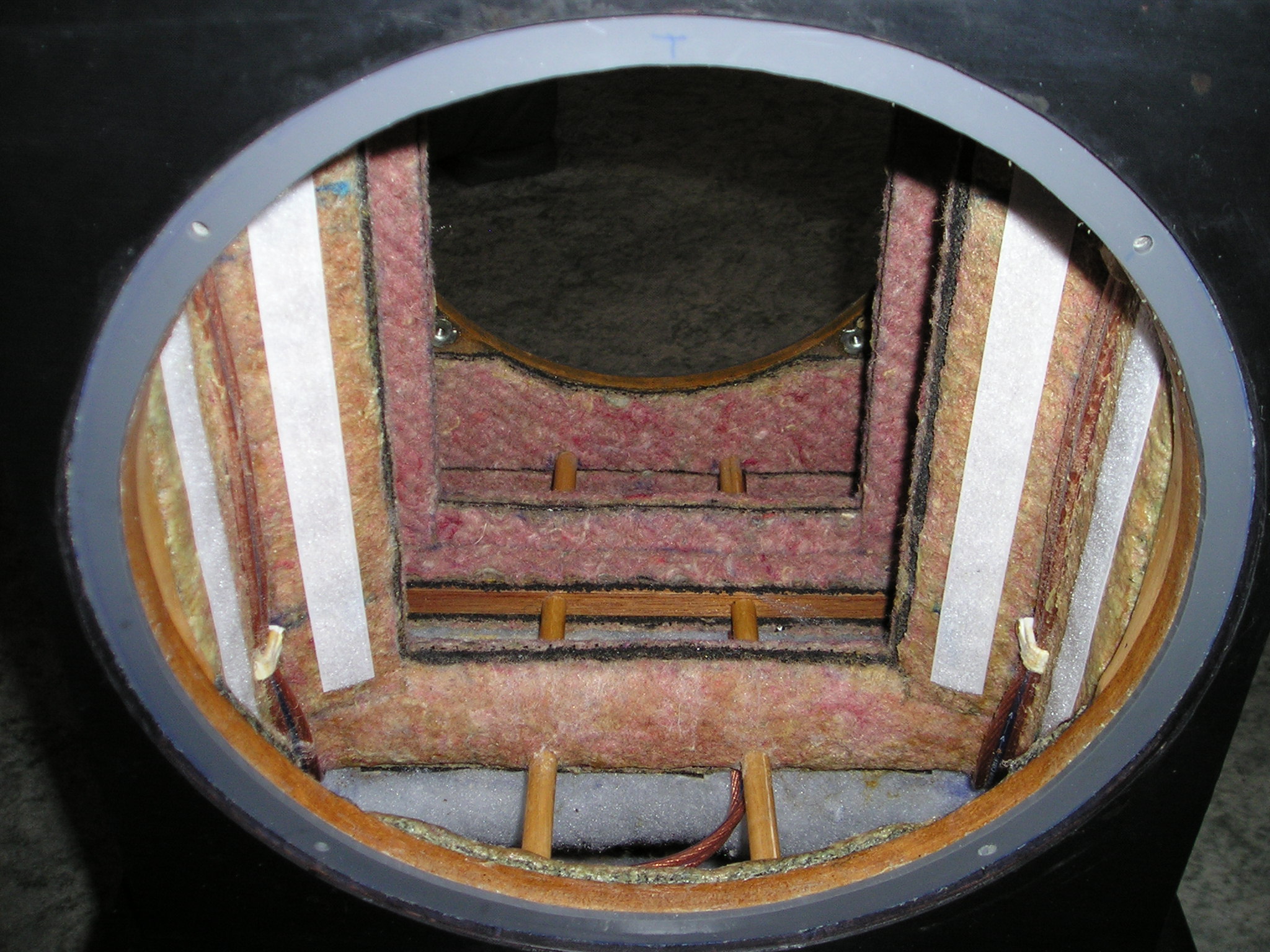

Personally I prefer to use dowel (rod) strategically placed, by ear, it can be moved around if tight fitting, and when the good places are found PVA'd into place. It is easier than cutting your obolid shapes, and multiple pieces can be used with a minimal loss of volume. You could consider corner bracing with Scotia, but that is labour intensive.
Thanks, what thickness rod do you prefer to use?

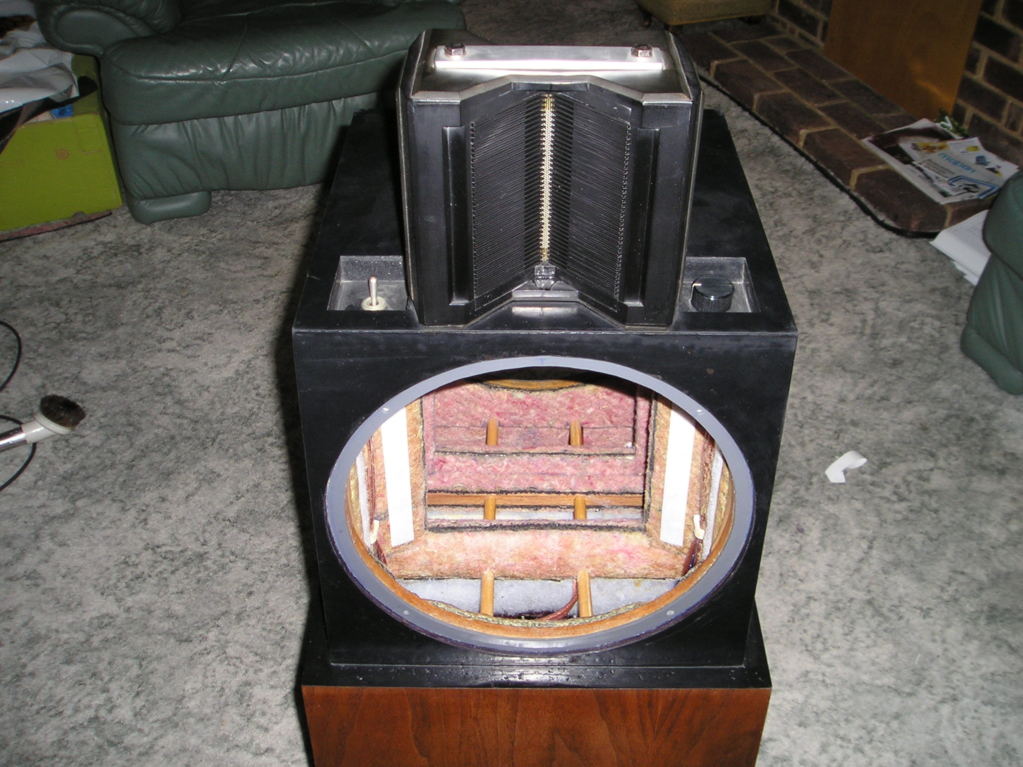

I used about 1/2" for front to back as below, but I remember seeing Spendor BC3s with a broom handle glued in from side to side, and right through the side walls which was ugly and unnecessary.

I cannot work out what that horizontal in your second picture is, or is meant to do.
Front to back dowels are effective where the cabinet is most likely to flex, ie in the middle near the woofer cut-out.
Just 'suck it and see' using knuckle rap and the ear to determine deadness.
