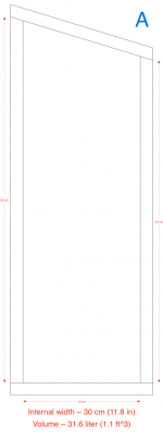

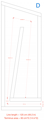

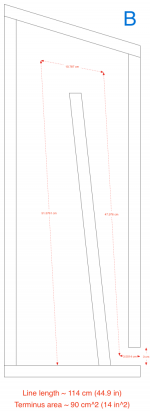

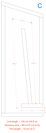

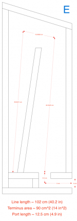

I used Martin King's software, the only modeling software I use. By using Zaph's T/S measurements for this driver, I knew from its highish Qts and lots and lots of TL modeling experience, the tuning frequency would likely need to be below 35 Hz. I started arbitrarily with a 60" line length and a 10:1 taper, which was close, but tweaked the taper a bit, then I adjusted the depth of the line to get an f3 of 40 Hz or a bit lower (going even lower would not be a good idea for only a single driver). I also located the driver at 20% of the line's length from the line's beginning because that's often preferred (but I have used the 33% location). With you wanting to emulate the Silent Speaker and place the driver towards the middle of the line, the results are not likely going to be nearly as good. I could reduce the line's volume while keeping the same length and taper ratio, but that will raise f3, and if the line's length is reduced, its taper ratio will need to be increased in order to achieve the same tuning frequency. I seldom even bother using published specs from manufacturers since so often they aren't highly representative of what you actually get (some are, however). Also, I don't even bother looking at how the line performs without any stuffing, and I know from experience that I will virtually always get good results with a stuffing density of 0.75 lb/ft3 (but I will vary from that as needed).
Okay, I quickly converted my model to a line length of 55" with the driver located at halfway down the line, and also reduced the line's volume to just over 40 liters. I increased the taper ratio a bit to ~13:1, with a starting area of 7.5" x 11" and an ending area of 7.5" x 0.875". System tuning is 30 Hz and the first 38" of the line is stuffed at 0.75 lb/ft3. I've attached the predicted system bass response and I think you'll agree it ain't pretty (I didn't spend much time trying to make it better, but it really won't matter all that much due to the driver's location in the line).

Thanks a lot Paul! May I ask what you modeled it with and how you came up with the length, S0 and SL? I only got Hornresp for modelling and simulation of T-Line. I started to make some drawings today but my line was shorter, 140cm (55"). I used an S0=506cm2 (yours 722cm2) and SL=92cm2 (yours 57cm2). I just wanted to keep the enclosure as compact as possible (total volume 39liter) and I ended up around 43Hz in Hornresp (using the manufactures spec. not Zaphs).
Ps. I had my woofer almost centered on the line (because I imagined a folded line with an up-firing speaker), I used no stuffing or XO resistance...

How can I get hold of this software? I can't thank you enough for running my figures through your software. It seems like there is quite a diff between it and Hornresp (and I lack the experience to transpose modeled values into reality).
How important is Qts for a TL (pros and cons for Qts > 0.4 and Qts < 0.4)?
Is a driver positioned in the middle of the line doomed then? I am just surprised that speakers like the Silent Speaker and Heed Enigma seems to work well (or maybe they could work even better if the driver was re-positioned)?

Martin used to provide his software to the DIY community, first as a freebie, then later with a small fee ($25 one time), but over the years commercial entities were using it for their manufactured speakers and without paying their one-time fee of $250, so Martin stopped providing it. Martin has a Group/Forum on Yahoo and has allowed some people who join up to get his software, but I don't know if he still is doing that.
Regarding Qts, I prefer working with drivers having a Qts in the range of 0.35 to 0.50, but lower and higher values sometimes work out acceptably to quite well (the CA18RLY using Zaph's measurements is a good example).
With a driver located in the middle of the line, usually the only type of TL that will perform decently is an ML-TQWT, but since it has an expanding area, it has to be far longer than other types of lines. But you really shouldn't have to locate the driver mid-line in order to come up with a good-performing TL that allows the outside of the box and the driver location to mimic the Silent Speaker. I'll get back to you later after I've done some more modeling.
