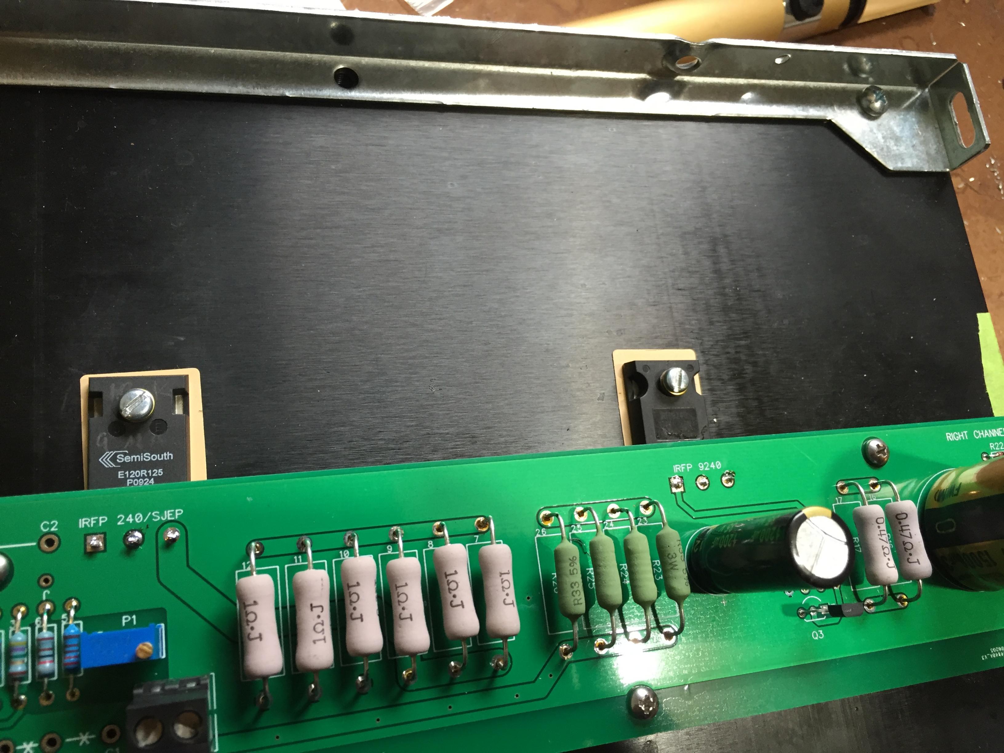

I only made 5 sets as it was minimum for PCB house and since F2 boards was not available anywhere to buy. I sold three of the spares to two and I am replacing them.
I don't want to annoy papa by making it in large quantities. If I have permission from papa to do it. Of course I am happy to make it.
Tubesguy if wants one for sure will get one for free. Just let me know.
Few have asked me over the time for them. They are long boards to even out heat distribution. That also make them expensive to ship internationally .
Well glad that I did not make and sold a lot.
And finally F2j singing
And corrected boards working as should be and listening to F2J for the first time.
Needtube many thanks for your timely comment and ZM as usual for comforting during the nerve racking trouble shooting times.

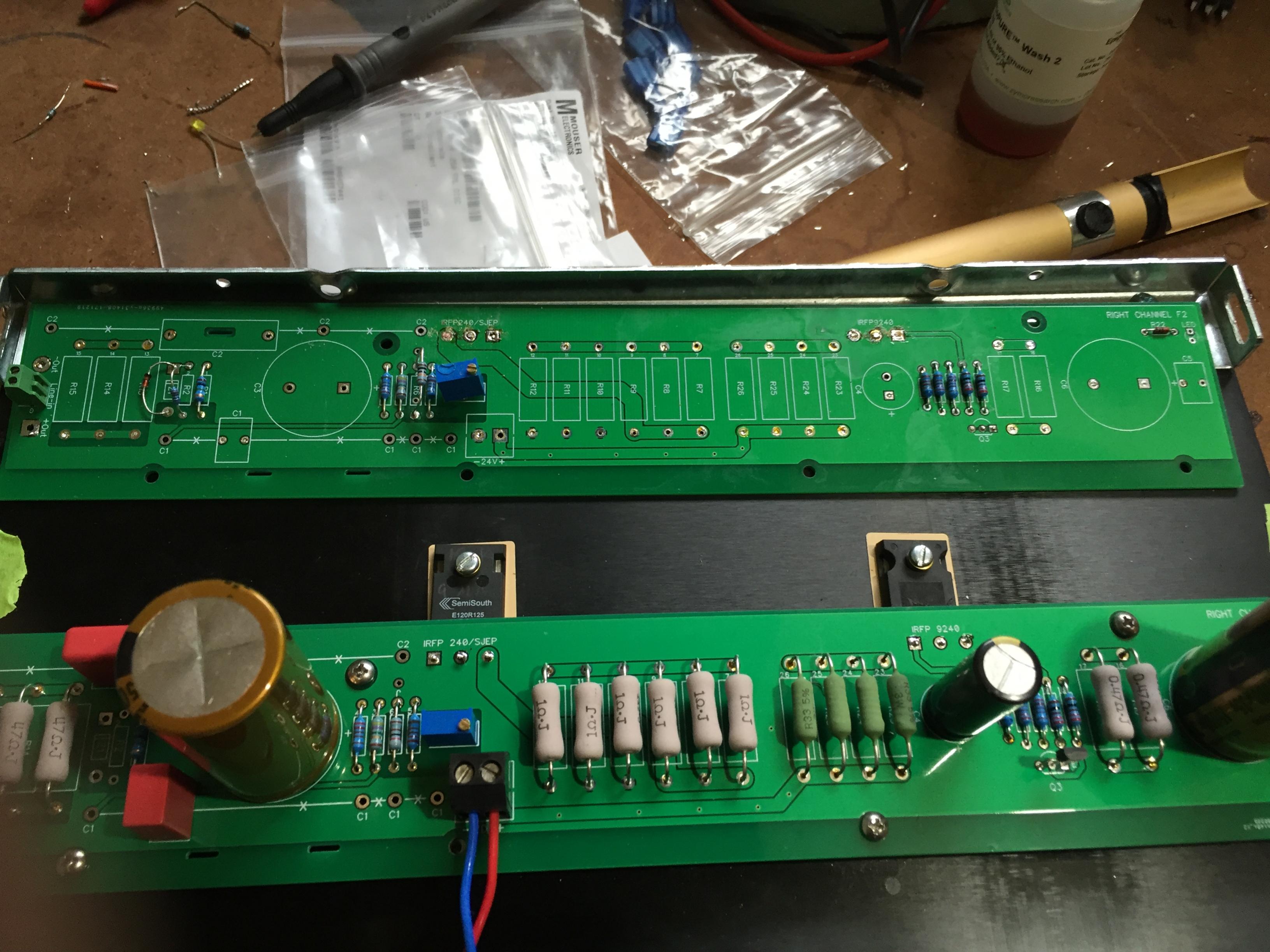

Bias adjustment
How to do bias adjustment . ZM told me before , is it with input signal applied or not without signal applied. I have no other tools than a ranging DMM and supply voltage is 22.2V.
I did it with input signal applied and neg prob at C3 caps positive pin and neg at supply ground and trimmed to a average voltage reading of 11V.0.
Just want to make sure I am doing it right.
sole setting , with P1, get approx. half PSU voltage at drain of Q1
with no signal , load or not irrelevant
ZM just to understand this better, when you use oscilloscope you will need to apply a signal at input to do the adjustment , am I right?
Also when biased amp is tied at half voltage so it can swing input signal voltage without clipping at bias point? So for 24 V supply bias at 12 V
So say my input signal voltage is 1.5 peak to peak AC it will make amplifier voltage swing above half supply voltage and hence exceed maximum voltage leading to clipping? So should I be biasing 12-0.75V which is 11.25V?
if you have a scope and signal gene , don't use brain (wrong) , just set for symmetrical clipping , and that's it
