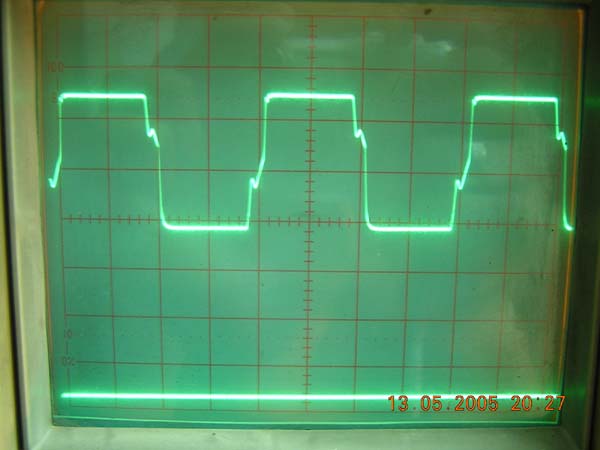

My freind and I built a smps to produce 240VDC 100mA and 6.3VDC 4A..
It's running at 40Khz using TL494 and IRF540N Mosfet.
I load the HT with a home 240V bulb rated 18W and the 6.3V o/p loaded with 4 real tubes (6N1P).
I have been powering up the circuit for about a week.. but the transformer core heat up after running it for 30mins..and its reaching up to 50degC... the waveform at the MOSFET drain is always monitored and it never changed at all...
Is the transformer core temp normal??
Attached is the waveform pic...
Thanks Jack... I m glad that you replied my query here....
Another thing that I forgot to mention is that all the sec winding is winded prior to winding the primary.... and the since the 6.3 is meant to supply around 4 amps, I wind it in bifilar method... and primary is (diy) litz wire.
The question is, can I use bifilar winding? Using litz in the sec makes the winding layer uneven.. thats why I tried the bifilar.
nothing wrong with bifilar, even better than single wire. Winding primary over secondary increases primary leakage inductance a bit, but then again no problem if your PS works fine. As long as your transformer is running cool, is properly isolated (required creepage distance along insulation tape layers) and your semiconductors don't fail you are okay. Only remaining problem might be electromagnetic interference issue, but if that's for your home use I wouldn't bother to much. If your TV and radio works fine you have no problem.

50degC is nothing to worry about. One normally would start a transformer design with a spec for maximum temperature rise. This is often set to 30 deg C, seldom more than 40 deg C, and is based on values established by the safety agencies UL, CE etc as follows:
If your transformer were to be subject to qualification to EN60950 or UL60950, the safety geezers would do a temperature measurement of the transformer at full load, by either a thermocouple or by measuring the winding resistance.
Then they calculate:
T(limit) = T(max) + T(measure) - T(max ambient)
Where T(measure) is the ambient temperature at which they took the trafo temp measurement, typically 20-22 deg C
T(max ambient) is the maximum ambient temperature at which you claim your product may be operated, typically 40 degC.
T(max) is an assigned maximum safety temperature of 100deg C (where temp is measured by winding resistance, 90 degC where it's measured by thermocouple)
T(limit) is the max temperature that they may measure during the test if the transformer is to pass EN60950.
Typically this gives us:
T(limit) = 100 + 22 - 40 = 82 deg C
ie a max permissable temp rise of 42 deg C above ambient.
But remember that:
1. The temp they measure is the temp of the winding - perversity dictates they will always measure the innermost winding which has the worst heat exchange with the ambient.
2. Your transformer design calcs - especially thermal estimations of convection based on transformer surface area - are ballpark only.
3. Your limit drops 10 deg C if they measure wioth TC's. Normally you can insist on winding resistance measurements, but there may be cases where this is not possible.
So nearly all transformer designers play safe and set a max temperature rise of 30 deg C above ambient.
I hope this missive was of interest.
