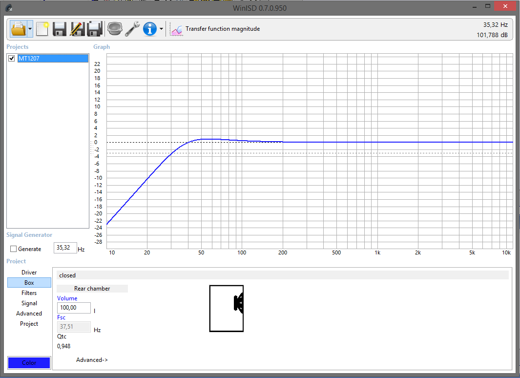

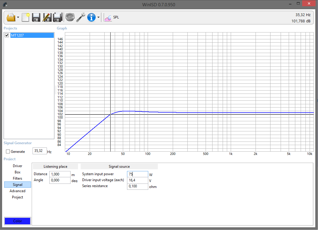

i did a quick sim in winisd with the given specs (wich are incosistent) and a 100L sealed should give you a 35hz on 102dB with this driver (mono box). That is very loud in a small space like you discribe and will be louder than you probally ever use. Set a pair there and you got 3dB extra. As for a sealed exact specs are not that critical, this could be a safe guess. But don't expect hi end hifi sound with this, this driver is not for that. But it will be very loud and low.

Are you sure you entered it right? I have a 98L vented enclosure, so to test I stuffed a hoodie into the port and lost much of my low bass. It's definitely not 102 dB...
You're right though, it's a pretty muddy-sounding sub. Transients are, as predicted, horrendous ;-;

I used the specs published here. But i can see that they are not consistent, and so probally not exact or right... ifyou want to be sure, you need to measure the driver.
