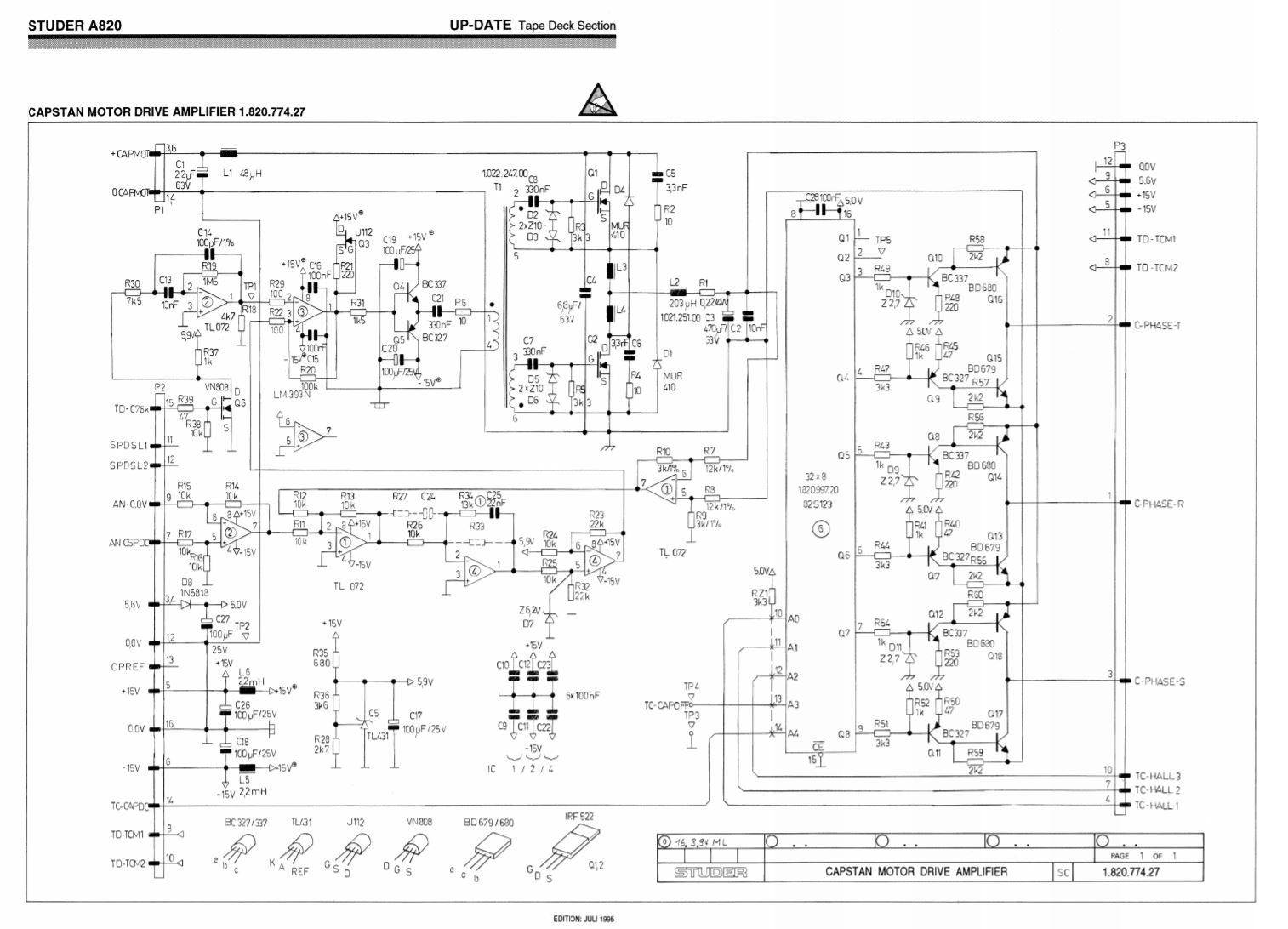

Here is a page from a Studer Tape recorder service manual, showing the Papst motor driven by a 3 phase supply:-

4 phase will be hard with only 3 wires. I guess it is possible to use airplanes on railtracks but it is more simple to fly with airplanes and use trains on railtracks.
If you would read the posts you would learn OP already has the described setup but unfortunately an unsuitable motor. Not all Aussenläufer are equal.
You are probably right (I haven’t read the links yet) and I was thinking of true 4 phase motors but it does not change the fact that this specific motor is very likely not suitable. Everything else may be layed out in details in fantastic designed electronic contraptions described in endless threads costing many hours and probably also much energy but in this case OP must look for another motor.
Yup.
