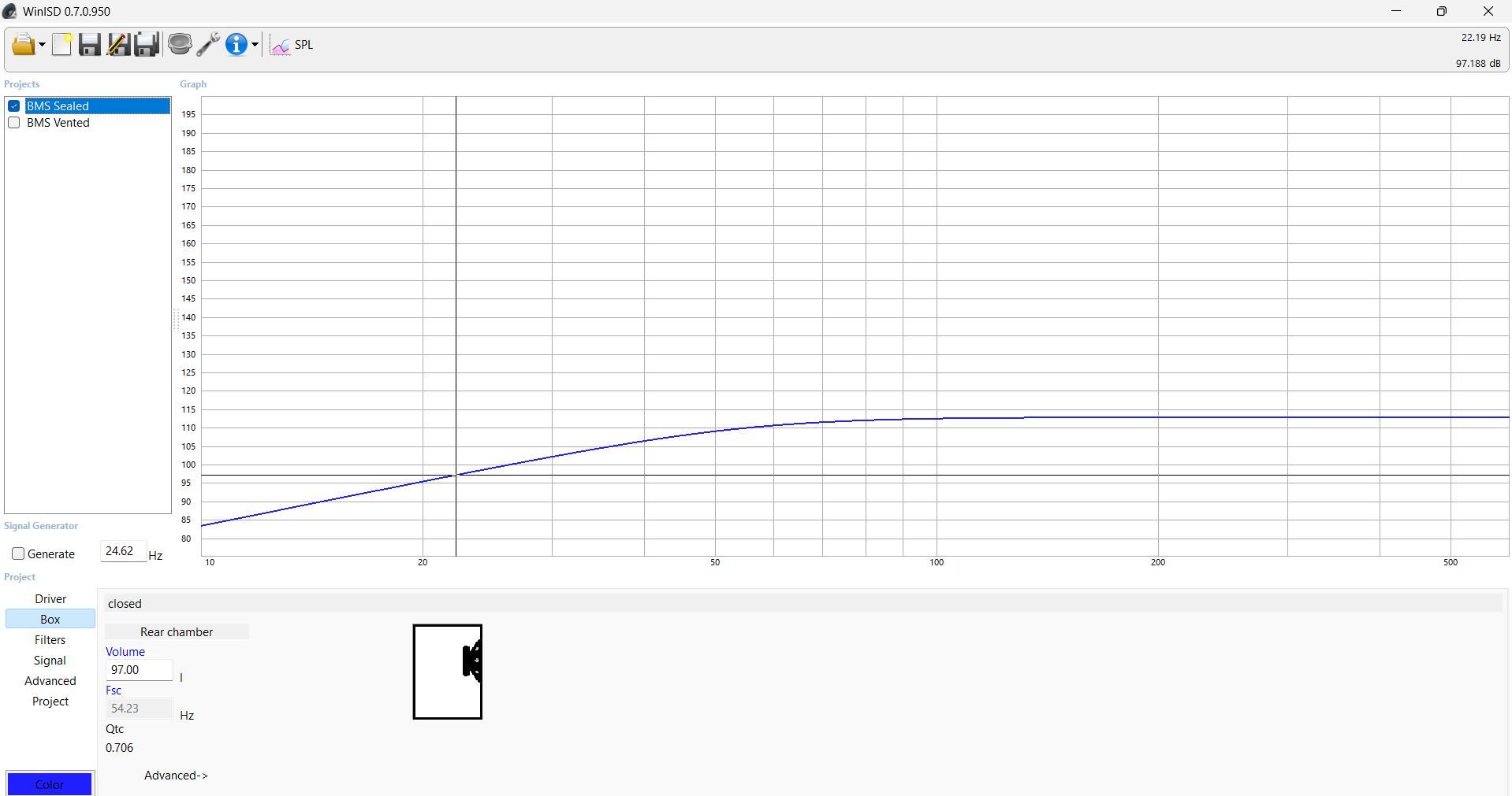

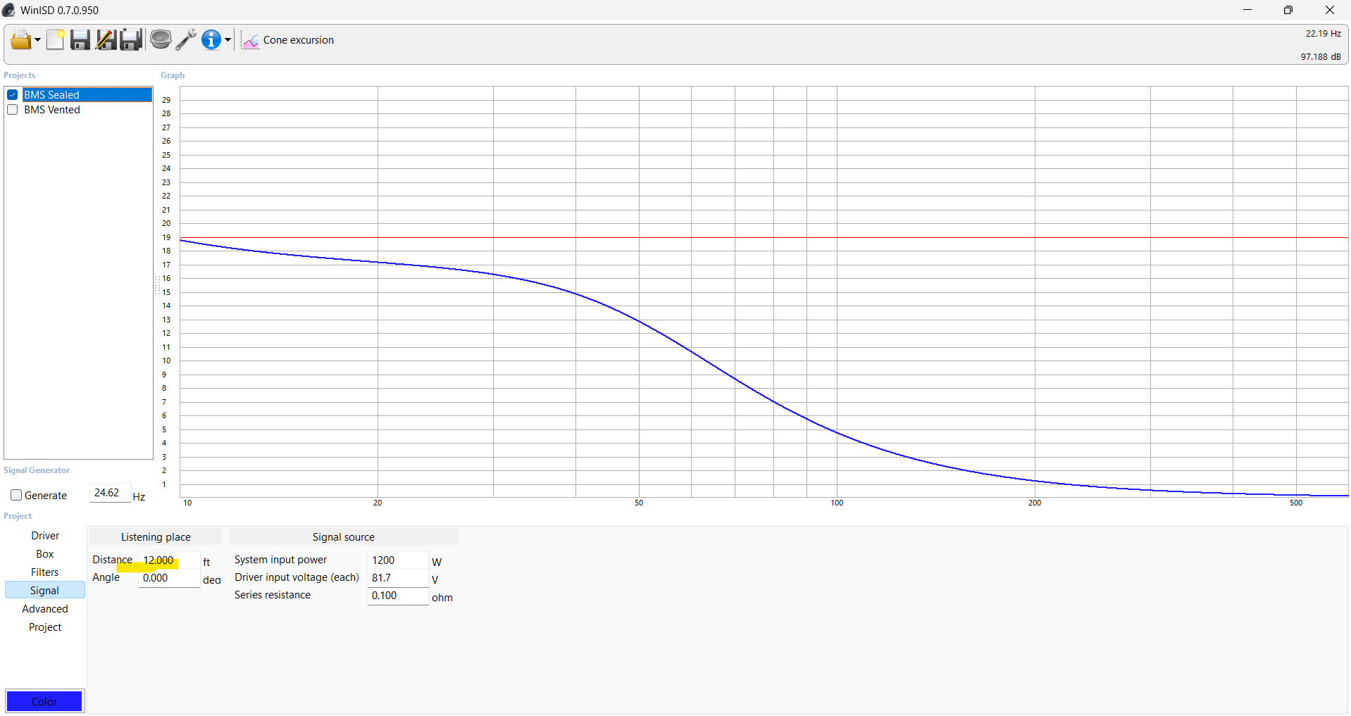

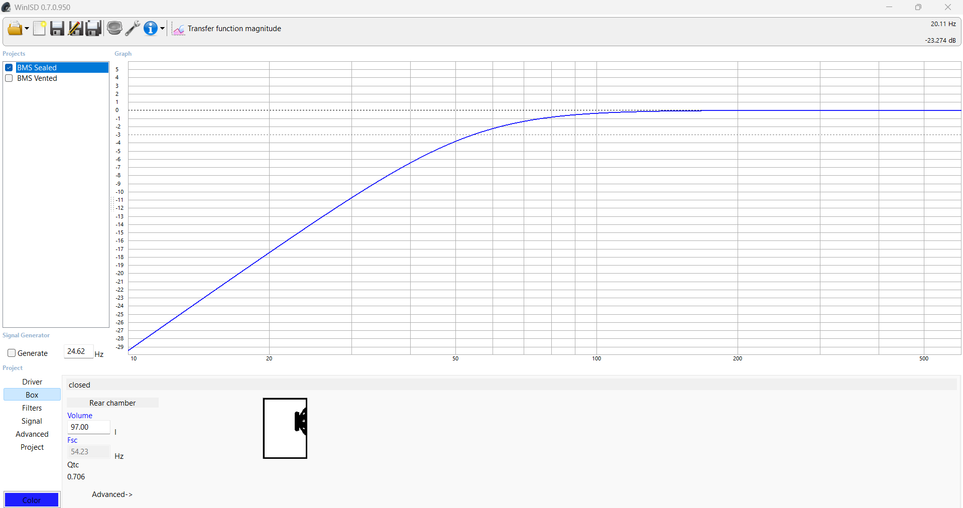

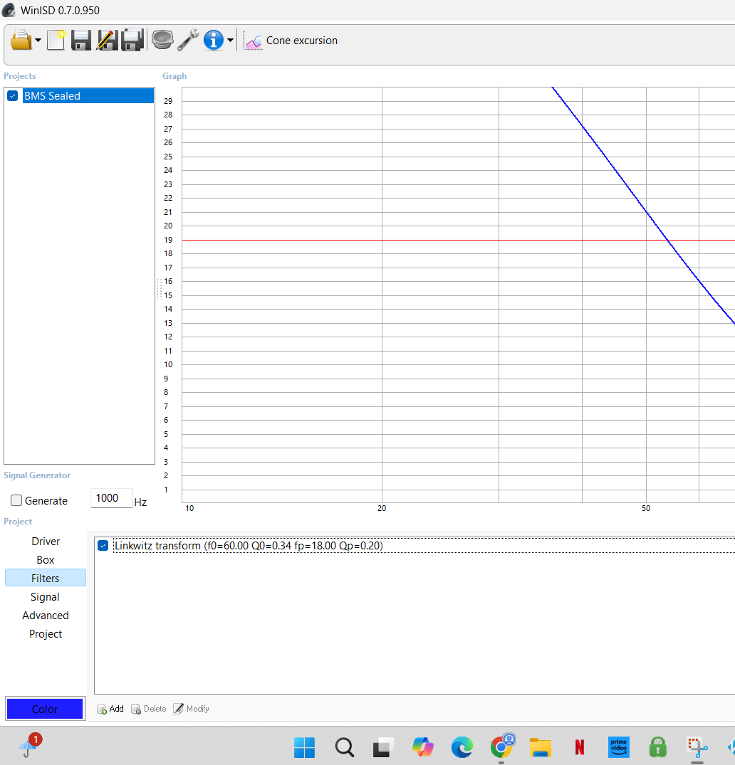

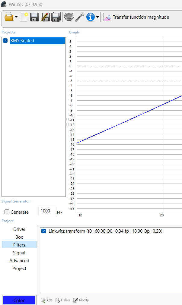

- WinISD is fun until it throws a “division by zero” tantrum. Can I really trust it to model things down to 20Hz?

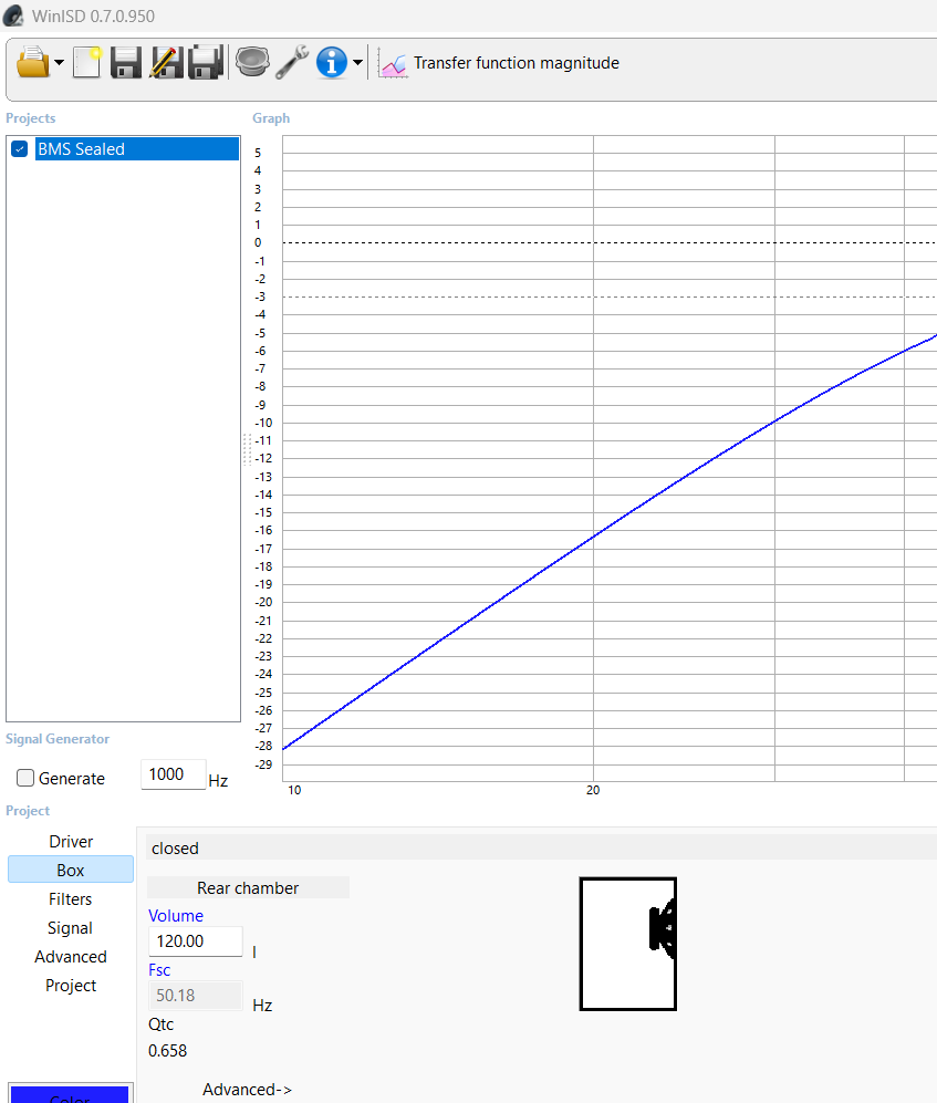

- And for designing Sealed do i need to depend Win ISD or i can go with the capacity details provided in OEM Site BMS says 150 Liter for Sealed Enclosure.

Yes, you can trust it when not malfunctioning.
Hornresp gives more simulation options.

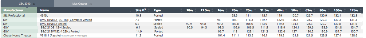

Not hard to beat the JBL 4645C ( 225L net, 25Hz Fb) using the 2242H, with only 9mm Xmax (linear excursion) using modern drivers.
Doubling excursion allows +6dB more output using four times the power.
The BMS 18N862 has 19mm excursion.
https://data-bass.com/systems/5c48bfc611126b0004ca12eb
The CEA-2010 test measures the (relatively) clean output of speakers, so they can be compared "apples to apples".
The BMS 18N862 has 12dB more output at 20Hz, +4dB at 25Hz in a smaller cabinet (also 25Hz Fb) than the 4645C.
At 1kHz +10dB sounds "twice as loud", at 20Hz only ~+4dB is required to sound twice as loud.
Note the 18N862 matches or exceeds the output of the B&C21" below 50Hz in a 175L (gross) sealed box.

3) Bigger sealed boxes require less power for the driver to reach Xmax, and require less EQ to flatten response. Volume reduction past 150L for the BMS 18N862 would probably use too much power to reach Xmax.

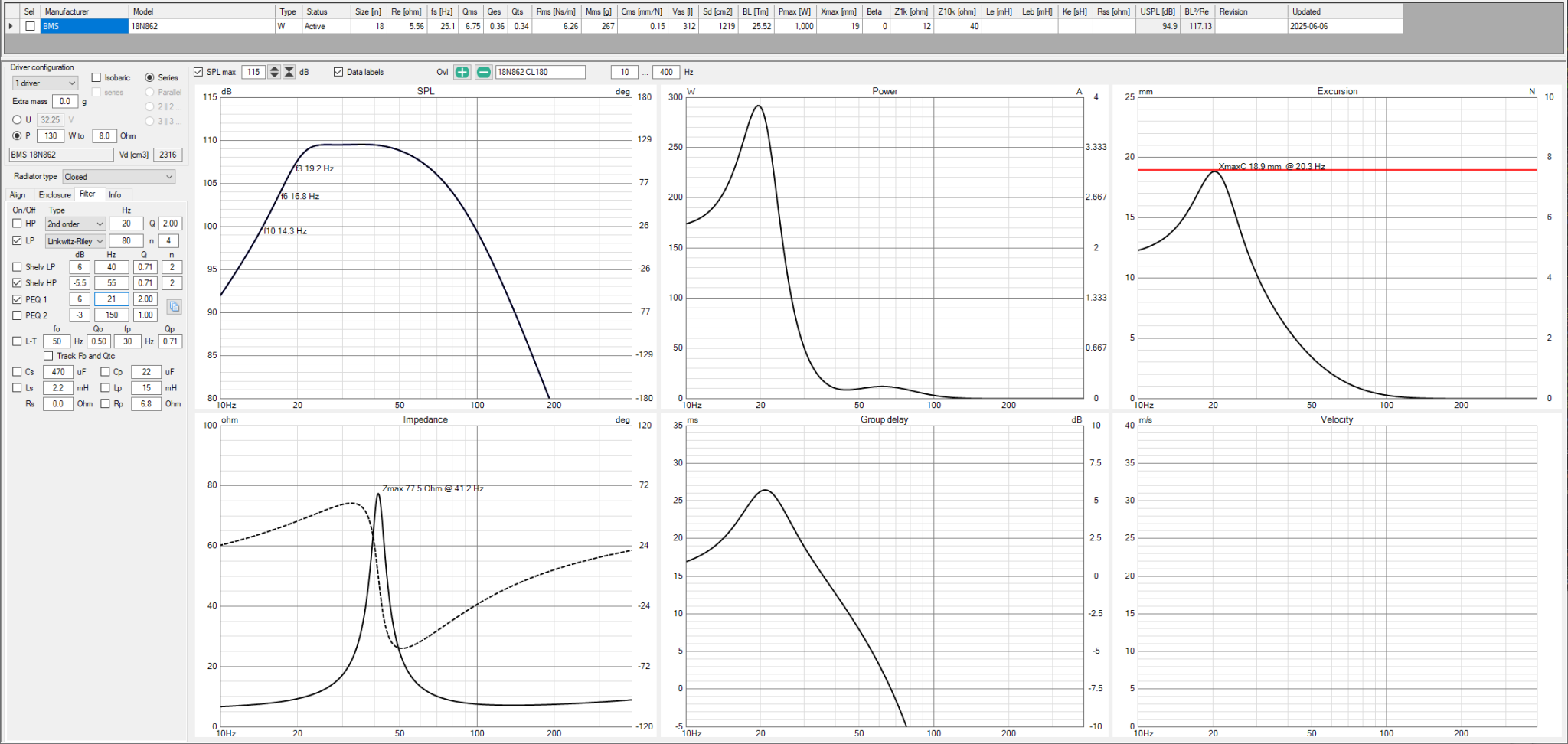

I've used VituixCAD to perform a simulation of the BMS 18N826 in a 180-litre sealed enclosure. The response curve is shown below. The F3 of the system is 19.2Hz, with peak Xmax achieved at around 20Hz. The maximum SPL in the passband is around 109dB. The response filtering includes:The BMS 18N862 has 12dB more output at 20Hz, +4dB at 25Hz in a smaller cabinet (also 25Hz Fb) than the 4645C.
- 4th-order 80-Hz Linkwitz–Riley low-pass filter.
- A shelf filter with –5.5dB of cut at high frequencies.
- Parametric EQ of +6dB at 21Hz with a Q=2.0.
WinISD has the personality of a caffeinated raccoon. Use OEM specs as a baseline. Don’t trust just the “recommended enclosure” blindly, model it.The past two weeks have been a black hole of DIY subwoofer obsession. With high-end audio gear costing more than a used car these days, I’ve started thinking—why not build my own
