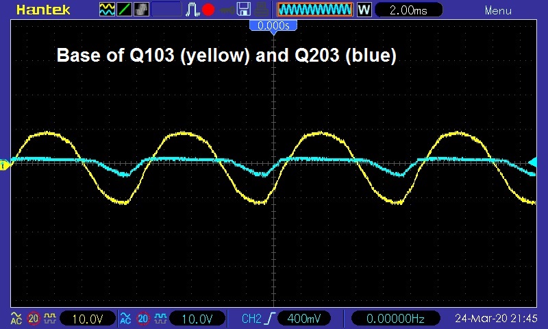

While testing the other (right) channel, I found another issue. I either missed this during initial diagnosis, or something got damaged during the repair. The output, with or without a load, clips well before reaching rail voltage. The clipping is equal on both the positive and negative side of the signal. Another symptom is that it appears the overall gain of the right channel is less than that of the left channel (for equal input signals). It's almost as if that channel has no gain, and the signal at the output terminal is merely the input signal fed via the feedback resistor (R244).
Tracing the signal through the design, and comparing the bad (right) channel to the good (left), I find the following differences:

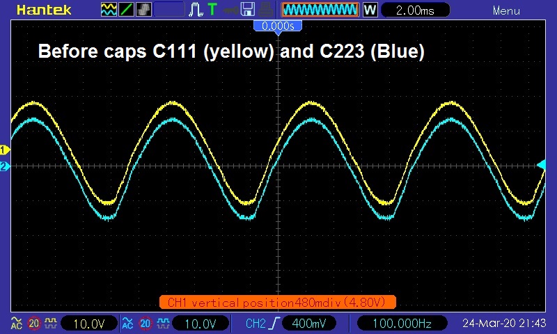

- good signal at the + side of C223 (matches the signal at C111)
- bad signal at the base of Q203

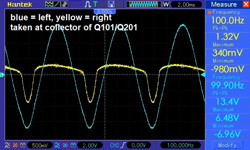

- bad signal at the collector of Q201

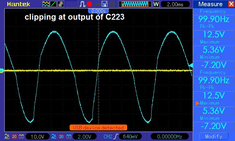

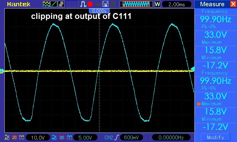

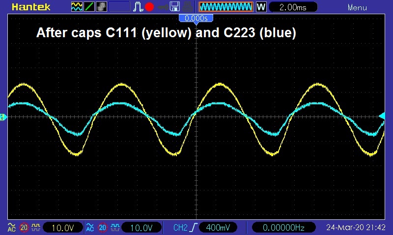

Are you saying that the signal is clipped on both sides of C223?
Well yes, but I expect it to clip on the input of C223 eventually (if the gain is too high). On the output of C223, it clips early, at +5v and -7v, and the signal does not look good (see image attached).

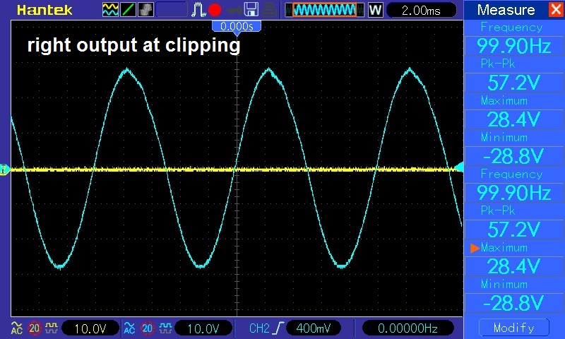

At what amplitude positive and negative, does it clip?
About +/-28v (see attached image). The rails are at +/-40v in this case.
I've attached a bunch of scope captures at the caps and transistor base.

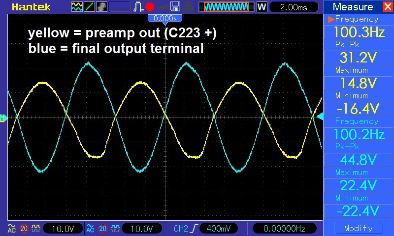

You have to understand that we're working 100% blind except for the information that you provide. We can't know what you expect to see. I needed to know if the clipping of the low-gain channel exactly mirrored the preamp signal.
The gain of the right channel depends on the components from the op-amps before the mode switch to the resistor R264 and also R244.
If the problem is precisely the same in all modes, the op-amps are likely OK. The switch, the caps or resistors would be suspect. It could also be a problem in the differential amp.
Are the voltages across the 33 ohm resistors the same in both differential amplifiers?
I totally understand.
They're very similar (see attached pic). When the preamp signal clips, the output clips (no earlier). The final output is about 1.43x the preamp signal.
Will check and report back.
In the bad channel, the voltage across all points of the 33 ohm resistors are the same (yellow wave in the attached image).
In other words, the emitters of Q202 and Q203, and the collector of Q201, have the yellow wave in the attached screenshot. The blue waveform is the equivalent signal in the good channel.
Does this point to Q201 being bad? (not allowing enough current through the differential amplifier?)

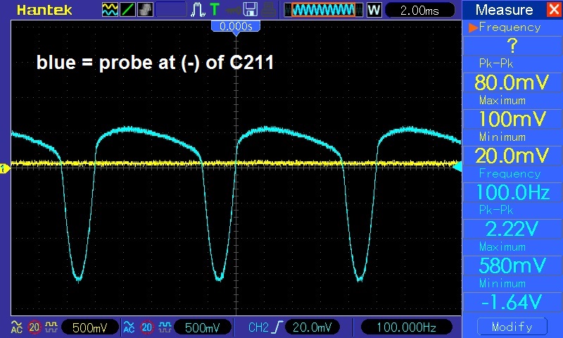

Is there absolutely no signal on both terminals of C211?
The signal on both terminals of C211 matches that of the signal on the emitters of Q202 and Q203 (picture attached).
You have a problem with the scope ground because one terminal of that capacitor is ground. The scope should see noting on that point.
Bear in mind that when things are right, you should see no signals on either of the base terminals of the 200 series channel. The 100 series channel is non-inverting. The 200 series channel is inverting. Like on an op-amp, if the input is to the inverting input and the non-inverting input is grounded, there will be no signal seen on either input.
It was because I had the scope's ground clip connected to the output's ground (ie, HV power supply ground), not the signal ground. Connecting to the signal ground produced a zero signal on the (+) side of C211, but still had a 'bad' signal on the (-) of C211.

I believe I've found the problem. After much troubleshooting of the signal feeding the differential amp circuit, it seems that C223 is faulty. Bypassing that cap results in the right channel outputting the same gain/level as the left channel (and same clip point).
