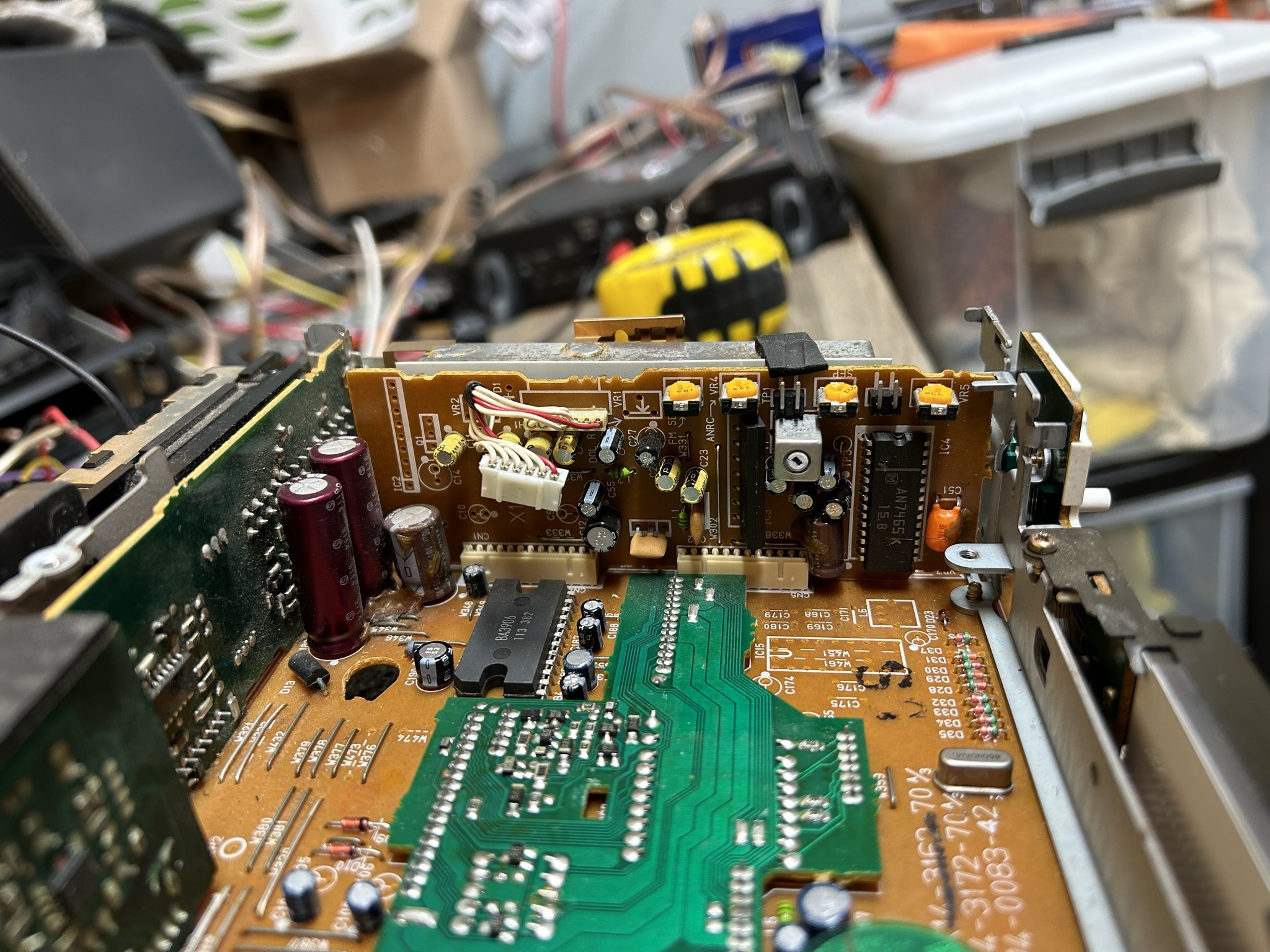

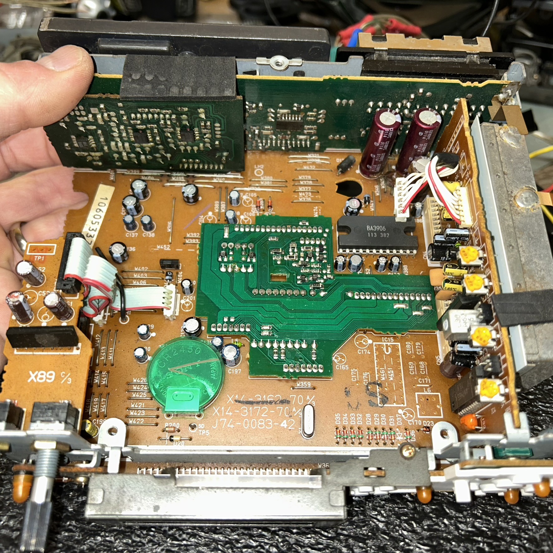

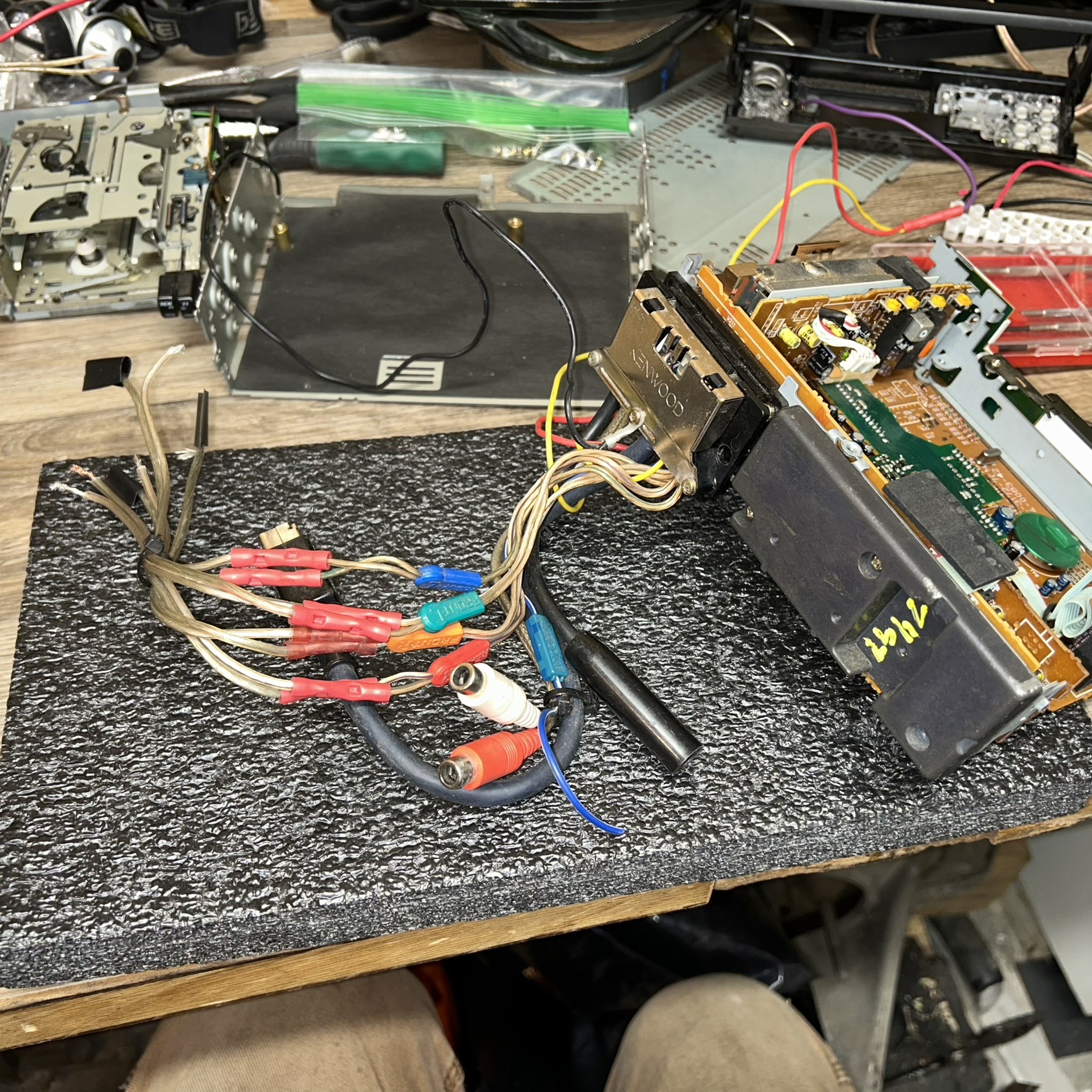

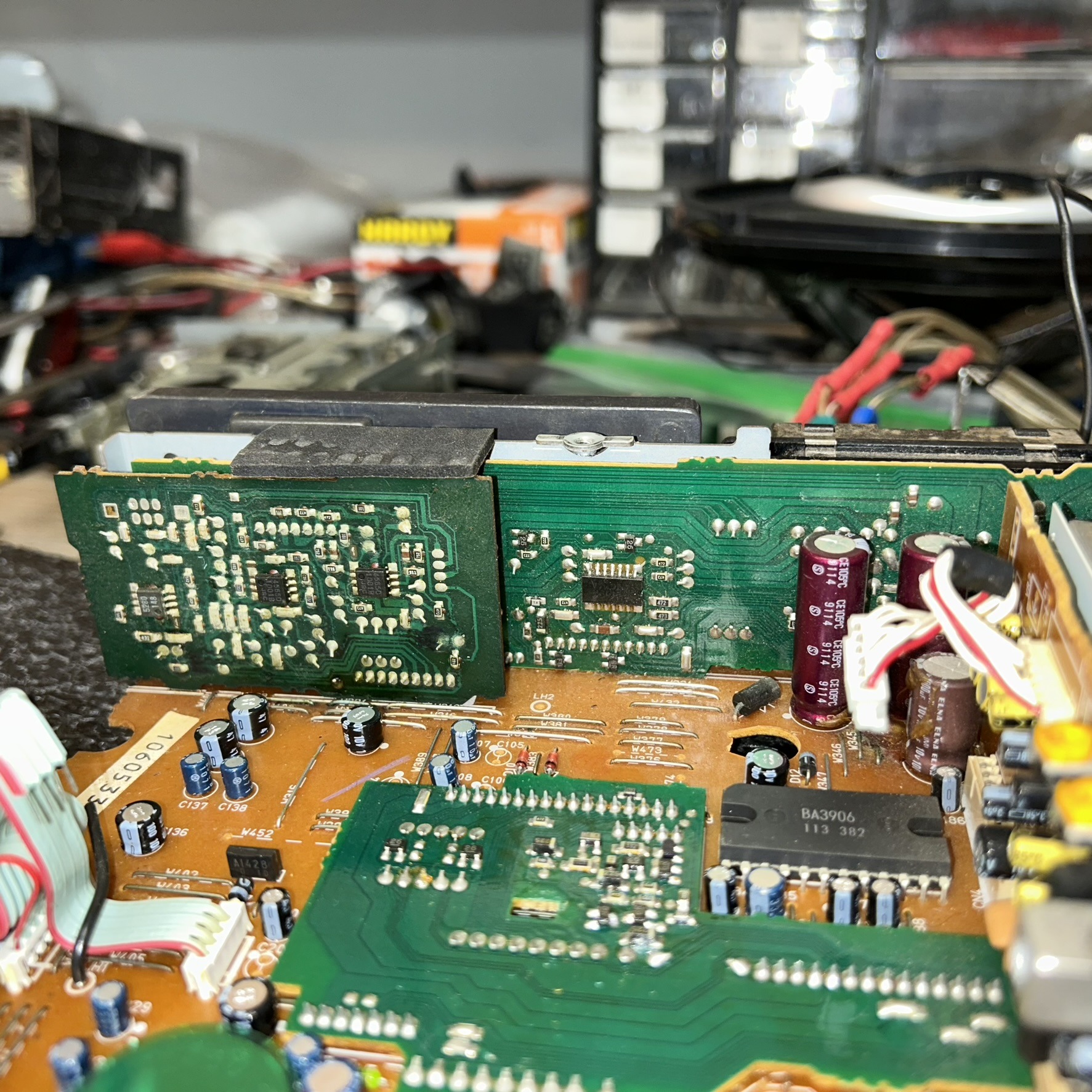

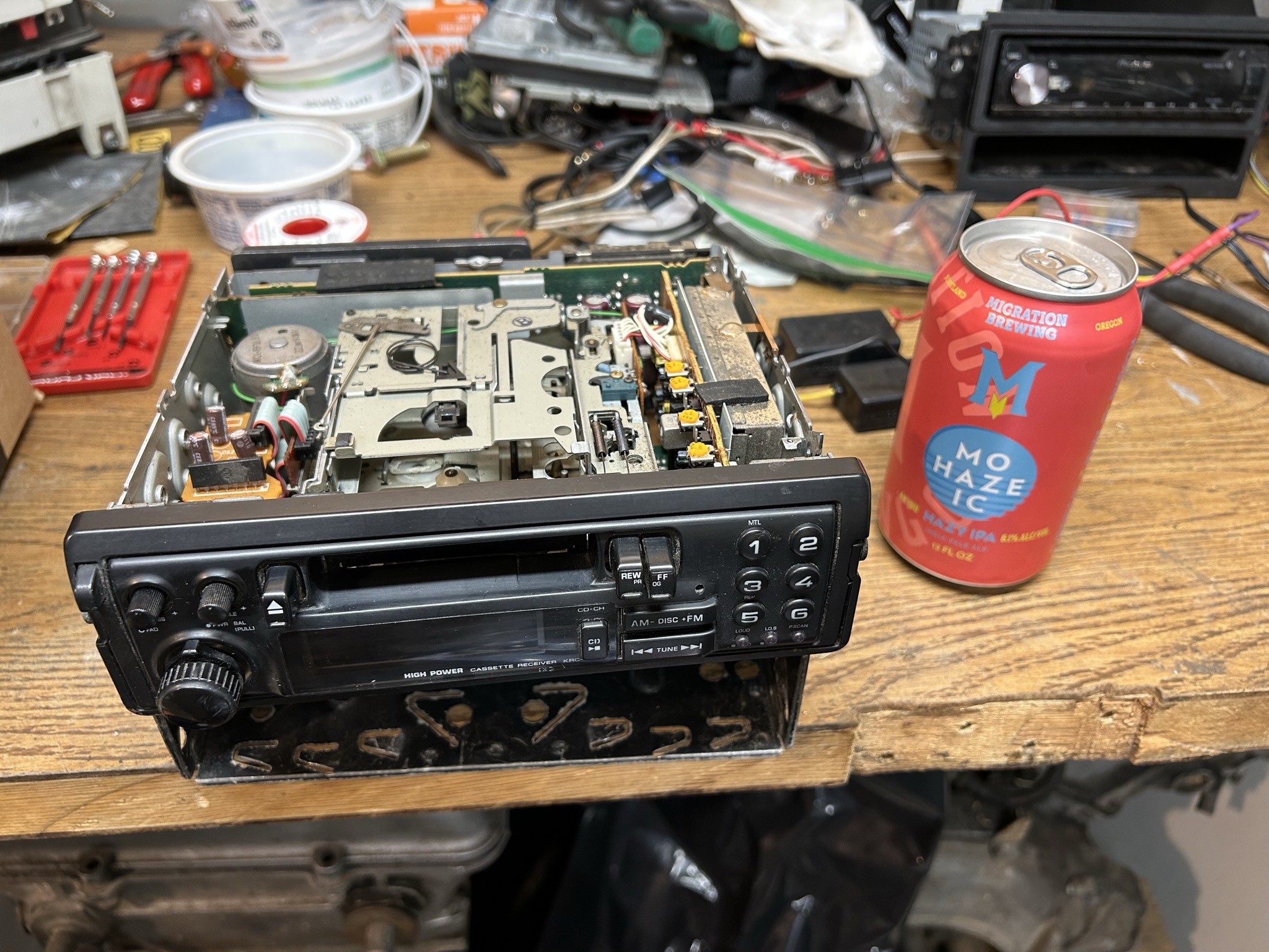

Hello, first time poster. I'm trying to diagnose and repair a vintage Kenwood KRC-530 cassette deck. I picked it up from Pick n Pull so I don't know it's history unfortunately.
Can anybody help me narrow down which board I should start testing on this head unit? I believe I am going to have to de-solder the power IC board to be able to test it.

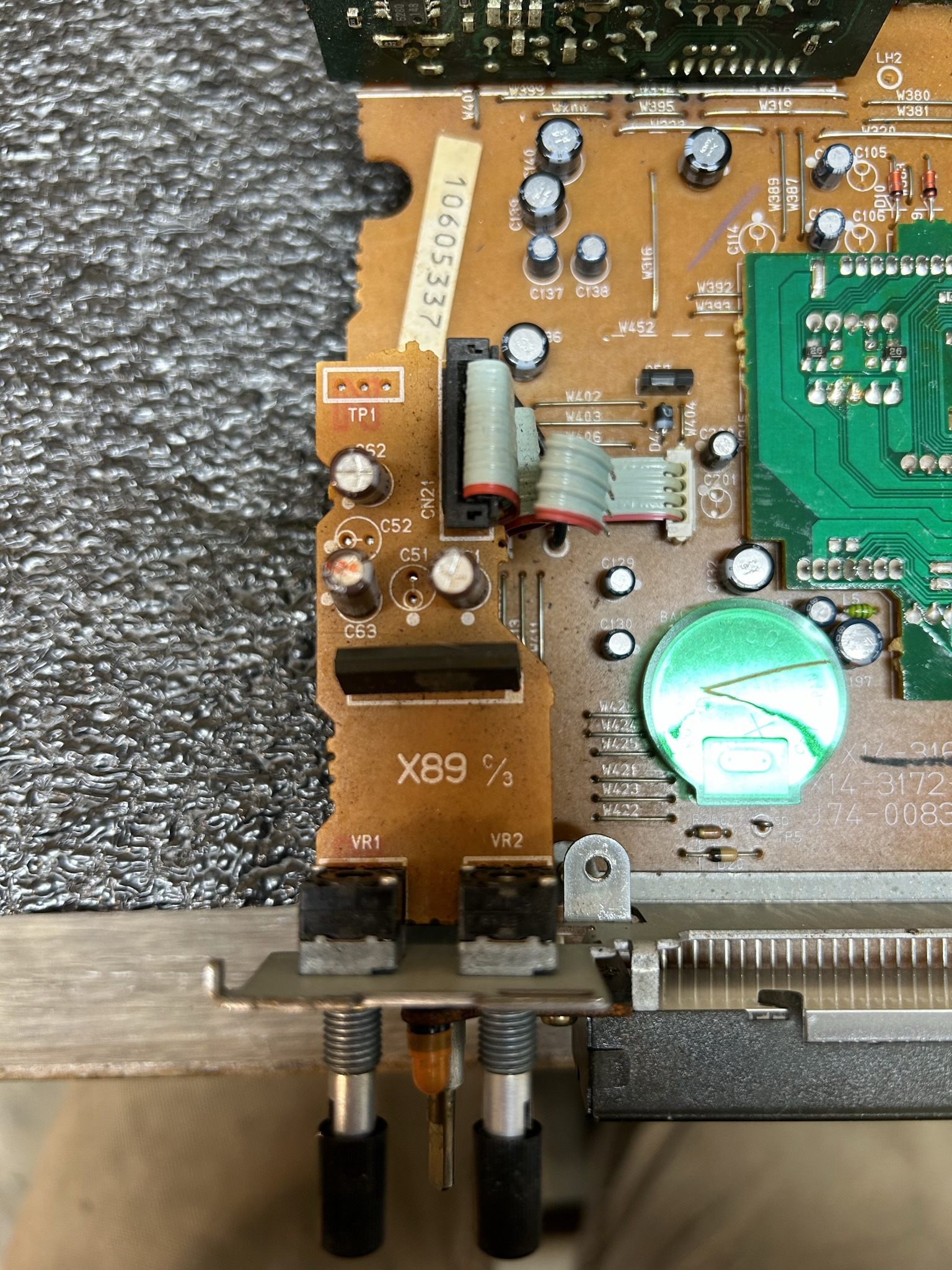

The main issue I have found so far is that the volume output is very low, and it will make a loud pop every few seconds and go quiet. This happens on all the channels.
If I turn down the treble and bass controls I can actually turn it up all the way without pops. If the treble and bass controls are at their normal spots (0 db) it will start to pop at very low volume. At higher volume the pop is so large you can literally see the speaker cone jump. (I'm using an old speaker that I can toss if it gets damaged). But even at full volume the output is pretty low.
I also tested the output from the RCA through a known good amp. With the amp gain on full and the radio volume maxed out you can barely hear anything. But no pops.
Someone had replaced the fuse in the main yellow power lead with a 5 amp fuse instead of a 3.5 amp fuse, so I replaced that and it didn't pop when I fired it up again. But I'm assuming something happened that blew that fuse at some point.
I checked the RCA grounds and the resistance is only 0.3 ohms, so I believe that's good.
I don't see any obviously burnt areas in the head unit, but some of the boards can't really be inspected without de-soldering them.
Based on Perry's guide it sounds like one of the speaker leads might have been accidentally grounded, blowing the main amp.
But the fact that the pops go away when the tone controls are turned all the way down makes we wonder about the tone control board and IC.

It does it on FM, I can check AM as well. I can't really check the cassette because the belt I believe has stretched too much. It will move a little bit in FF or Rev, but doesn't move in Play. I think I see what you're getting at.
Through the RCA's I didn't hear a pop, but the volume is barely audible. I will try it again.

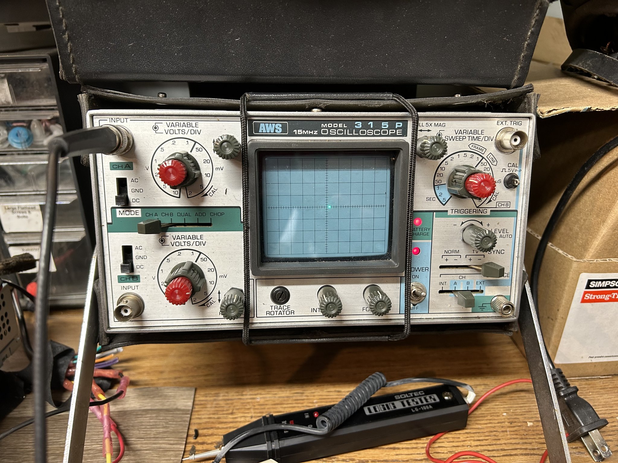

I used a scope back in school, I haven't tried this one yet but I think I can get it going. What I don't have unfortunately is signal generator. I know there are tones available online, but I don't have a benchtop version.
BTW I'm honored to have your help! I don't follow celebrities, but I'm a bit awestruck that you're helping me.
I'm just an average tech. Nothing more.
You can use virtually anything for a signal generator. The audio files can be anything from music to sine waves to pink noise. You likely already have music. The files you want, other than that can be generated by Audacity.
Set the scope up and get used to using it on various points in an amplifier or this head unit. Did you read the oscilloscope page I recommended?
Your page? Yes! https://www.bcae1.com/oscope.htm
I have also read through the scope section in the book I mentioned.
I will set up the scope and start learning how to use it today. I’m heading out of town to help my folks move into an independent living facility this week so with the flight and downtime I will have plenty of time to keep reading. So I will finish up your basic course. Then hopefully I can get going again next week
Thanks again!
Thanks, that should keep me entertained!
The scope isn’t super powerful, it’s a AWS model 315P I found locally from someone who had retired from Intel. But it should get me started and I can upgrade if needed.

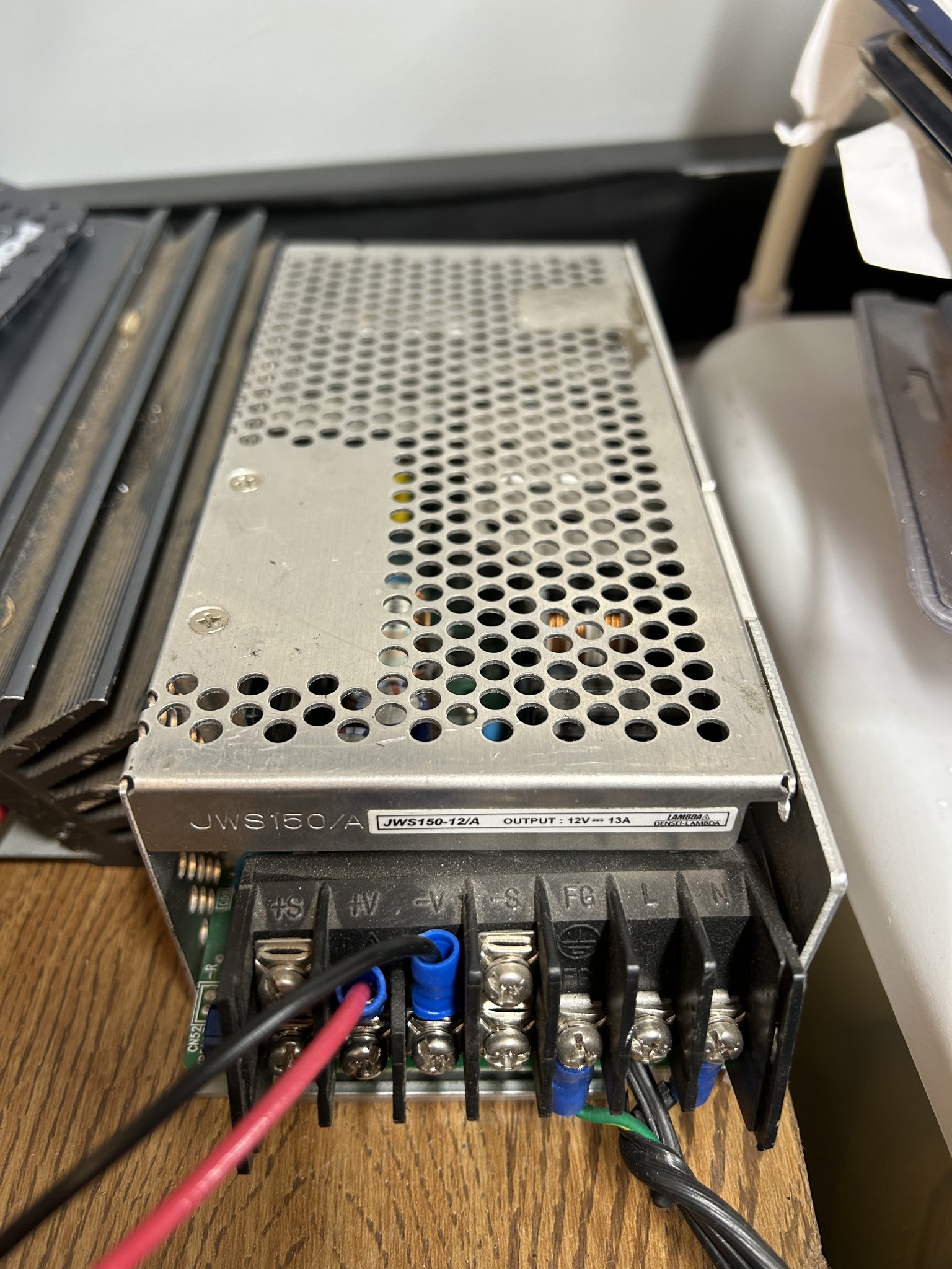

I picked up this power supply when HP was downsizing our offices. It’s worked great for years. I need to come up with a better mount to clean up my bench a little, but I have it running through a 10A fuse block into a power strip that I can plug multiple amps or radios into. Messy but functional.

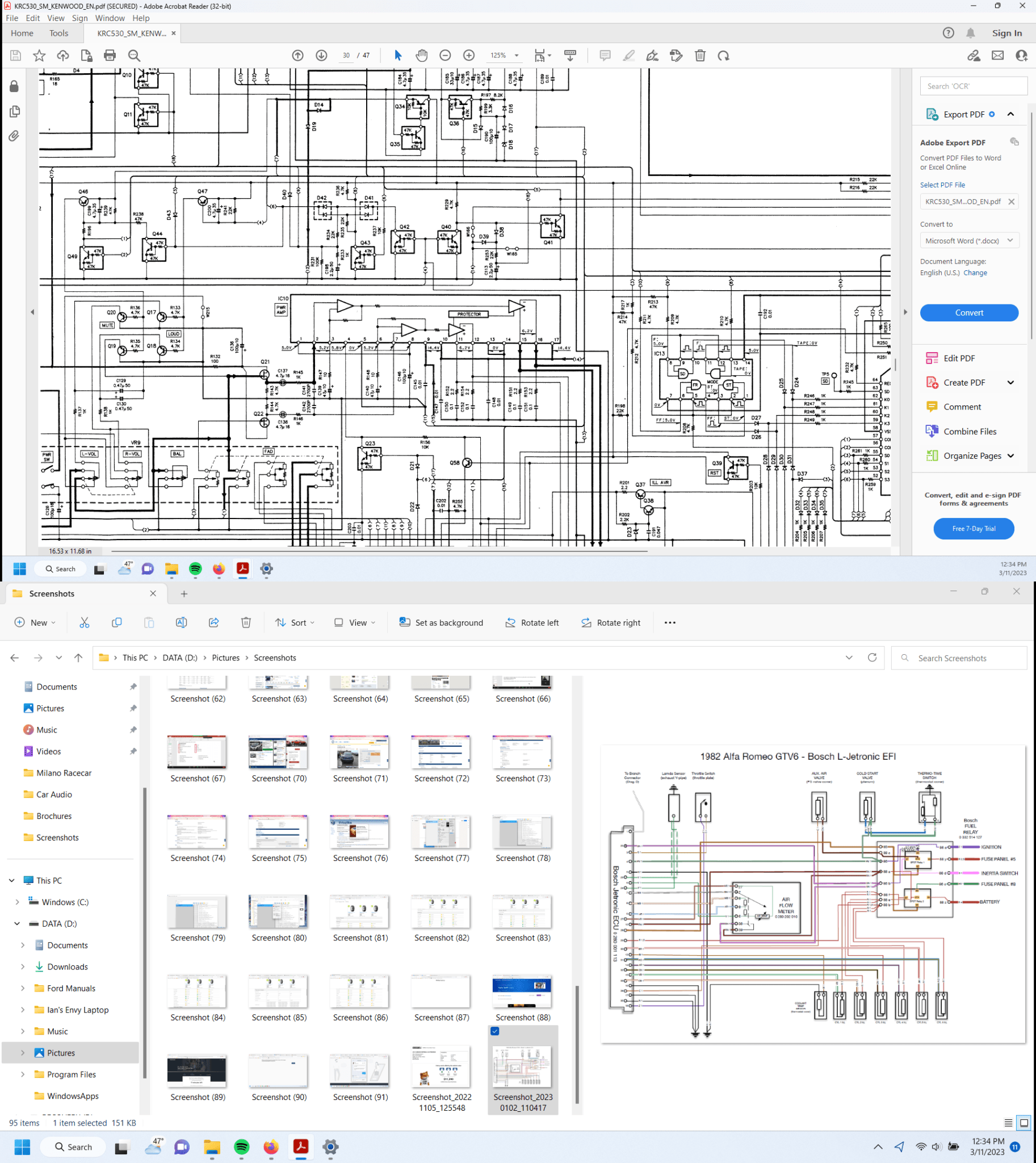

I'm back. I spent a few hours last night and today poring over the wiring diagram, trying to make sense of it.
I also read through most of the rest of Perry's manual, thank you so much for putting that together. Next up I need to purchase the full version.
But just now I was able to find the power amp and test for voltage at all 17 points. They all came in close to what they should be. My next guess is that I've got a cap or two going bad somewhere based on other research, but I think the best option at this point is to get the full repair manual and follow the steps in there.
