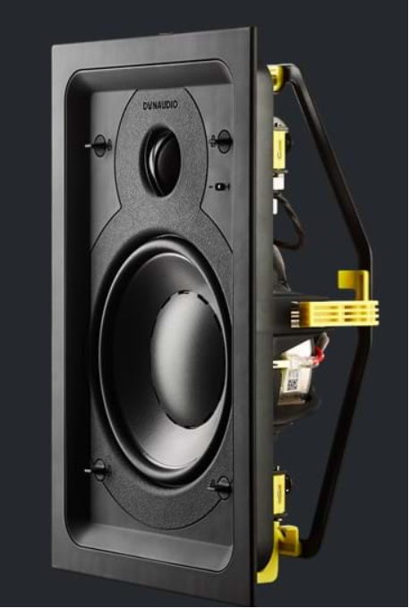

Something to reflect upon
Scrap the design ideas, get rid of the Seas drivers and purchase something like this. It will sound wonderful, give you still enough work to place these in the walls. You can thank me later, once you are much older.
I am looking for ideas on what to do with the existing drivers I have, help with crossovers, box design and tweeter recommendations.
