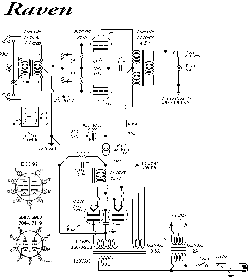

I understand your sentiment, however a transformer in the position you describe simply relies upon the last power supply capacitor for the true signal path, and that is likely to be a so-so electrolytic. Perhaps better to design it para-feed as the capacitor involved will be smaller than the power supply electrolytic and can then be a decent quality item. Also, if you go para-feed then I understand that the plate resistor can be replaced by a constant current source hence very much reducing the influence of the power supply capacitor.

"Studio grade" means an output imedance < 50 Ohms, only with transformers you don't reach this (you're needing feedback).

Take a look at the Raven preamp on nutshellhifi.com. Its a preamp designed by Lynn Olson and Gary Pimm. It fits your goals and I think you might even get close to your target Zout without NFB.
Check out Edcor interstage transformers. Their resonably priced, made in the US and I've never heard a negative thing about them. They don't have any permissable DC rating listed on their products though.
Llundahl and Sowter both make interstage and plate to line transformers intended to carry plate current.
Jack Elliano over at Electra-Print will make you whatever you want once you know what it is.
The parafeed suggestion is a good one as well, but will require a single coupling cap.
