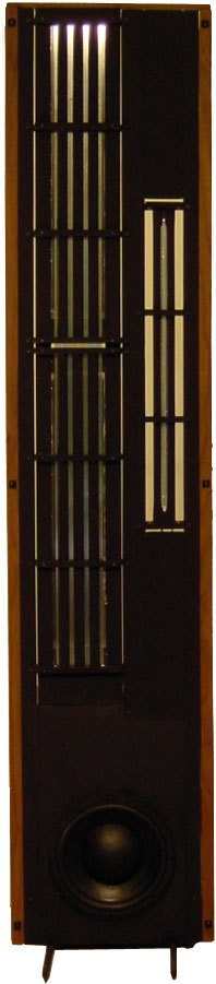

not sure what you mean by pushing 150hz but this 1 rolls off @ 45 hz and is down by 10 db @ 20 hz, it extends to 450 hz smoothly and the xover
limits it there, but the driver can extend beyound that. This driver is the big 1 at 16 inches by 30. It was custom made along with some smaller ones 16 x 20 . The bass you get from a flat driver is more solid than anything I have ever heard in over 35 years of listening to speakers.
have fun
That is impressive!
However i have space limitations...about 25cmX50cm max, and i have TL loaded
woofers for bass to infra bass.
I also want it to be an isodynamic planar (magnets on both sides).
So, a range of 150-1000Hz is pretty doable.
BUT if you want 90+ db/W/m and not so steep roll-of at the low end
it becomes demanding...
