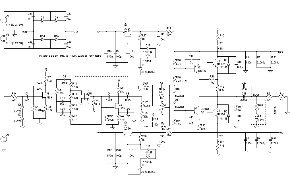

Hi all,
I don't know whether this thread is in the wrong place or not but musical instruments forum seems a bit dead so i decided to post here...
I have been designing this low power amplifier for guitar and the design is now in the part where i'm open for suggestions of improvements. There are also some issues to which i need clearance. This circuit is mainly a test to see what kind of tone some circuit's will produce since my research has shown that most of solid state guitar amplifiers that have a reputation of having a good tone have 1. an active tone shaping stage, 2. quasi-complementary power stage, 3. smallish decoupling caps, 4. no negative feedback from output to previous stages.
Also, there seems to be a lot controversy about the amplitude range of guitar pickups. The common belief is that they produce a peak voltage of 100mV (peaks) and when the note decays the amplitude is typically about 30mV.
My research has shown that some pickups can easily do 400mV peaks and some effect pedals even put out a line level signal. 1V is quite much when compared to 30mV. When i tested my guitar's pickups by plugging them straight into mixer's input they were almost equally as loud as a line level signal. What is the truth here? To what peak voltage you people usually base your design into?
Another design issue is the frequency curve which is not flat in guitar amplifiers. Since the slope's centerpoint in the curve is usually located around 400-600hZ the amplitude in 1kHz (the typical measurement frequency) can easily be around -12dB less than the amplitude in for example 2kHz or 80Hz. Doesn't this lead into awful amount of distortion if you base your design on 1kHz sine wave, especially with 60mVpp signal? What methods you people use in designing these amplifiers?
I tried to find some discussion about this from the internet but strangely there doesn't seem to be any. I guess it's time for it now and more the merrier if it can relate to circuit i'm posting as attachment.
Thanks in advance,
Teemu K
Hello Teemu
General this amp shoul work fine;)
it is good that the poweramp does not have a global feedback - the distortion will be much better during overdrive it and easier for overdrive!!! Good to isolate it from the speaker, you know what I mean?
IMO using of opamps is not a good solution, try use jfets configured as tubes to get good distortion and the spectrum like in a valve amp.
One more: try to use at the input and at every stage high pass filter with the frequency~100Hz.
To get hmetal-like distortion try to overdrive signal shaped in pass filter ~1kHz.:cool:

Hi all,
thanks for your answers but i still think there's room for more discussion.
Well, i'm not really looking for distortion from this amplifier. If i'd want that i would rather use outboard effects. Distortion is nice and often associated with guitar amplifiers that are usually driven harder than "home" amplifiers but implementing a "distorter" to this amplifier would need a whole new circuit (channel) since distortion tone shaping is very much different from typical tone shaping, especially in solid state devices. And what if you want to have a clean tone?
Totally another question is how to make the distortion that WILL occur in any amplifier mellow and nice sounding. That seems to be quite tricky with solid state devices and since this is low power amp it might become an issue. A compressor stage before the final voltage amp possibly...?
What do you mean by configuring jfets as tubes? The jfets can be configured as jfets - nothing else. Solid state is solid state - tube is tube and the sonic spectrum is unique in every case.
The lowest E in guitar is 80Hz. Dropped tunings put out even lower frequency and same thing happens when you play damped strings so why put low pass on 100Hz?
I have to disagree with you since i'd rather use frequncy shaping in the signal path as less as possible since this is the easiest way to get nasty sounding distortion besides overdrive. Truly some is needed to cut down lowest and highest end and to avoid oscillation. As you notice i do this with small decoupling caps and negative feedback in opamp stages. However, i don't agree with you on 100Hz.
Personally i see nothing wrong in using opamps as long as they're not overdriven. That could happen in the last voltage amplifiying stage unless the input sensitivity is not set correctly. Anyone have idea of how to do it? (Frequency curve and pickup issue).
I tried jfet's in a 1/2W practice amplifier that i built few months ago. It had a chip amp otput stage (lm386) and a jfet preamp. I have to say that i liked the distortion characteristics of jfets when compared to opamps but at the end all comes down to clipping power amplifier which then should have fets too and that's a whole new story.
I didn't want to take that path this time since this is my first try in designing a discrete power stage and i wanted to keep things as simple as possible. Also, i find opamp design easier because you can avoid of using large amount of discrete components. As long as you don't overdrive them they don't seem to differ that much from jfets or any other discrete circuits.
Teemu K

Low E on the guitar is 82.5 Hz, trust me! Why would a 100 Hz filter affect the sound of the guitar otherwise?
But yes, turning down the bass can be beneficial to the sound, particularly if like the sound with less bass:D
You really need an input sensitivity control that sets the gain of the first stage. Guitars are a varied lot, as you have discovered. Many guitar amps have Hi/Lo inputs for this reason.
Switchable resistors or a potentiometer is a good thing. I'd make U1 a non-inverting stage to make the values of resistors more manageable.

Can't say I have a general opionion. I like my bass deep. It's something I'd consider making adjustable.
teemuk said:
That´s what i figured out too. I´t´s quite easy to replace a resistor with a trimmer but still there´s a huge difference between 30mV @1kHz and 1V at, say, 82.5Hz. So what would be the starting point? 30mV on 1kHz and lowering the gain from there?
30mV is a probably not necessary. I'd start at 100mV, maybe. In my opinion the operative word is headroom, as in headroom before the master volume. That way, when it does clip you know it's the power amp that's doing it. If you're playing Sultans Of Swing style there's gonna be a lot more than a 1:3 ratio beween peak and decay levels.
teemuk said:
Also, has any comments of the amplifier circuit in general?
Well, there's a bunch of 6.8k resistors from the op-amp outputs. What are they doing there? I know som op-amps were designed to be resistor loaded, but what are you using?
As I said earlier, I'd consider a non-inverting input stage for gain adjustment.
What is R25 doing? 1miliohm is hard to buy:scratch:
J1 seems a bit superflous as a whole. Surely U1 can drive the 33k impedance of U3?
U1 has no DC negative feedback. :dead:

Thanks for your comments Runebivrim. The non-inverting input stage seems to be a good way to add a trimmer resistor to control the input sensitivity. I will work on that. Also, i do believe that the circuit needs a bass control.
Rune
The resistors are there to bias the opamps to operate in class A.
Depending of the opamp that is used in the circuit it can either make the tone better or worse - or possibly it won't have any audible effect. Yes, they can be omitted unless i want to use them.
Rune
Hehe. Actually it's a "potentiometer" with R26. LTspice, which i use to make schematics and simulate circuits, doesn't have a model for potentiometer so i skip it that way.
Rune
Not really. U1 forms an active frequency shaping circuit that will need a low output impedance, which is 1.5k on J1's grid. Varying impedance would cause drastic variation in the frequency curve unless the J1 buffer stage would be there. Without the buffer it would also be hard to add a volume control potentiometer (R25 & R26) and the "high" input impedance of U3 to the circuit.
Teemu K
Teemu K
I see. C6 and R12 form a hi-pass filter with a -3dB point at 156 Hz. Still, effectively adding a resistor parallel with R12 varying from 19387 ohms to 47000 ohms (R26//R4) would vary the total resistance from 1392 ohms to 1453 ohms, which results in a -3dB point moving from 161 to 168 Hz. Hardly earth shattering, in my opinion. But maybe J1 adds some subtle colouring, I don't know.
However, I still fail to see how U1 has any negative feedback at DC.
Rune

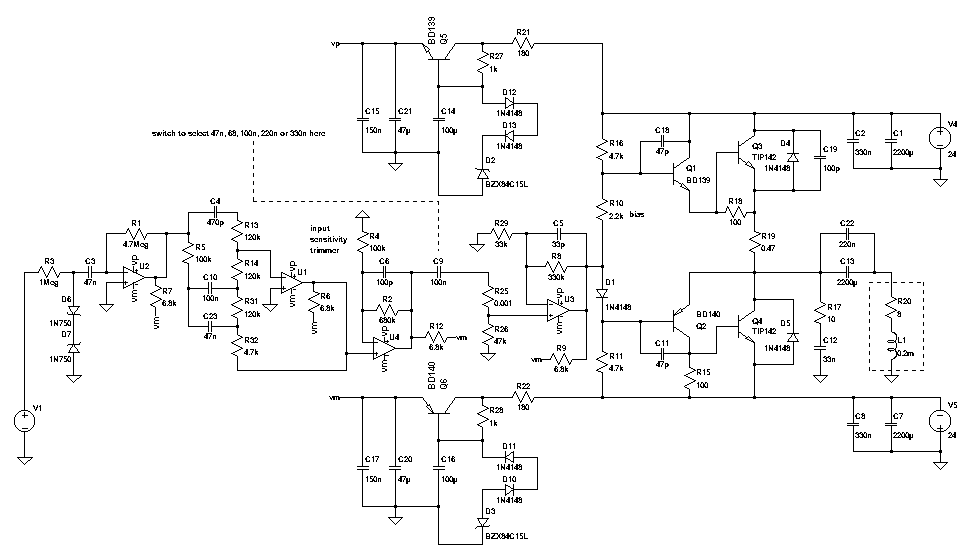

Re: Re: Re: Re: Re: Re: Re: Re: Re: Help designing a guitar amp
Ok, i'm posting the updated schema.
Rune
Whoops, good point there. The only reason why the previous circuit seemed to work (at least in simulation) was that it biased the output only to -12v. Not good practice, higly unstable circuit and doesn't leave much overload capacity since most opamps clip at -13v! ...So i had to redesign the circuit.
The "fender-marshall-vox-whatever"-tonestack seems to have a quite big insertion loss so i guess that "solved" the issue about the jfet buffer. Any opinions about using a baxandall stack instead of this one - other than it has more control and an ability to boost midrange?
Comments are welcomed.
Teemu K
I really have little to say on the tone stack issue. The typical hifi Baxandall tone stack is usually not particularly useful, but that is mainly a frequency issue, not a fundamental topology thing.
Otherwise it look quite good, except I would keep the stage with adjustable gain as close to the input as possible. Preferably the first stage. That way you'll be able to have maximum headroom, while keeping the noise to a minimum.
Rune

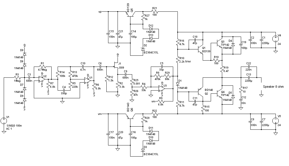

Time for an update.
I followed few suggestions and replaced some opamp stages with jfets. It seemed to make the tone a bit more "punchier". Unfortunately, side effect is increased noise and distortion. However, i prefer the spicier tone a bit more than having an ultra quiet amp.
I also added the secondary side of the power supply circuit, which (during simulation) helped to reveal some weaknesses in first designs: There wasn't enough capacitance on power rails in first two versions. Some capacitance is also needed before the regulators (C36 & C35), otherwise the amount of ripple is unbearable.
I also added snubbers to the supply rails. It didn't seem to make any difference to the tone or to circuit's behaviour. In flesh things might be different.
Comments on the design are welcomed and appreciated.
Teemu K
oooooh that's starting to look good. The problem here is that if you use a jfet as first gain stage, you'll get it's warm compression (or better, limiting) but also BIG noise. Selecting fets would help in this case: remember to put a trimmer to control the bias of the fets, as they tend to vary their parameters very much from device to device... Good idea that tone cap switch.
