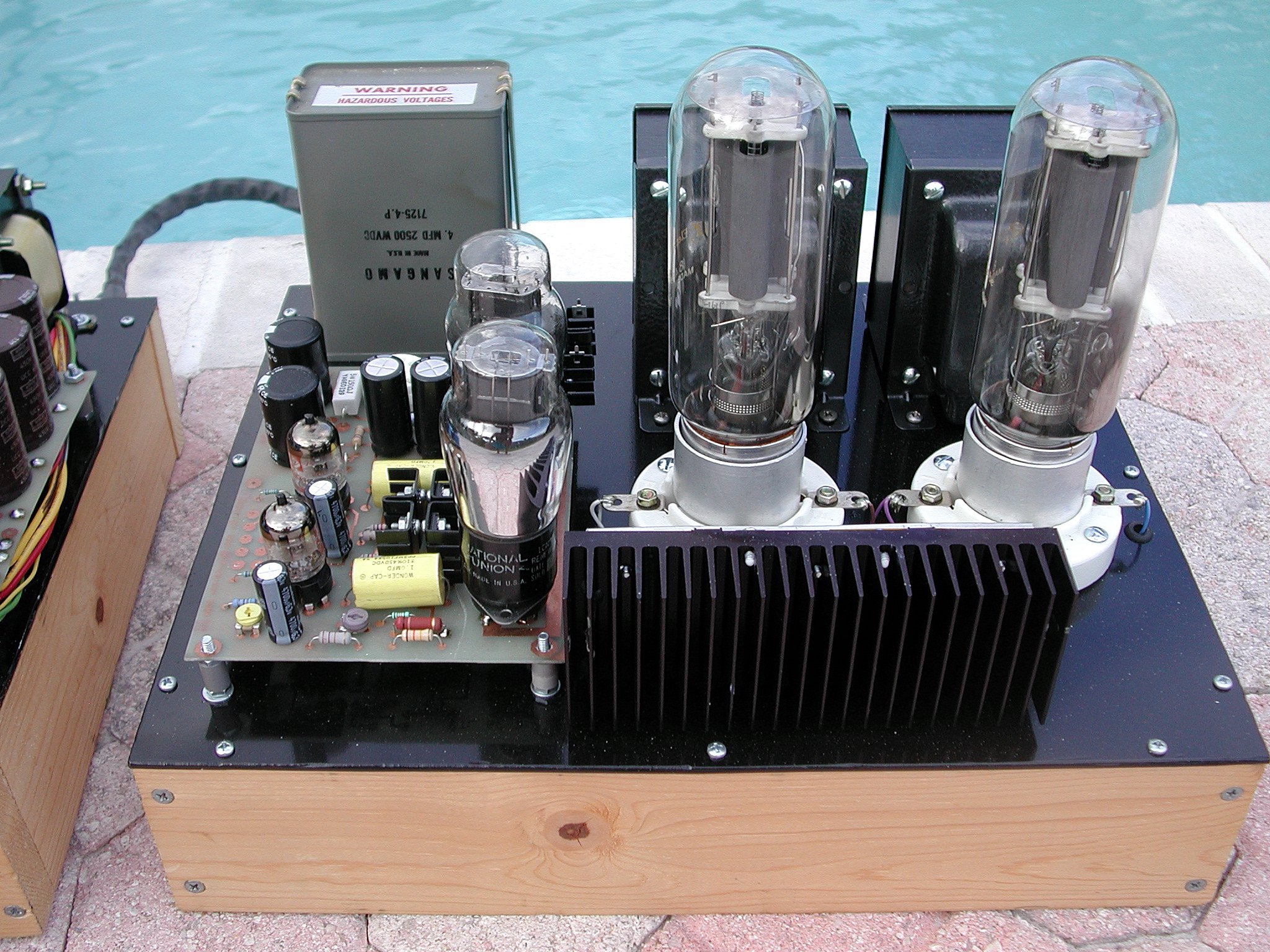

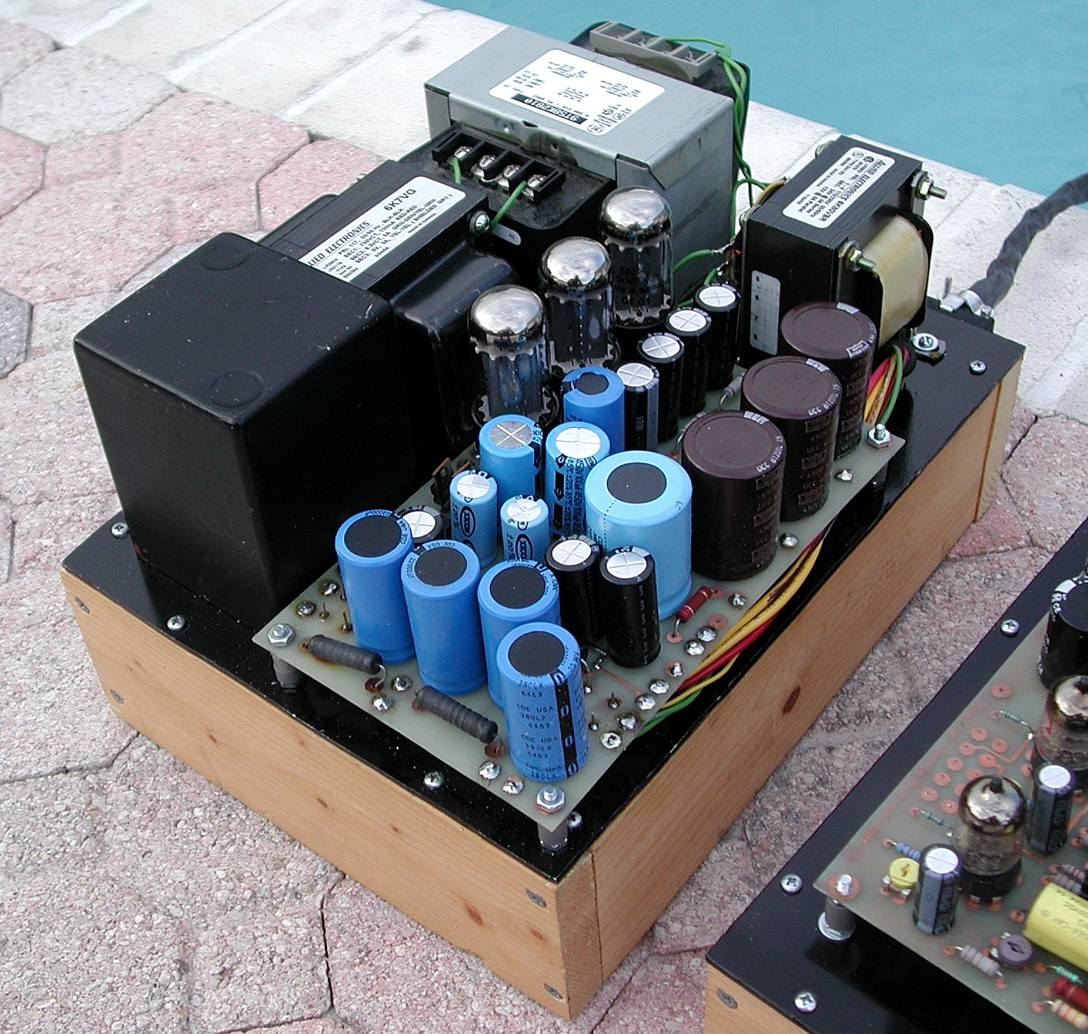

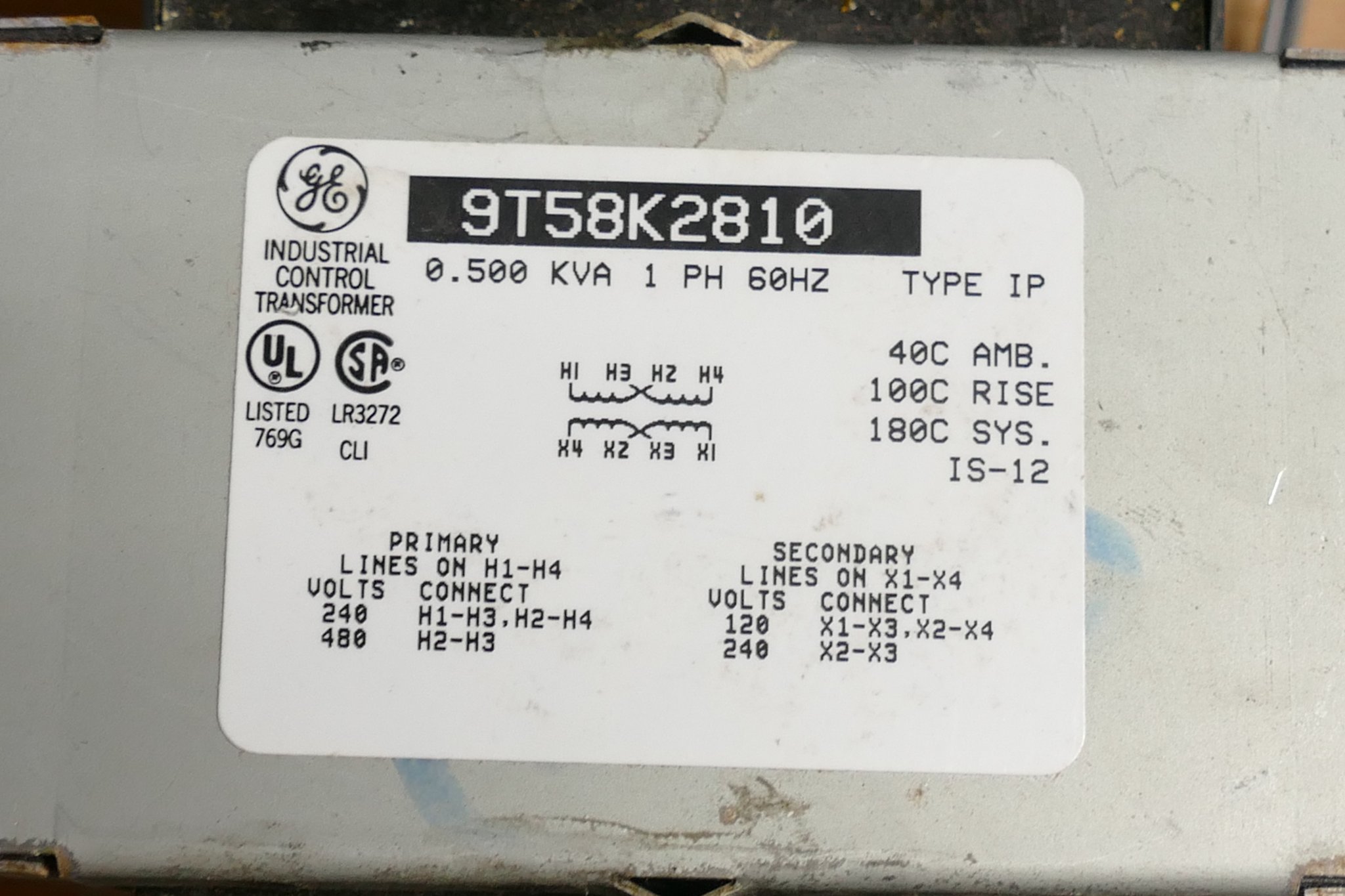

I tend to use whatever transformers I can find or get cheaply. I have been known to mix EI and toroids in the same amp. The 845SE amp used a separate power supply and amp since an all in one design would be too large and heavy. The power supply used a wide variety of "stuff" including a 500 VA 480-to-120-volt industrial control transformer (top of picture) hooked up backwards feeding a voltage doubler made with 5AR4 tubes to get 1100 volts at 150 to 200 mA. These transformers used to be real cheap on Ebay. The shipping cost more than the transformer. The black cube is a military surplus choke rated for 250 mA. It was not rated for use at over 1KV so it is in the negative leg of the 1000 volt supply.

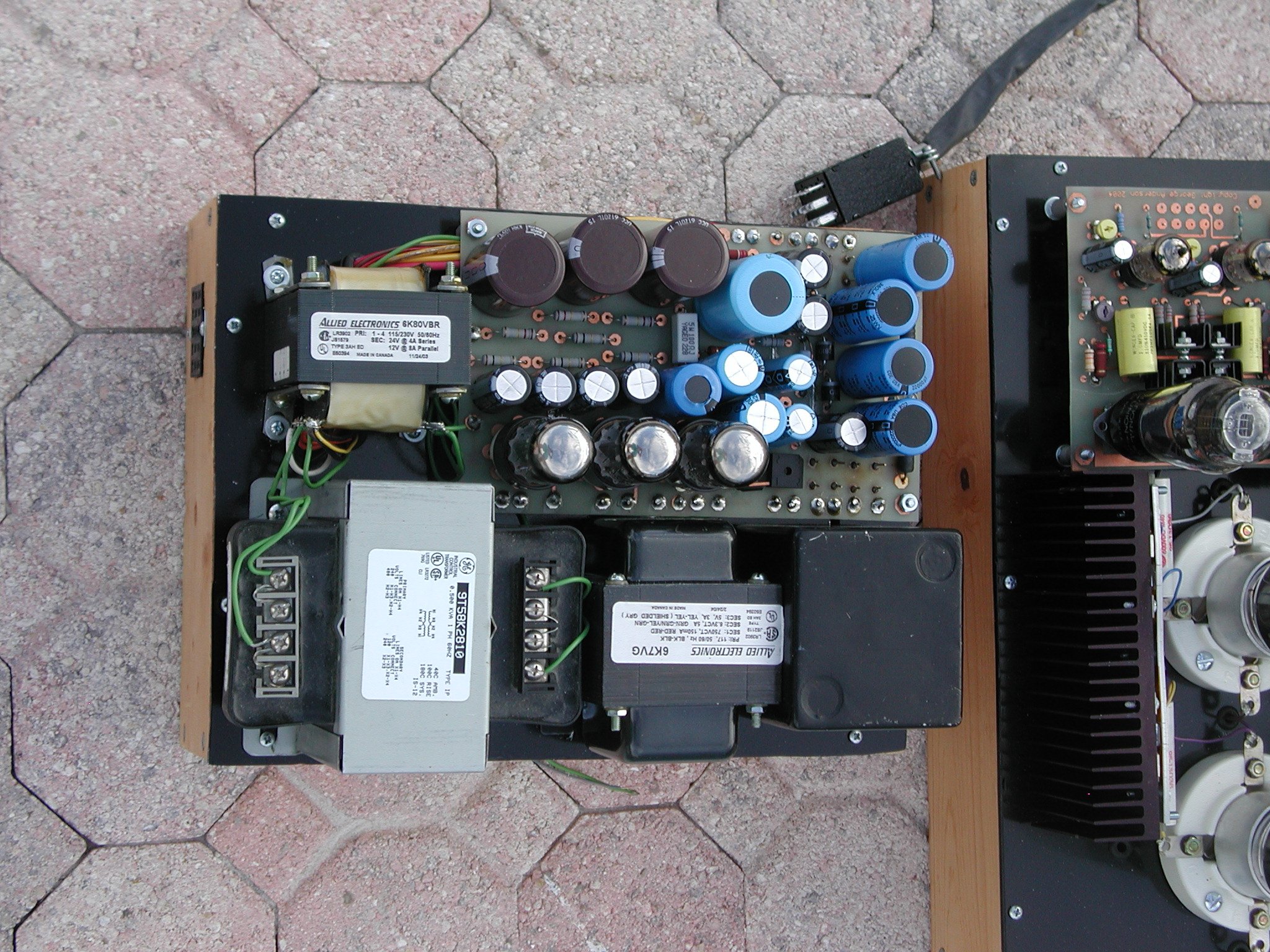

The Allied 6K7VG powers the driver board which is a home cooked prototype of what became the original TSE board. The smaller Allied 6K80VBR is for heater power. It has two 12 volt 4 amp windings that are rectified and filtered to make independent 10 volt 3.25 amp DC supplies for the 845 output tubes.

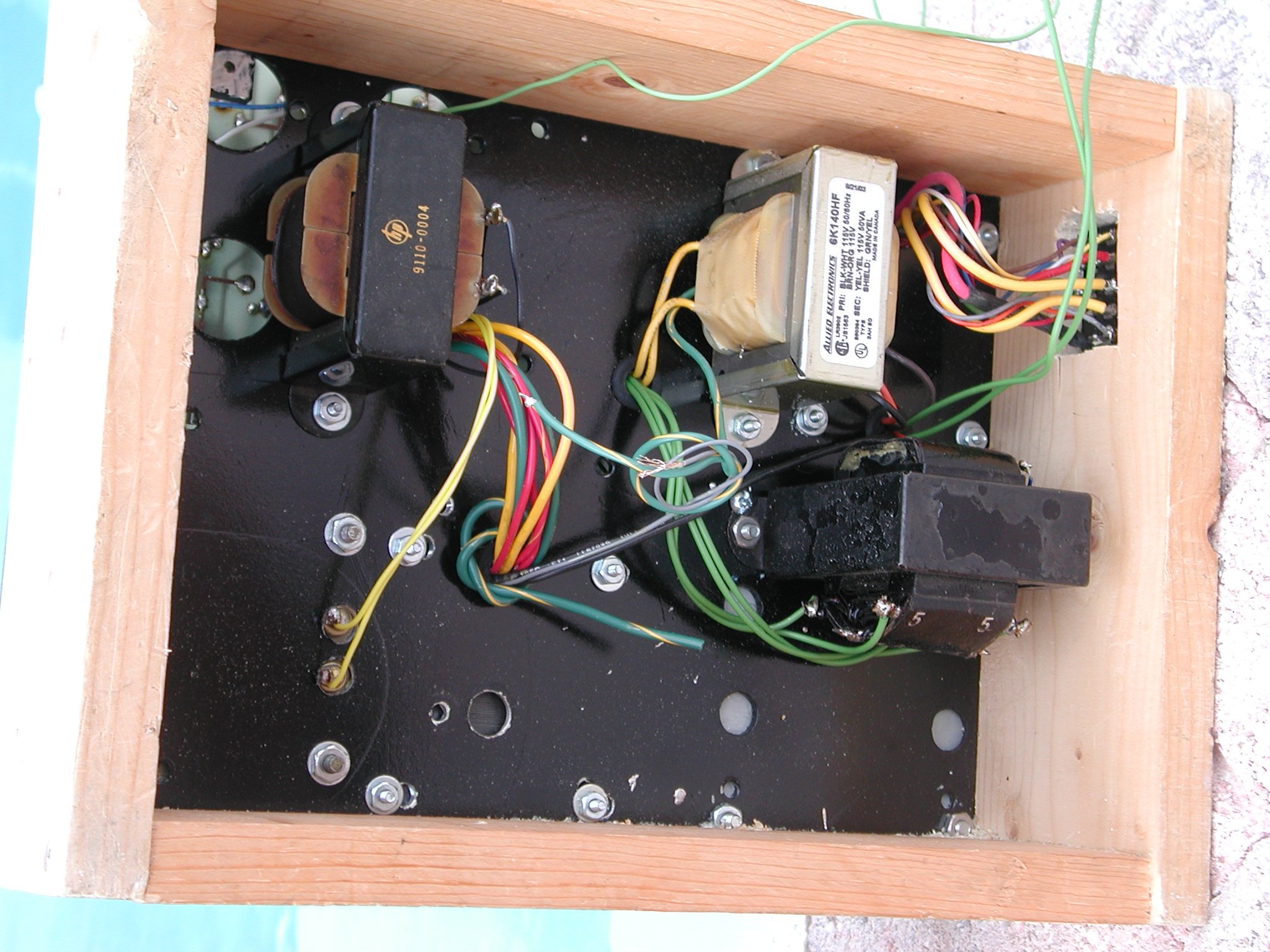

There are two transformers and a choke hidden under the deck. The Allied unit runs the only PowerDrive board I ever made (on amp chassis with heat sink). The black ugly transformer lights up the 5AR4's in the doubler. It came from something I stripped for parts. It had a 2500 volt isolation rating which is needed for the 1100 volt supply. The choke is used in the 450 volt supply for the TSE board. It might be obvious from all the extra holes that this amp went through a lot of revisions. The Umbilical connectors are Cinch Jones connectors. They used to be available from DigiKey when I built this amp about 20 years ago.
This amp put over 500 watts of excess heat into my 10 X 10 foot room in Florida to make 30 WPC in A2 which limited it's use. By the time I got it set up after moving North I had discovered sweep tubes and UNSET so the amp got sold at the Dayton Hamfest a few years ago. The buyer just wanted the OPT's and some of the output tubes.

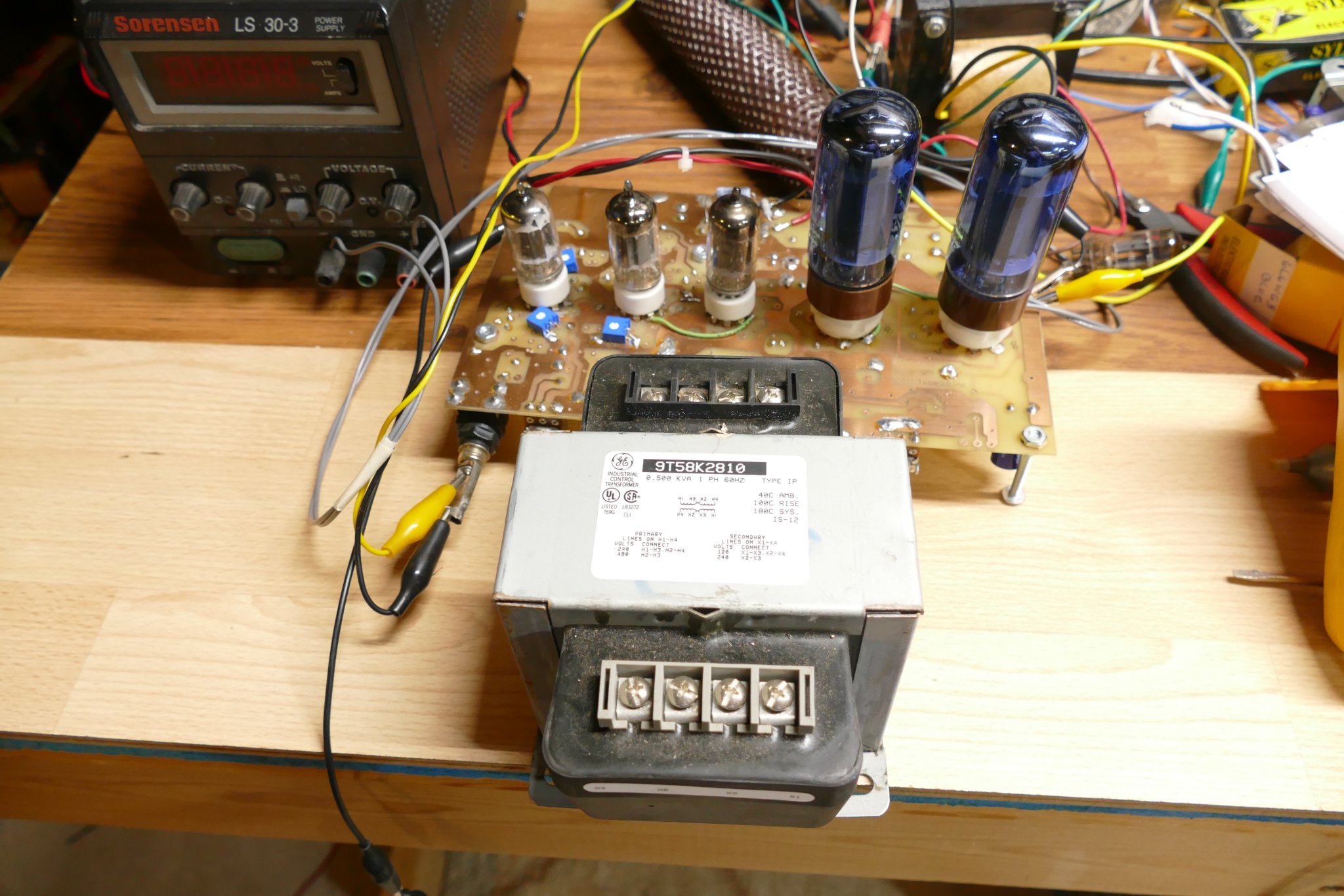

My first and by far the heaviest boat anchor supply was real simple. It used two Variacs, two of those 480 volt industrial control transformers, one 120 / 240 volt to 24 volt industrial control transformer, four large solid state bridge rectifiers, two chokes and a bunch of caps. I put it in a rack mount chassis and managed to get on to my workbench where it stayed for a few years. Each supply was simply a transformer feeding a bridge that fed a CLC filter. The BIG Variac fed a pair of 480 volt transformers hooked up backwards (120 to 480 volts) which each fed its own bridge / CLC filter. This provided two independent 0 to almost 600 volts supplies which were controlled by the same Variac. These could be wired in parallel, series, or used independently for my brief and sometimes explosive fascination with OTL circlotrons. The small Variac fed the small industrial control transformer which had two 24 volt windings. This made a pair of 0 to about 30 volt supply for heaters and stuff that ran on 12 volts. It was only filtered by a pair of real big caps. This was simple, cheap but deadly and made for some serious fireballs and scattered parts as there was nothing to limit the short circuit current except the 15 amp breaker for the whole bench and a line fuse that never blew. An experiment involving a pair of 6LW6's one of my 80 VA guitar amp grade OPT's and the two 0 to 600 volt supplies wired in series set the OPT on fire when my audio dummy load made with parts from Radio Shack went open somewhere past 150 watts. It burned a big, charred spot in my workbench which was expertly crafted from an old door. I eventually collected enough variable bench power supplies to do everything except circlotrons, so the big boat anchor was dismantled.

I still have one of those 480 volt industrial control transformers from the dismantled supply. It is exactly like the one in the amp. It has been in the same spot on a shelf since I moved here 10 years ago. You can have it if you want it. Some of these can be noisy. These are partially potted, so they are quiet. They go get quite warm when run at full load. PC board in background is 9 inches wide and those are 6L6GC's and 12AX7's for a size comparison. I can ship or bring to the Dayton Hamfest. My guess at the weight is about 15 pounds. I also have a box full of Variacs here somewhere.

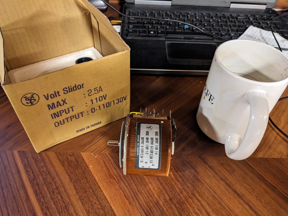

Yes! This is why I love this forum. I forgot that I own four small "theater lighting" variacs in my stash (back when theaters used incandescent lighting). Weight is not an issue. The whole thing will be inside an enclosed aluminum box (brick), rectifier, iron, etc. I can easily mount a variac control on the backside maybe with some form of locking knob so it cant be accidentally turned (photo below). These variacs are 60mm deep and 75mm in diameter, half the size of the coffee cup shown. 2.5A rated. Just thought of another thing, electrolytic capacitors will be in series with balancing resistors so they can withstand voltages. First capacitor after the choke will be a big WIMA MKP film, I have some 900V 100uF film caps waiting for a project.
