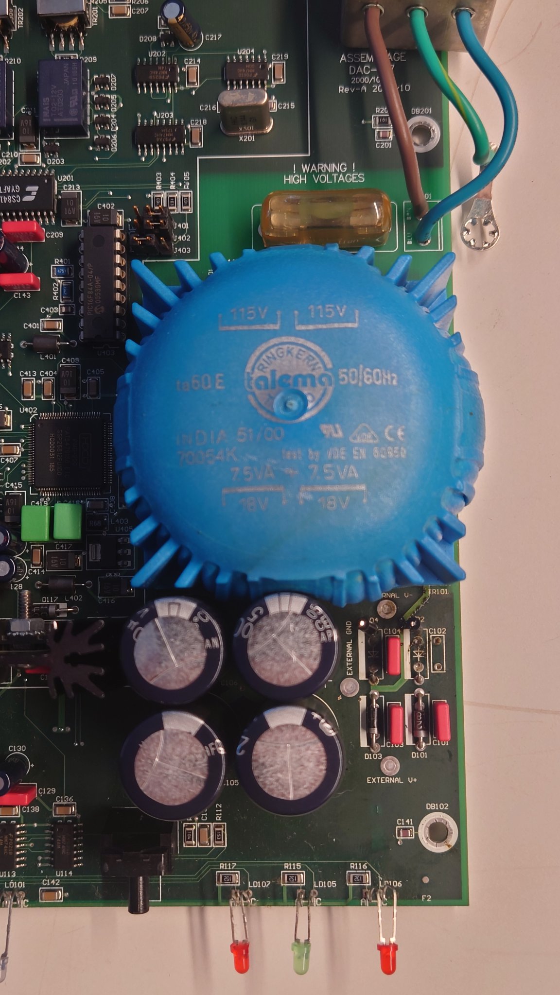

I have an assemblage 2.7 dac that blew its transformer and fuse while i was on holiday.
I replaced the psu with the identical model and the lights all came on so i thought everything was fine.
However after leaving it on for several minutes it started to smell and slowly started to bulge like the previous transformer had.
When I started hearing "bubbling" noises from within the transformer i turned it off.
Surprisingly the fuse didn't blow.
Ive thoroughly checked the pcb on both sides and all components and cant see any further damage.
Does anyone have any ideas what could be wrong and how to fix it?

So far I have found a low resistance across D102 / C102 after removing them (60 ohm). The LM317s, LM337s and the 7812 seem healthy. My guess is either an electrolytic cap short or a PCB inner layer short. Next step is to remove the transformer and the electrolytic caps. I hope to document the debug here in case someone else in the future has the same issue

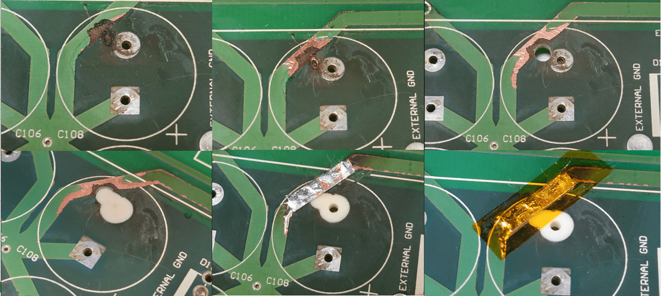

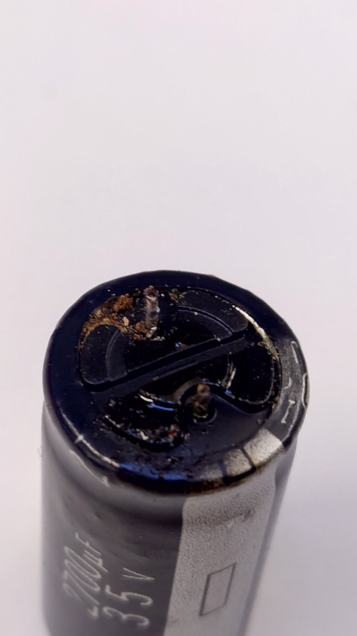

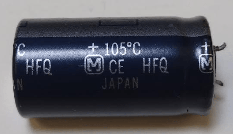

Turns out the issue was both the electrolytic cap and a PCB short. Seems like one of the electrolytic caps leaked and that caused a short from - to GND. The short burned the PCB and then caused a short to the power plane in layer 2.

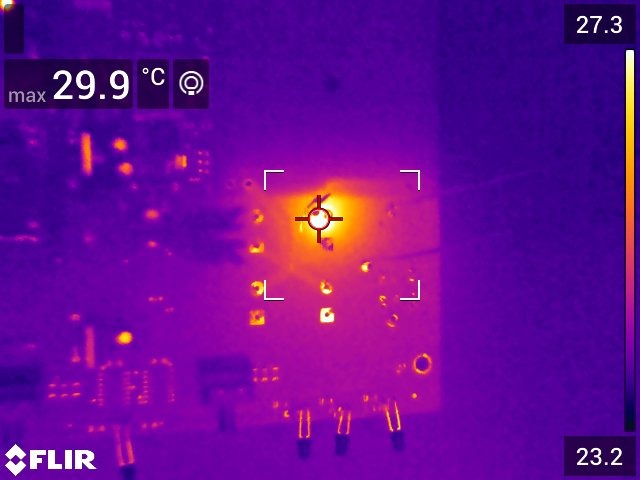

After cleaning all the carbon and electrolyte residue, I drilled out the damaged area of the PCB but the short was still there. Looked at it through a thermal camera while powering the rail with a constant current source at 100mA to not break anything further. Found the short also existed right under the capacitor pad going to layer 2. Had to drill out the pad completely.
After that, filed the holes to avoid copper burrs and filled them with non conductive epoxy to avoid any dendrite growth in the future. Drilled a hole in the epoxy for the cap and replaced the broken trace. You can see the fix progression attached.

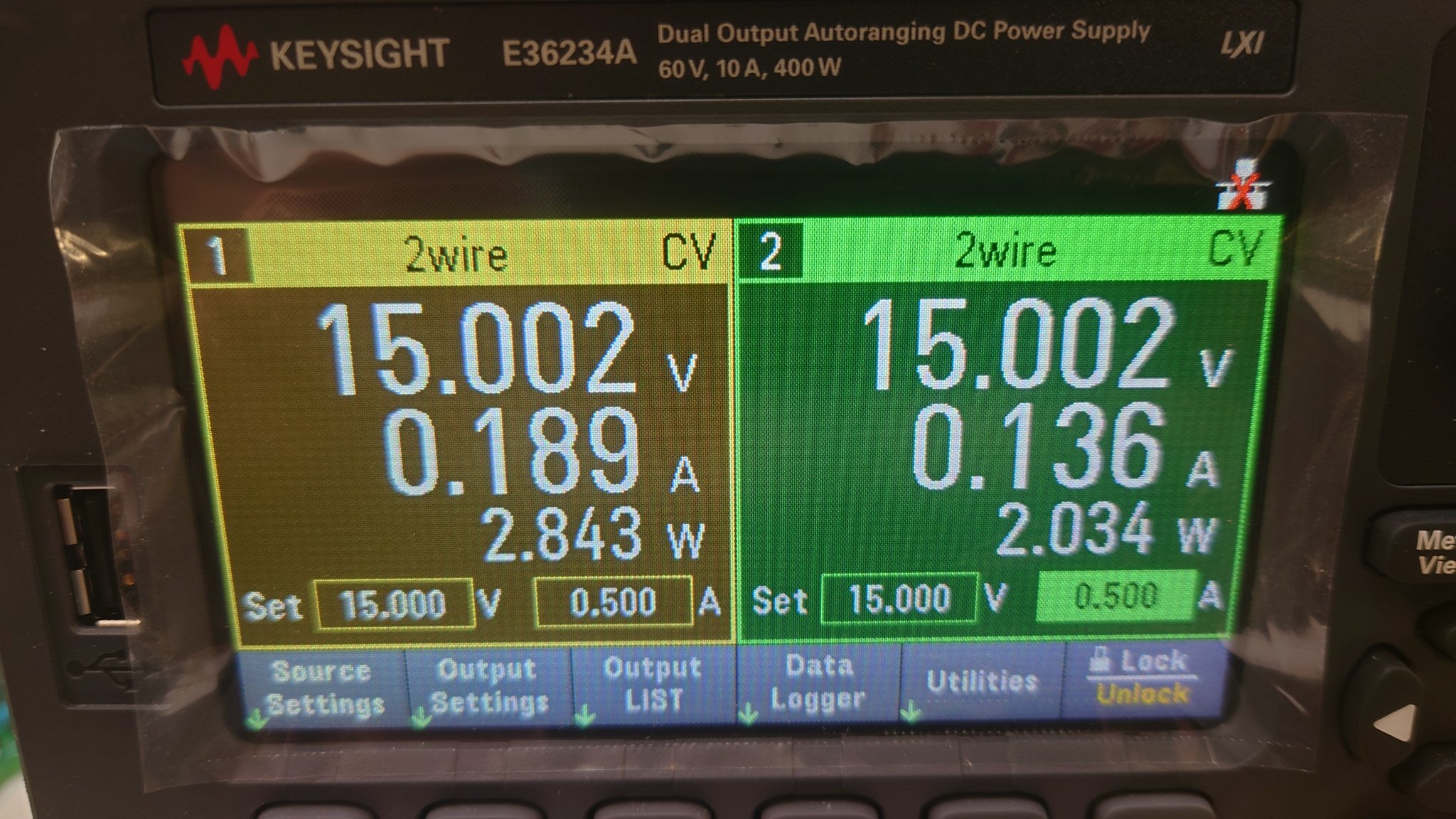

Finally powered the rails with an external power supply and got a normal current draw <200mA per rail at 15V. All rails for the digital and analog section came up and measure nominal.
