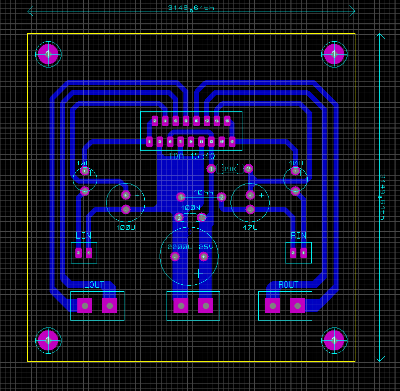

Hello guys,
I'm new to building my own pcbs so I would really appreciate if someone could please make a pcb layout from this schematic picture
I've tried for hours using PCB Creator and Eagle but I couldn't find a way to do to make the routes work, and please attach the schematic file as well as the pcb layout file so I could learn.
Thanks in advance.

IMHO you're not trying hard enough, or you're over-thinking the problem. This PCB is about as easy as it gets. If need be, use jumper wires (ie 0Ω resistors) to cross over other traces that are in the way (assuming a single-sided board).
Is the difficulty in connecting pins 5 and 13, and/or pins 3, 7, & 11? The other connections are fairly straightforward.

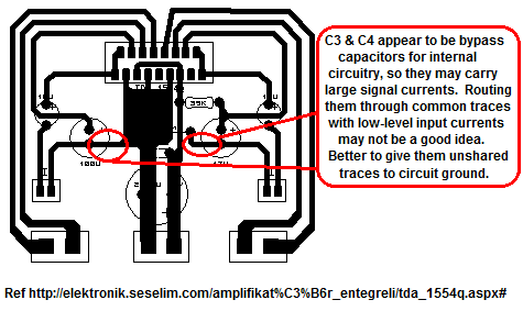

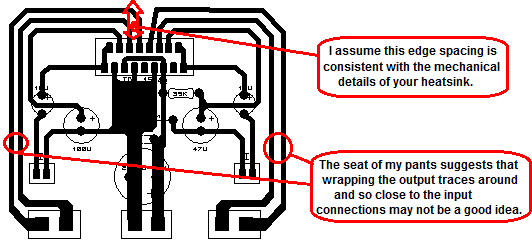

Your circuit, while basic, has some subtle pitfalls. 40 watts (total) power is far from "high power" by most standards but it's a LOT more than you find in small-signal circuits. It's important to identify the high-current traces, adequately size them, and route them to avoid coupling from either electromagnetic effects or IR drops. There's also a large amount of potential gain floating around in this circuit. Each channel is only 26 dB (20 V/V) but accidental coupling from one channel to another could create a power oscillator. And don't be fooled by the idea that this chip amplifies "only" audio frequencies; I'll bet sections within that IC have bandwidths extending well into the MHz range.

I said previously that most of the connections are straightforward; they mostly join to nearby pins. So the best course is to place them as near the chip as possible. The others, like pins 3 & 5, may possibly be joined to other pins right under the chip, with short traces. Perhaps the inputs and/or outputs don't need to run to the board edge, which could then leave some room to maneuver other traces.
Throughout the layout process, keep in mind the tracks that carry higher power, as mentioned. Keep inputs well separated from outputs. Have a grounding scheme in mind to minimize loop currents.
Give it another go and post your result.

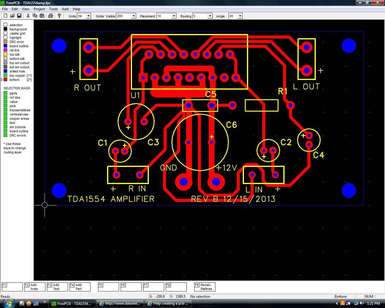

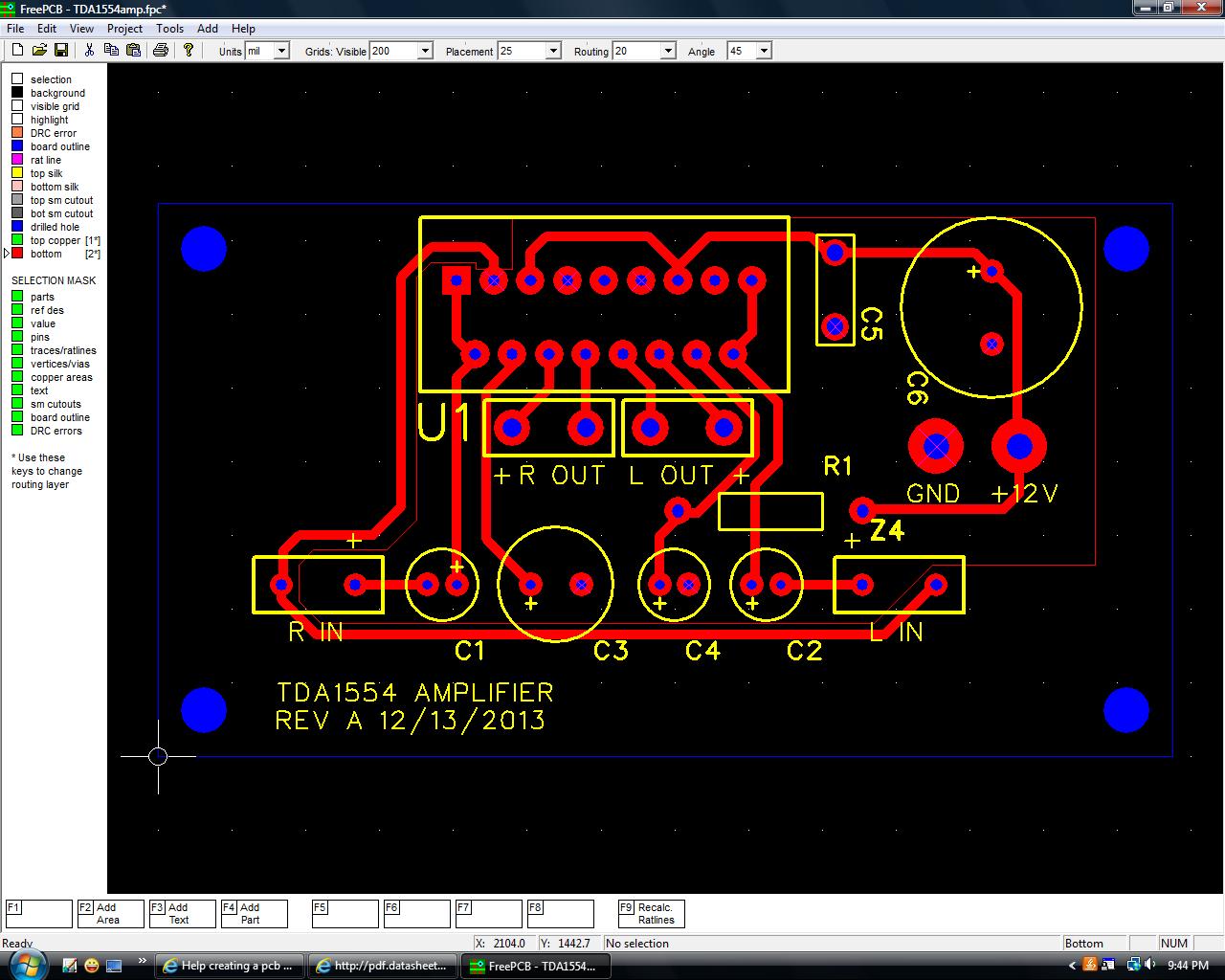

Thanks alot for giving me your opinion on the layout unfortunately I made and it did not work the speakers just made a low hissing noise with a messed up version of the music I was playing.
I think I'll need to find another schematic and start over 😡
How about posting a photo of your attempted PCB and amp an we could look at it and maybe give constructive comments. 😉
You must identify what EACH ground connection is required to do.
Most "grounds" are actually return routes for a signal current.
The return route should mirror the signal route so that loop area is minimised.
This should be done for EVERY circuit !!!!!!!!!!
