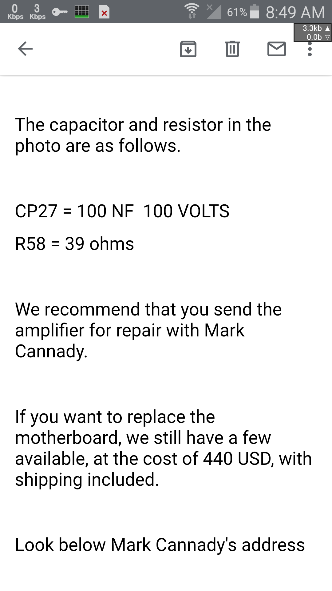

I shot them an email with it being the weekend and all it looks like I gotta wait. Well I hope that they can help me, I've never had to deal with their service so we'll see what happens. I also had a feeling from the beginning that it wasn't something I did, I'll be the first to admit if I don't know something or did something wrong, and with this being my first "real" system my biggest worry was blowing the amp so the very short time I did get to hear it I was all eyes on my volt/clip meters. Not to say it isn't my fault but I'm highly suspect of that.
If they reply and don't have a good answer, see if they will allow you to send it to barber02 with them paying him to make it right (if he wants the job).
That'd be nice, I know Mark is closer to me and that's who I was gonna send it to originally before I started to look into it.
Well I got an answer on the values of those components for anyone that was wondering and I got and answer on if they would repair it and that's a big no. The warranty seal part is a crock of **** though I linked them the ftc page about that, as for the installation and all that I did have it installed by one of their dealers so there's that. I guess I'm gonna have the local place do it and hope that it continues to work.
